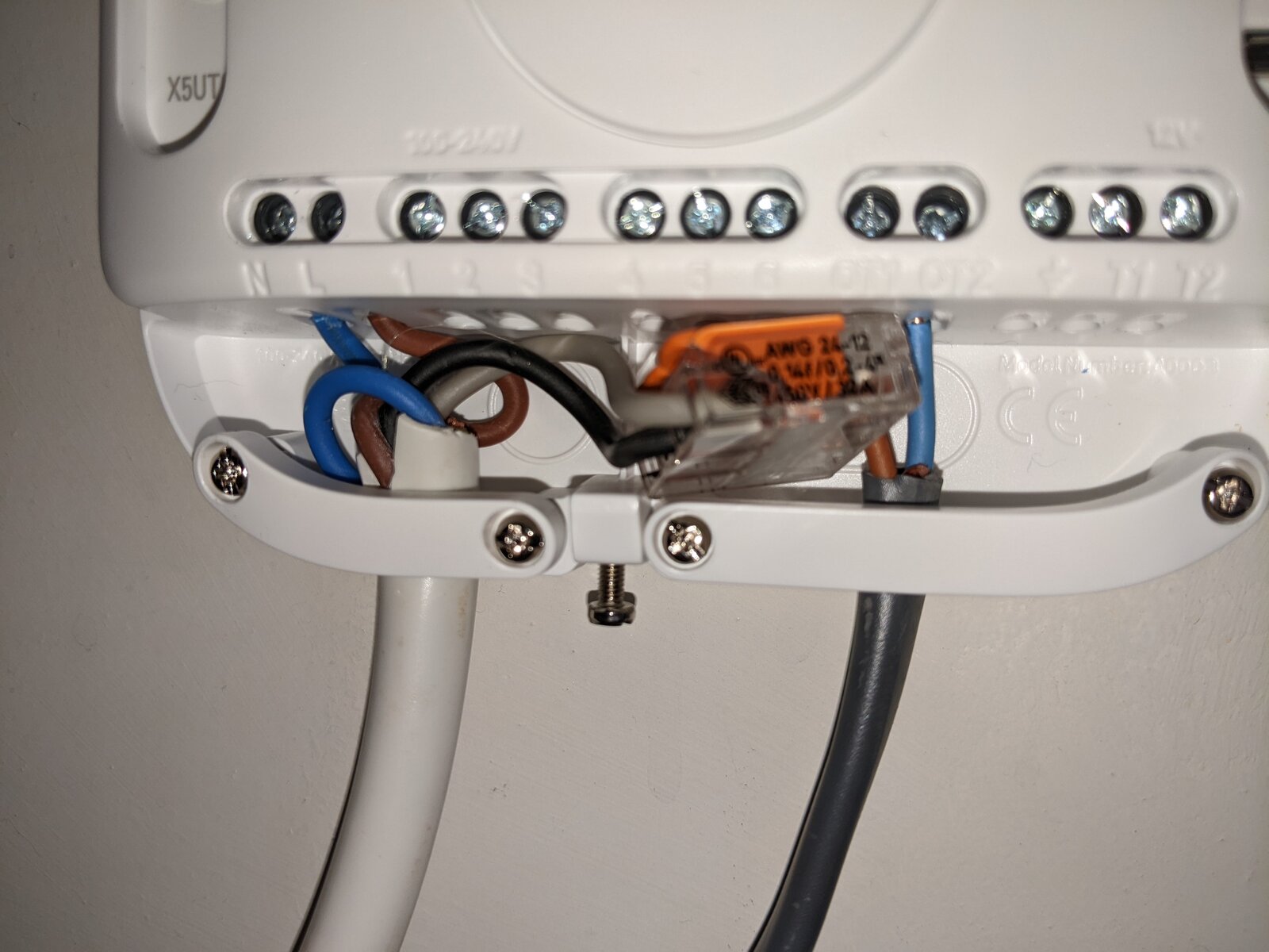

Nope, and now that you mention it the problem wasn't there when the boiler and heatlink were on but not yet set up. As soon as I got to the equipment stage of setup and confirmed the settings in my last post, the boiler kicked in to heat DHW.
I wonder if the issue is with the hot water side? The Nest might not be compatible with that side of it? Are you able to setup as heating only?
The DHW settings are fairly limited with the Nest in combi mode. Perhaps I need to have a play around in system boiler mode? I think the settings open up a bit then.
Okay, I had a play around with the settings. Selecting either "other" or "system" boiler, then "not connected" for the hot water seems to solve the problem. The boiler is now in charge of the DHW temperature via the dial on the front, and the boiler hasn't fired up randomly to heat DHW.
Is there any difference between combi, system or other when it comes to the central heating (set to OpenTherm)?
Also, does this wiring look okay? I had to bend the live and neutral wires more than I'd like to get the cable into the clamp (the connector contains the old switch wire).
Many thanks again for all your help!
