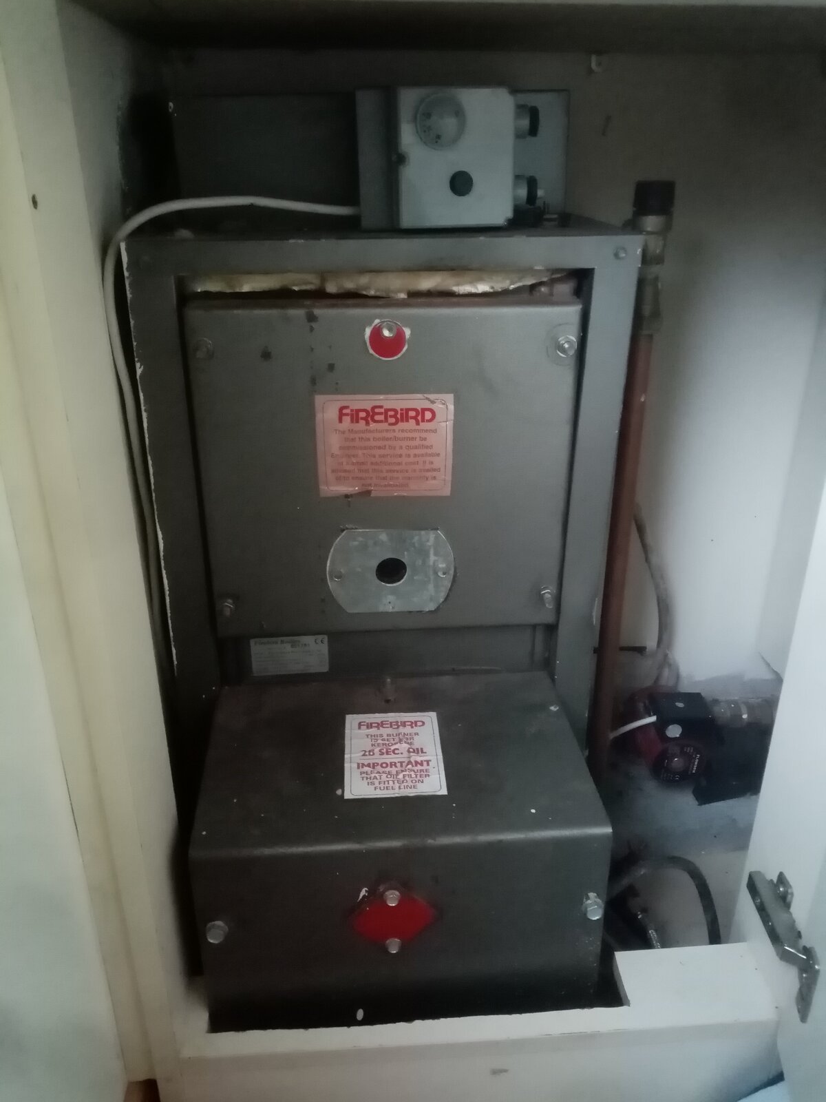

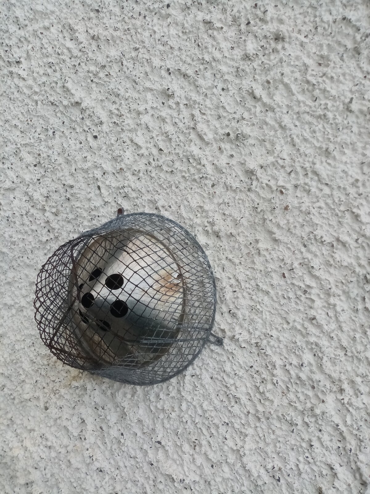

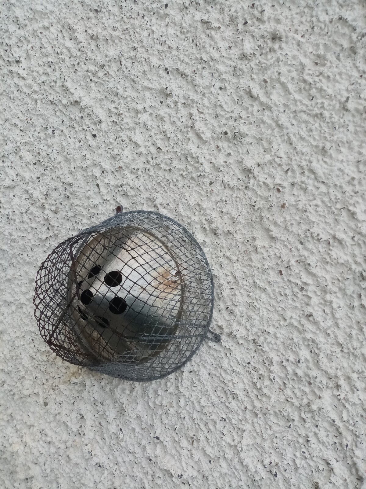

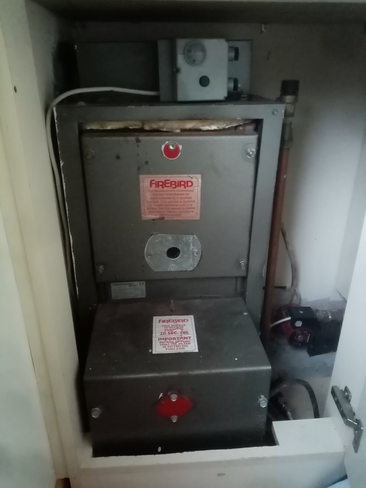

It's usually a humming sound, like air is circulating fast if that makes sense. I have attached photos of where this sound usually comes from.

I assumed from the opening post , all this timer did was turn an immersion heater, in a water tank, on/off not actually control a full Oil Fired Central Heating & Water system, I suspect you are hearing the CH Pump, or boiler firing up.

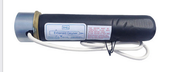

Immersion heater Labelled "(A)"

An immersion heater is an electrical device.

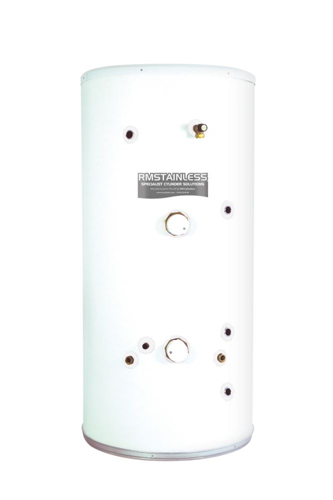

I think you are talking about the hot-water cylinder. Or possibly a boiler.
A hot water cylinder can be heated by a boiler and/or by an immersion heater inside it.

immersion heater

examples of hot-water cylinders

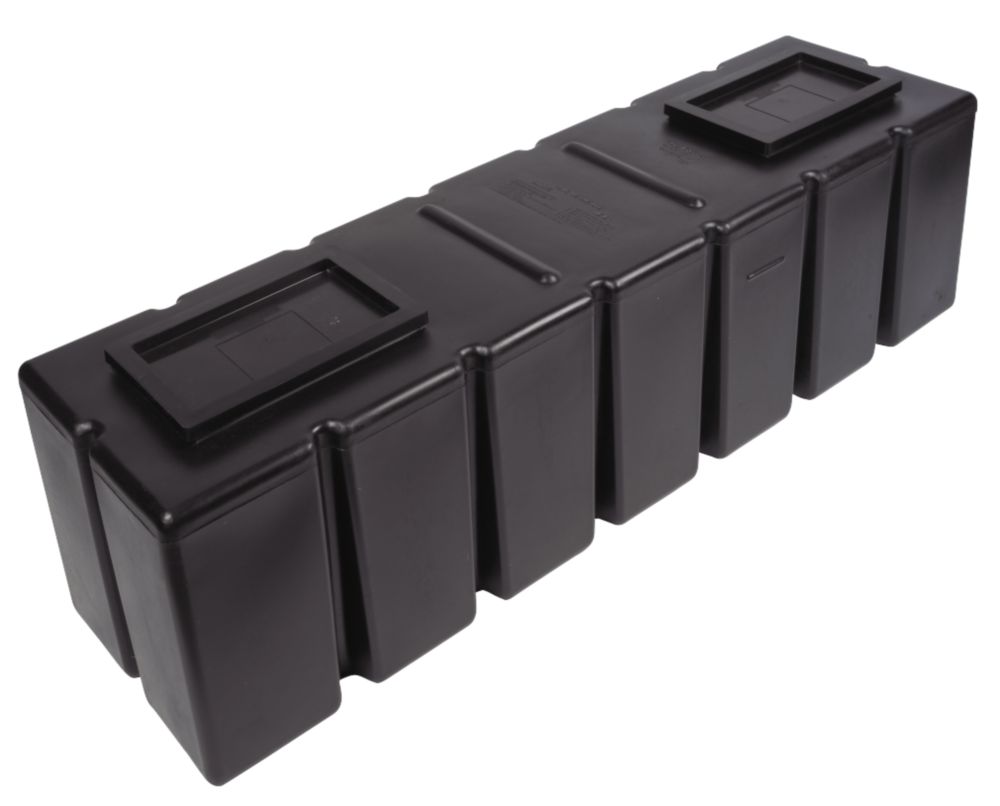

example of cold-water tank
It's like that one yes. Pardon my ignorance.

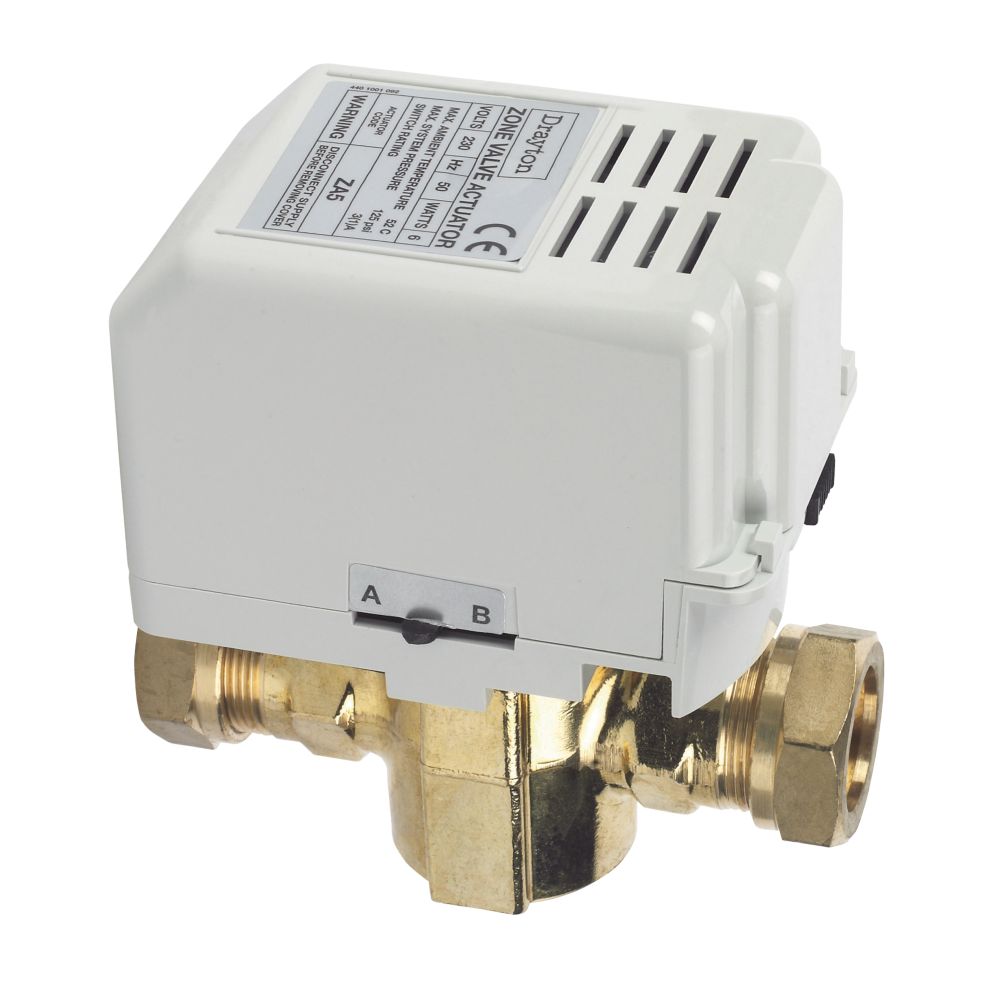

In the winter I can turn my domestic hot water heating off, it heats up anyway. The question is really what has gone wrong. We have to remember it is Ireland and you may have systems we are unaware of, but in mainland UK we use the Honeywell Plans. S, W, Y, and C.
We get two port
32455_P
and three port
81844_P
valves S uses in the main 2 x 2 port W and Y uses 3 port, and C often non but some times a 2 port is used. In this
8982G_P
one you can see the manual operating lever and often you can latch the lever open. So it should be simple to find out if the valve at fault.
But as it stands we are guessing, pictures are always good.
