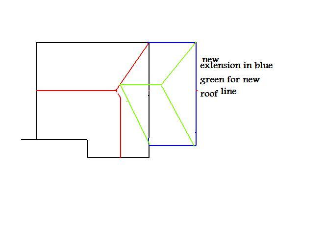

Hi everyone,
I have built an extension and will be at wallplate next week, now my next job will be the roof construction,
the issue is that the extension roof has to match the existing roof at the back and then the ridge will be lower than the existing.
The front of the roof will then have to be a lower pitch than the rear? this is because the ridge due to matching the roof with the back will be off center over the new extension... i have mocked up a line drawing to show what i mean.
would this be a problem or is it ok to have one side at a different angle than the other?
any help advice will be apprieciated.
thanks
jsmithy.

Why can't you continue the existing ridge, that would mean slightly longer jack rafters at one side and look much better. I think that the hip may be in twist if one side is longer than the other and it will be a pig of a job to have different cuts on each side of the rafter to hip joint.

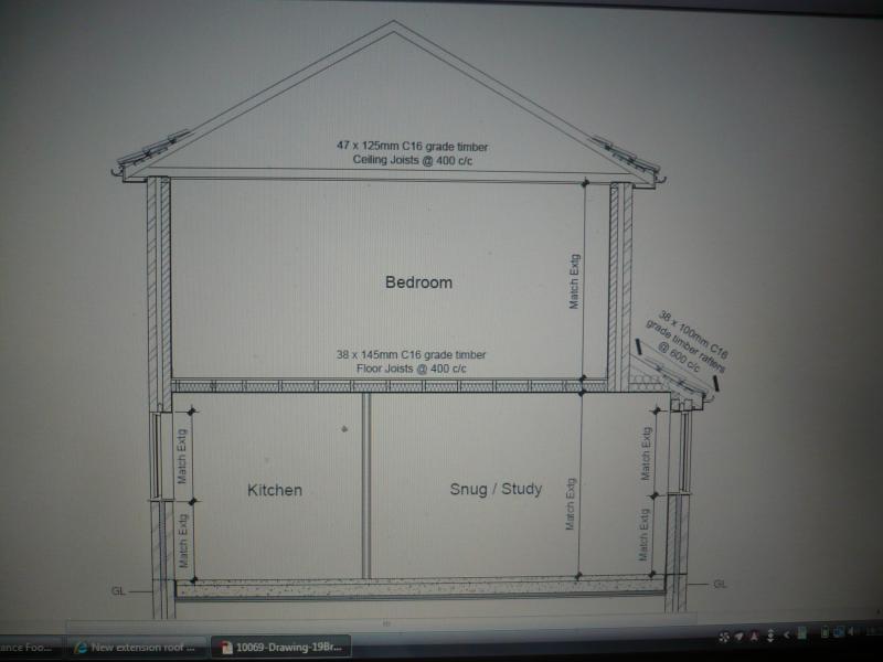

If he has drawn the plans so that it looks right, then are the timber sizes now correct, and are all the bracing and supports adequate for a lopsided roof?
Hi woody,
The plans didnt state anything other than the spars being 100 x 50 mm,
When i had the plans done and submitted i should have seen this problem as the extension is slightly wider than the main width of the house, and with the roof running into and matching at the rear and the ridge being lower then the new roof could not have ever matched the pitch at the back and front,

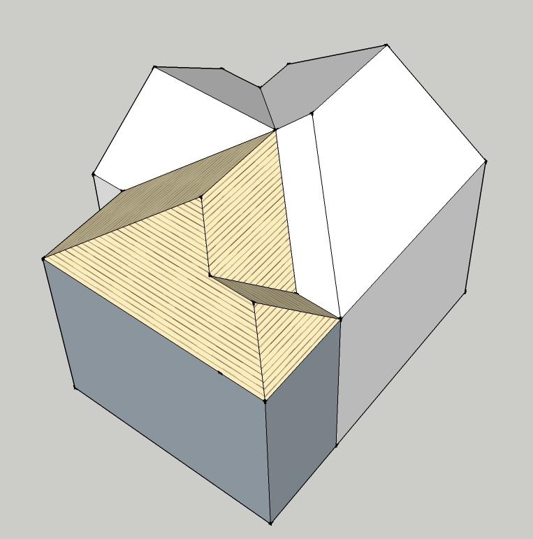

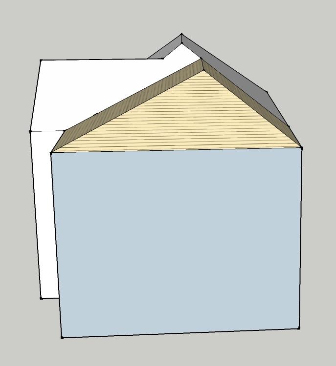

Here is what it will look like. The front lower pitch will be more noticeable by the time the tiles are on
If you can keep the ridge the same as the main house then that might be OK and not look too bad
But I assume that the ridge has been kept lower to conform to a planning policy? If so you would normally keep all pitches the same and hips at 45° and hide the difference with a gable or hipped gable.
If you move the extension ridge to the front and line it with the existing front gable ridge, then it looks like some thought has gone into it
woody your rendering is better than mine:)

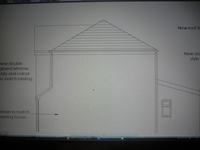

ive added the actual plans the front will be lower but if i can match the ridge then it wont look as bad as your image sugests? what do you think?
thanks.
edit The second renderind with the small hip at the back does look better,
although more work.
With a look a the plans do you think it would be do-able whilst looking asthetically 'ok' thanks again.
OP; you can't do a hipped roof with the hips of different lengths. This
is because the rafters will then be at a different slope on each face, and it will cause you problems with lining up the fascia boards.
In plan, the hips should be at 45 degrees.
Woody's last sketch seems a logical solution.
i agree woodys is a logical and good solution, only i was hoping i could get around this with a typical hip roof only with different degrees of fall on each side,

Were those plans drawn by an eleven-year old? The cross-section looks particularly amateurish.
no mate i seem to have been taken for a bit of a divvy,
the firm was nice to deal with and seemed very rpoffesional but mabye i should have asked more q's and made sure everything was done so it would work not just look like it would!
