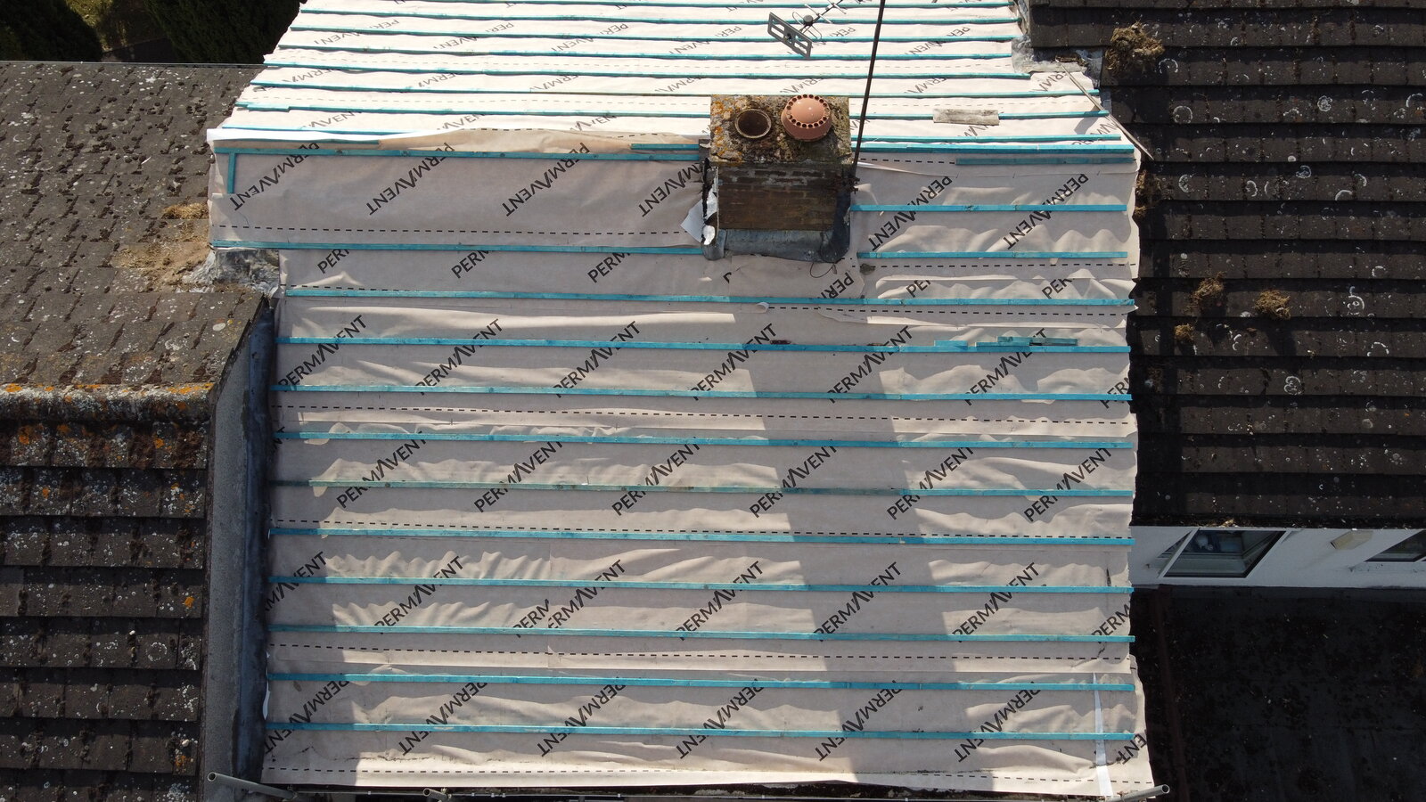

New roof just done (is this a bodged job?)
ask them to correct the issues first.
how did you pay?
bank transfer
I mentioned the tile gauge issue and he explained it was due to the size of tile I had chosen! (I didn’t have too much knowledge to reply, but I do now)
Looks like a Marley modern in the pictures .
The roofer controlled the gauge.
With in Marley recommendations .
I would insist it's all corrected .

it needs stripped and done properly.
Doubt they are capable, unfortunately you have to give them the opportunity to rectify.

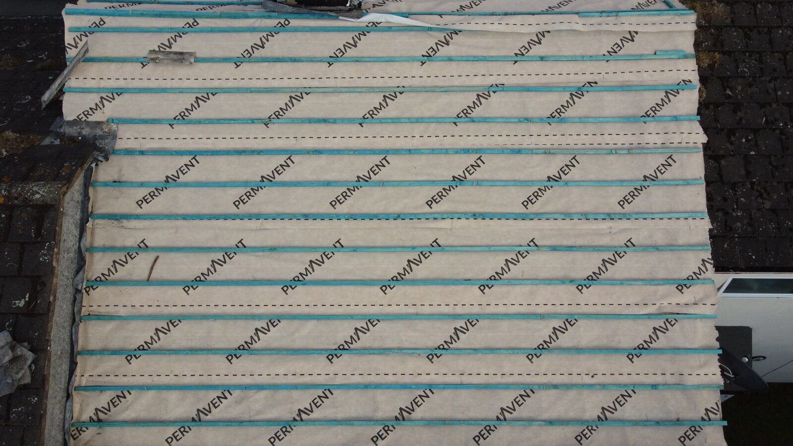

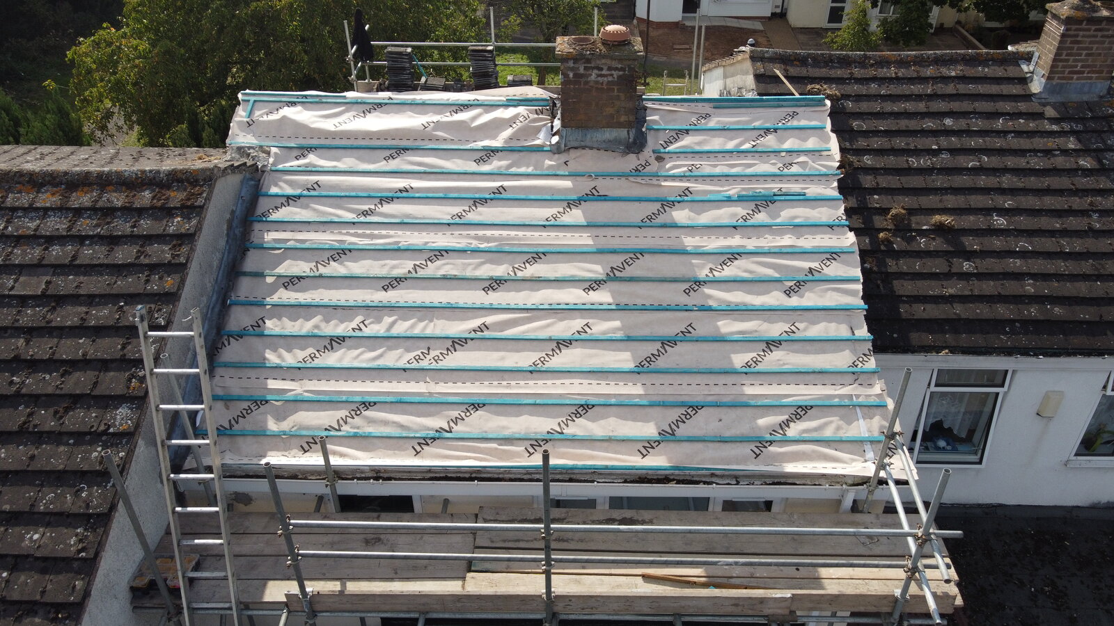

What should I reasonably expect them to do?
Remove all the tiles and do a half bonded pattern or just rectify the tile gauge on one side?
Would this involve moving all the battens slightly higher? Can the felt be reused?
You could get the Marley rep out for comment. I don't suppose the firm registered for the Marley warranty, but you'll get a formal opinion which the roofer should abide to.
Otherwise you'll need to pay for a professional report, and consider legal action.
The thing to remember is that a new roof should have about 60 years life, and parts of yours will have life in single figures - months for that verge. And you won't ever get the roofing firm back, and that's if they are still around.

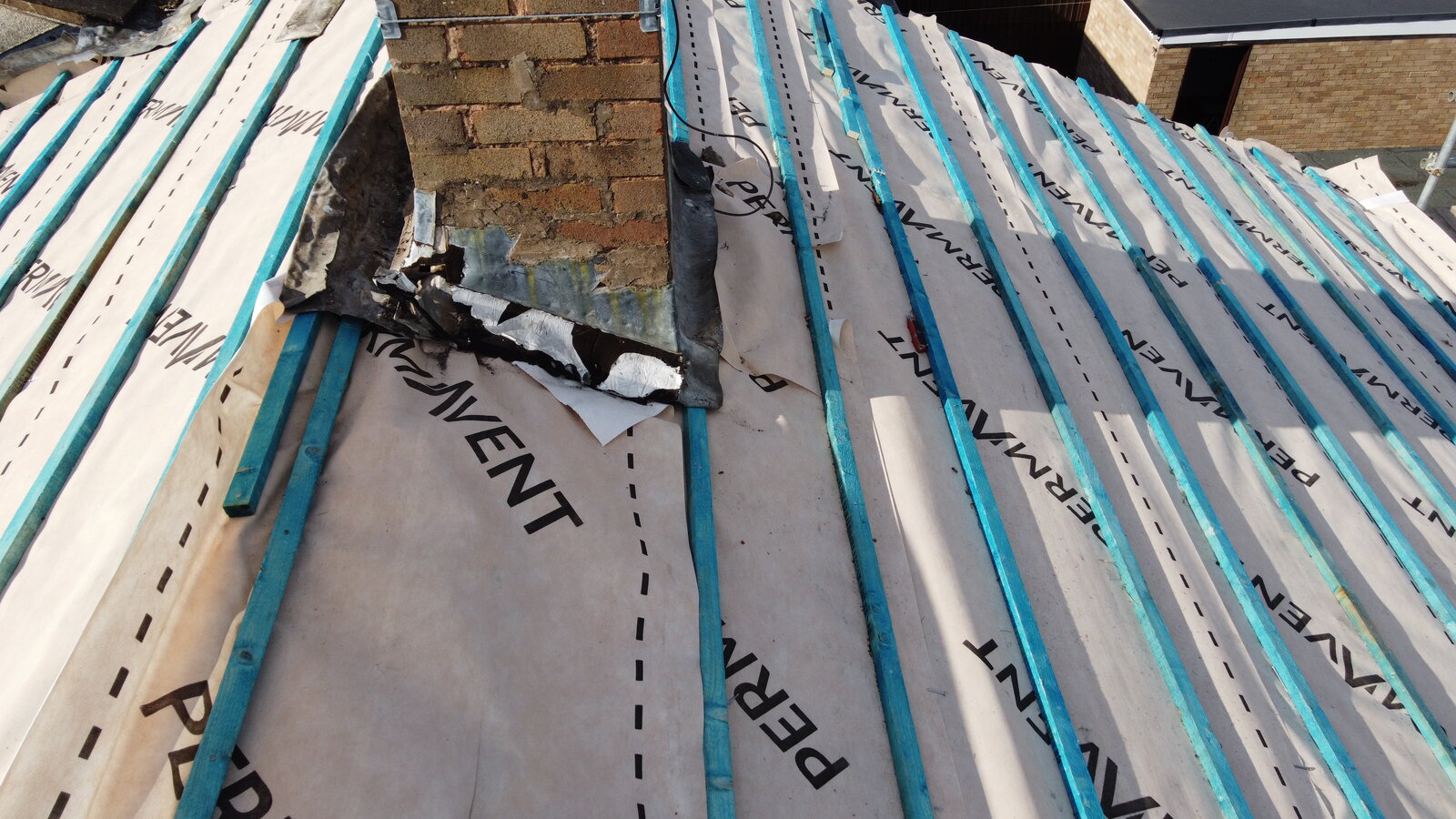

Strip the whole roof, renew the membrane, set out the roof to the proper gauge, renew the lead around chimney.
As it stands the job they have done is not fit for purpose! They are masquerading as roofers.

Why does the membrane need to be replaced? Is it because by moving the battens they would leave the nail holes in it? If so, wouldn’t it be best to double up/add new battens where needed for the correct gauge?
It might work out that the batten can stay. The correct gauge batten might miss theirs.
That way the underlay could stay.. if it has been correctly fitted is
While we’re at it, I have pictures of that stage as well
