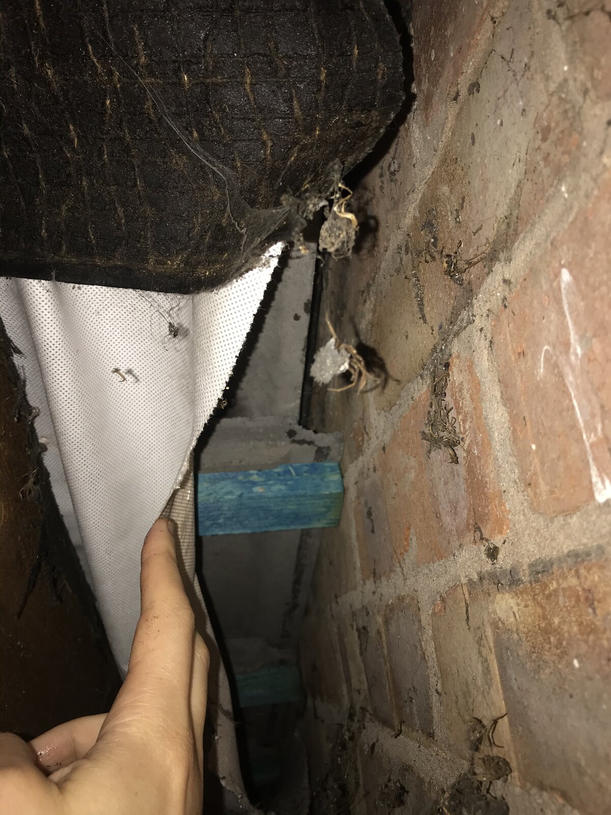

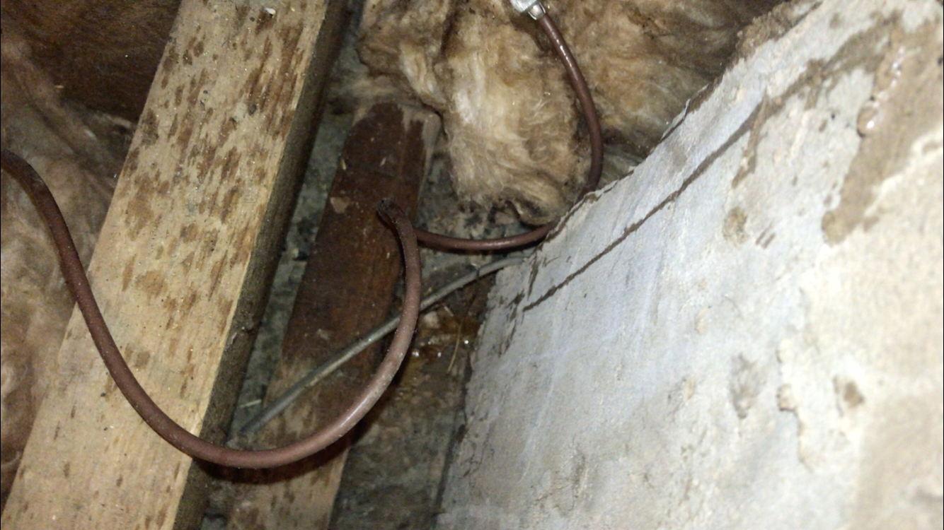

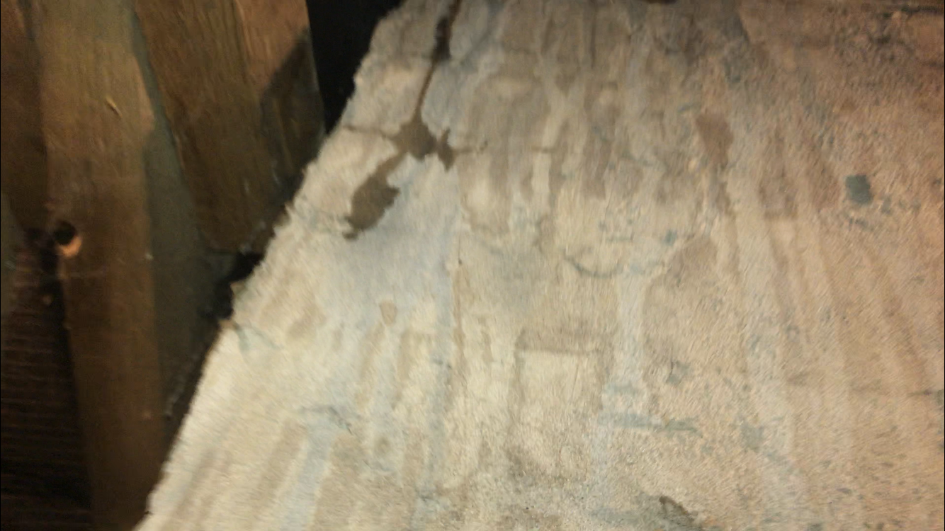

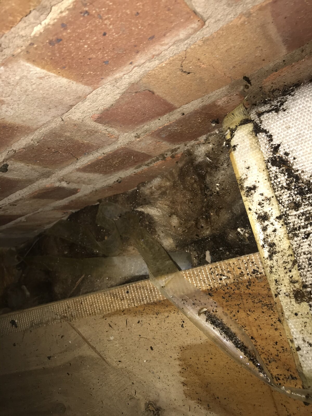

Second day of rain and the loft is already getting wet!
not only around the chimney, it’s now leaking next to the party wall, is the membrane supposed to be hanging like this?
no the underlay should be turned up at all abutments . That said tiles should keep the rain out.... call them back
