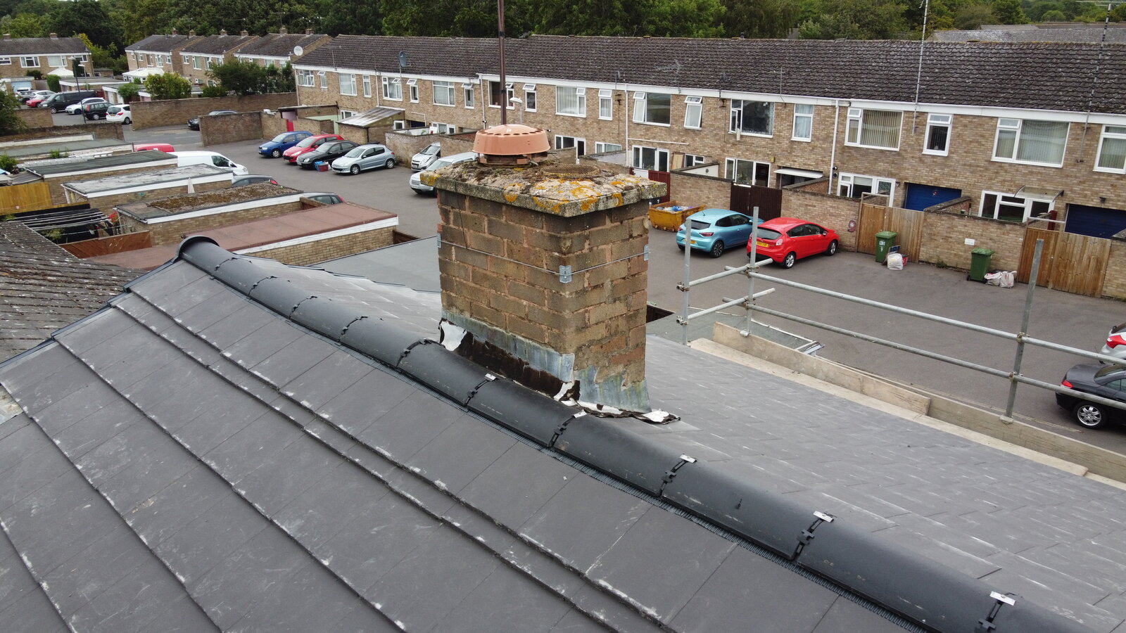

New roof just done (is this a bodged job?)

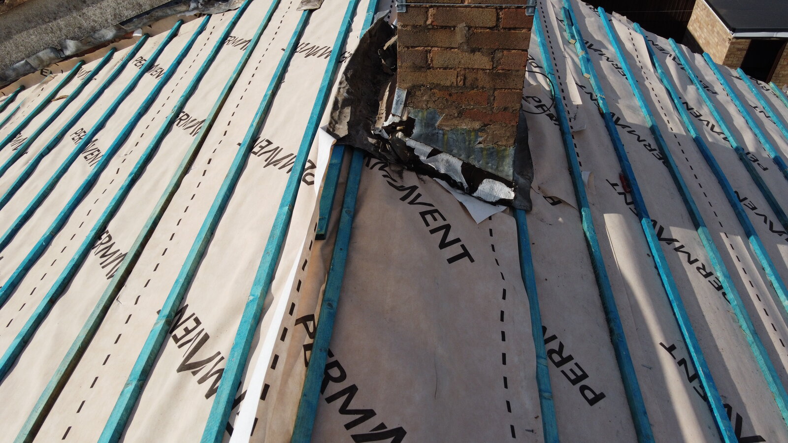

I just need to understand how the chimney flashing should be done so that I have a strong argument

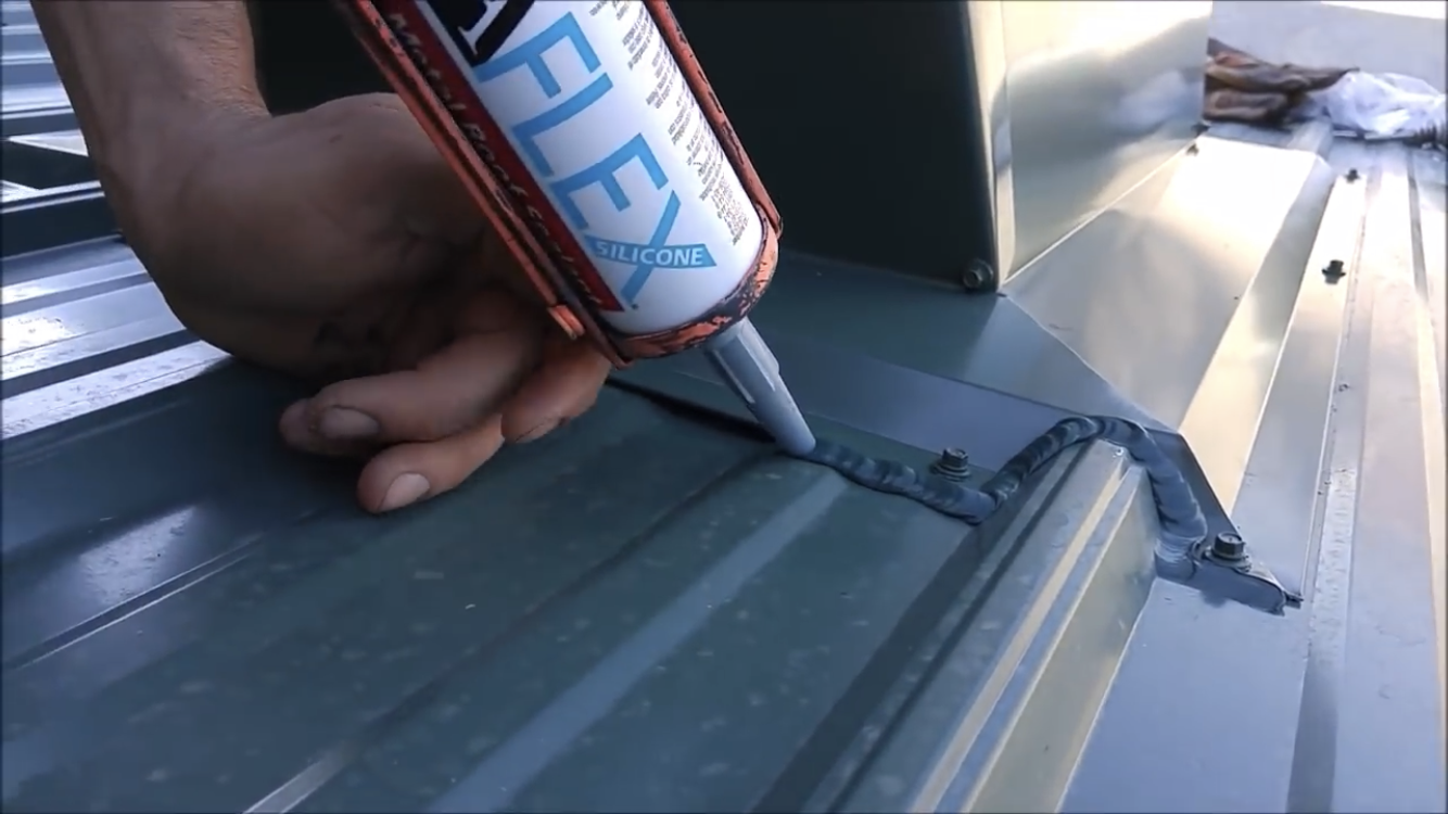

How are you supposed to stop water getting between tiles and flashing, if the flashing is above the tiles, especially on the top part of the chimney?
I was looking at this video (I know it’s not a tiled roof but it gives the idea of what I mean) and this guy is caulking between the roof and the flashing
How should this be handled on tiled roofs?
On your chimney the back gutter should extend under the ridge tile as well as being 300mm wider than the chimney. The side flashings should also cover at least 150mm of tile. Google Calder Lead Flashing, its a useful pdf showing how it should be done. No sealant necessary between lead and tiles/slates, done right gravity does the work
ah, I see what you mean, my chimney is close enough to the ridge so the lead goes below the ridge tile, makes sense

Update, the owner of the firm has come to have a look and has agreed it needs to be-redone; he’s also said he sacked the guy who was in charge of the job
They shoud be back in 10 days, fingers crossed
