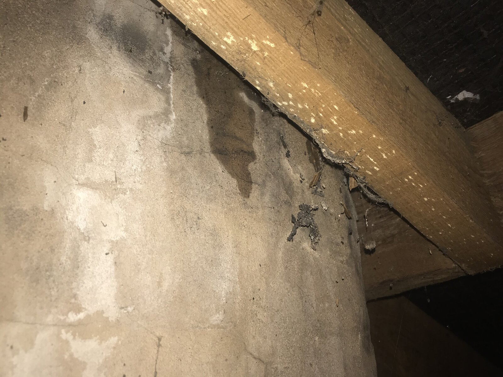

New roof just done (is this a bodged job?)
Ladies and gentlemen, after a very light rain this afternoon...

I'm sorry you've got that problem.
Flashband will not seal against a brickwork face very well and that is where water comes in. Wind drives the rain against the brickwork across the whole face of the chimney and it will run down, finding any gaps.
It wouldn't have been so bad if they had lifted the lead work and tucked it underneath.
That is why true lead flashing is chased in.
Flashband is a very useful product, but it's use is really for diy leaks. It is not suitable at all for an exposed location that needs real lead flashing.

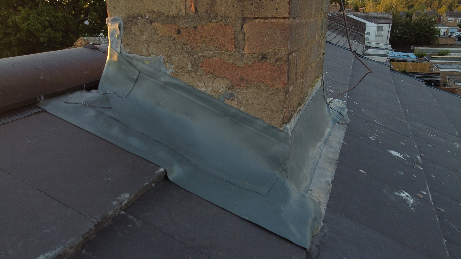

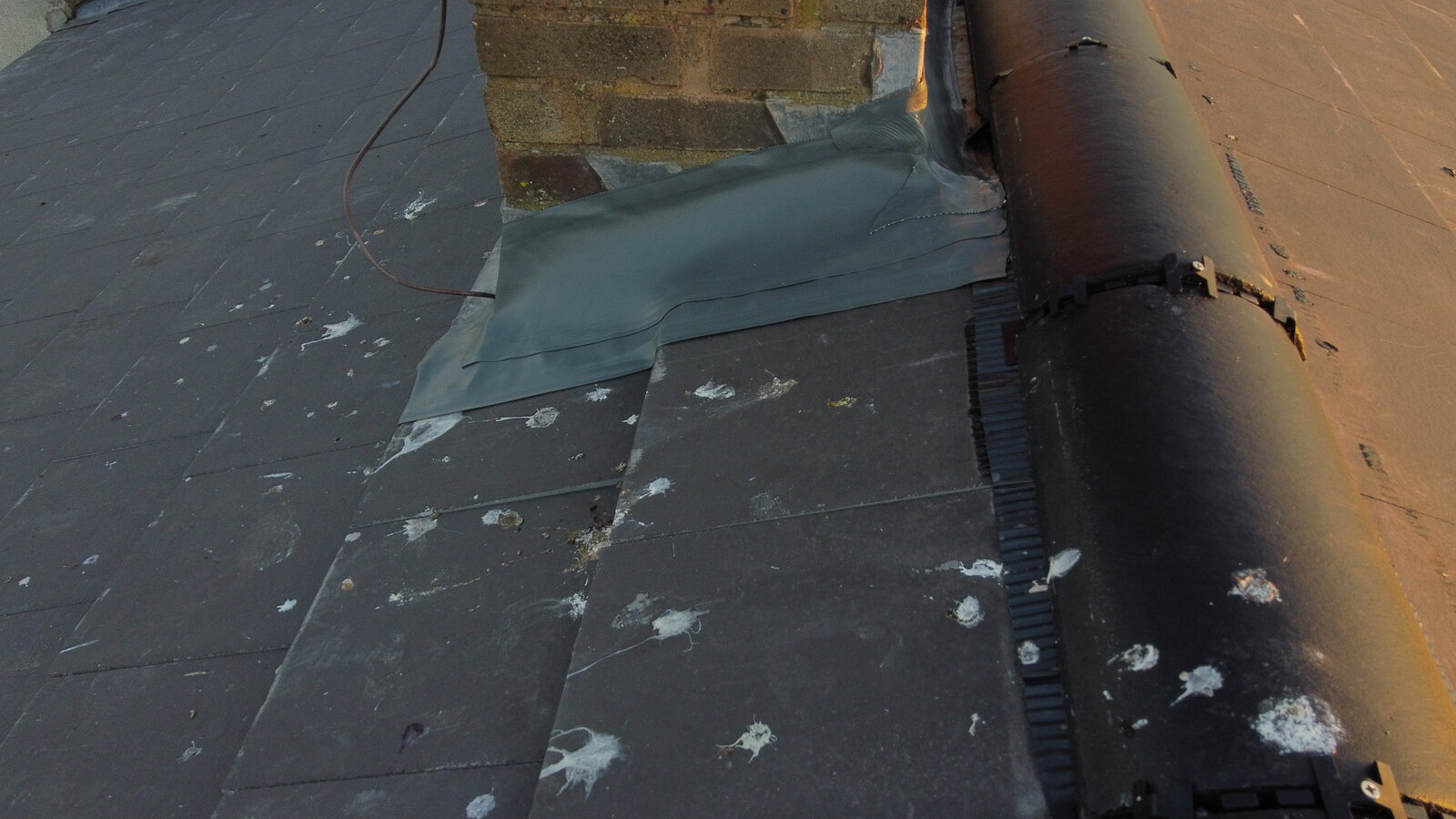

He's going to send someone to replace the lead around the chimney (someone not involved in the original reroofing); I am not sure he's going to use real lead or an alternative, which I've read are easier to fit than lead, so in theory I should be less worried about that... any reason why I should expect real lead to be fitted? Any opinion on the durability of the alternatives?

This is the thing they have fitted today, which should stop all my leaks... please don’t be dramatic unless it’s worth a drama
To me, that's still a bodge and I wouldn't accept that on my house, ever.
Can't quite tell, but in the 2nd photo, looks like a trough behind the chimney and ridge?
looks like wakaflex which is a good lead alternative.. Application in this case is a mess, i would not accept it
