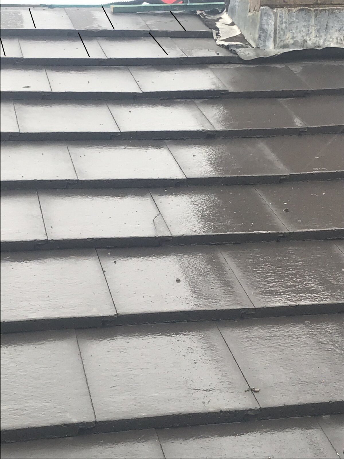

They are redoing it again today, they agreed to do a half bonded pattern; however, near the chimney they've broken the pattern; they said it's fine like that....
Am I being picky if I ask them to keep the same pattern all around?
I've drawn how the tiles should have been laid in my opinion
busted tile, and they are still not half bonded properly... better though
yes, I guess the last tile wasn’t exactly a half tile, so they just moved it to the other side every other row; I already discussed the broken tiles, they were already going to replace them
Its the easiest of roofs to do properly, a 1st year apprentice would get it right first time.
Not helpful I know but they are not roofers, these people give the trade a bad name.

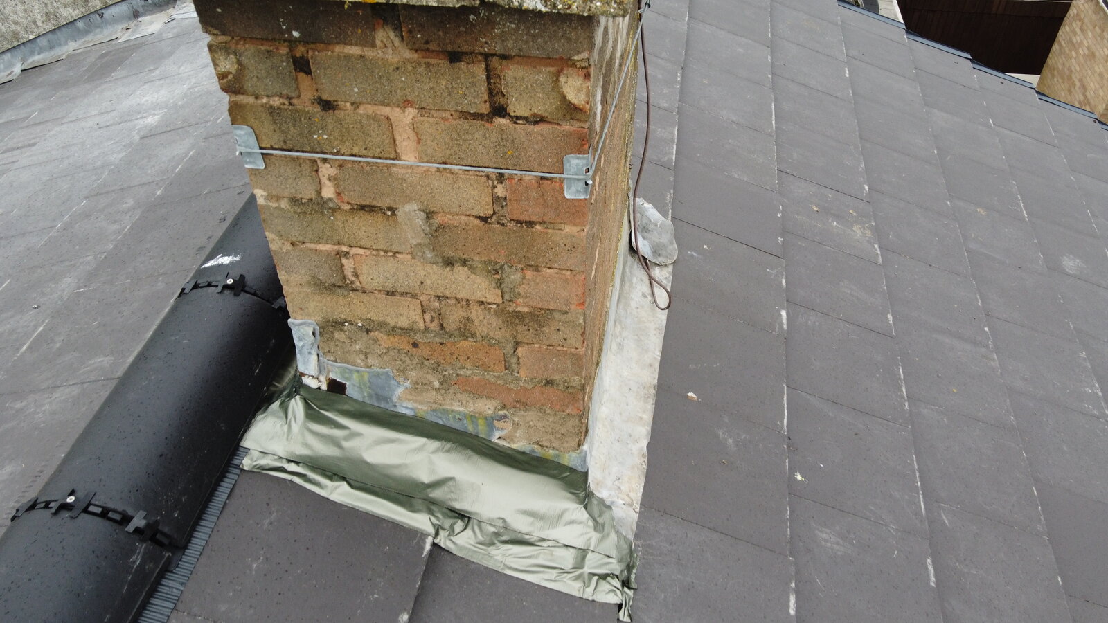

This time they seem to have put some tape (?) on top of the chimney lead

It's a bodge. I suspect the "roofers" can't do lead work.
they said they would leave the original lead in place as they said multiple times it was in good condition
is it possible they damaged it with all the times they had to remove tiles and put them back?
