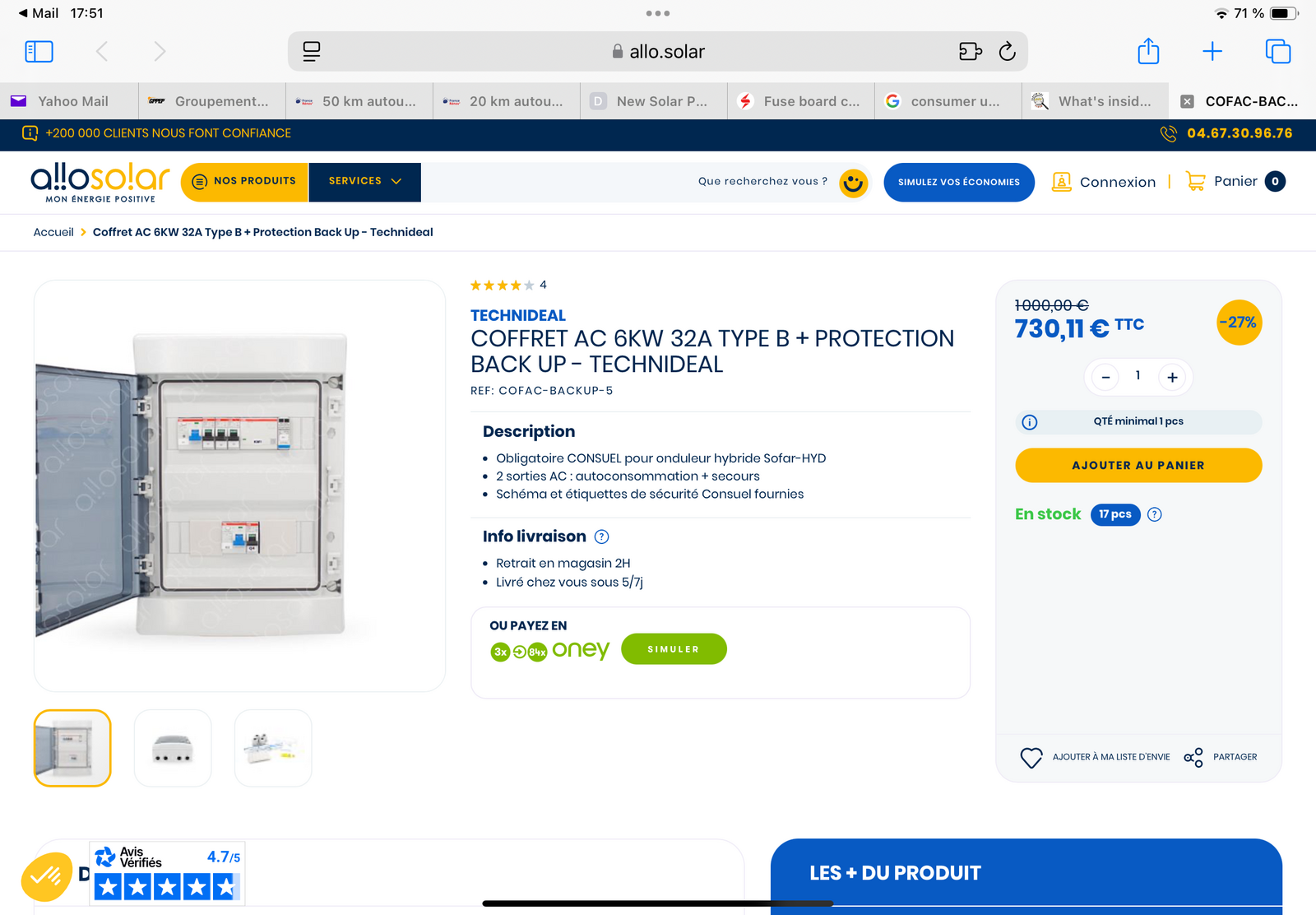

Hi…newbie here….what a great site…shame it wasn’t around 30 years ago! Regarding the tails from the inverter to the consumer unit…I’m having a AC unit between the inverter and my consumer unit…it will facilitate the inverter powering the house even when I have a power cut from the grid…But I have a question if I may…can the tails going into the consumer unit go straight into the main switch rather than a MCB…same difference, no?

No, it doesn't work like that. The inverter shuts down in a power cut. You might be able to get an inverter with a standby emergency outlet. You must not connect it to a grid circuit.
Hi John…a company here called Allo.Solar advised this, I had a choice between 2 AC units, one would not power the house in a power cut the other would…what can I say….
You must not allow your inverter to supply power to the grid during a power cut. There are various ways to achieve that. Some more expensive than others. Imagine a linesman sitting in a trench repairing the cable that comes out of your house.
I don't know what regulations you have in your country equivalent to the Electricity Act.
I will clarify this with Allo.Solar and get back to you…I get what your saying…thanks…

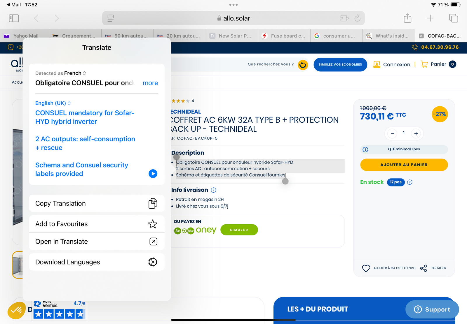

Does this help…

It looks to me like it has some stand-by emergency outlets, which you could plug your boiler or your dialysis machine into, that are not connected to your ordinary house circuits and therefore do not make your consumer unit live.
Quite useful if you are in an area prone to power cuts or if you have some essential equipment, but will not power your house.

This may clarify things about the AC unit, here’s the blurb on the site….
In the event of a power failure, the batteries integrated into your photovoltaic installation take over and provide emergency power to your home. This feature is similar to that of a dedicated backup power line, and ensures vital energy continuity.
When a power failure is detected, the switching box safely disconnects the photovoltaic system from the power grid. This avoids energy returns, which can be dangerous. The switch box also provides backup power to your home from the battery park.
This ready-to-connect and pre-tested solution is easy to install and use. It allows you to benefit from a reliable and secure backup power supply in the event of a power failure.
I think you have a specific technical question which is best addressed to the supplier of the equipment or the person installing it.
