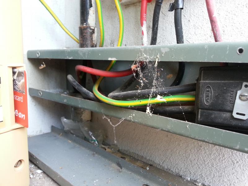

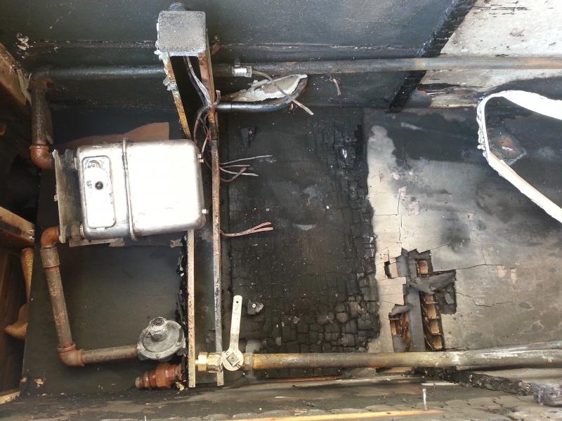

There are actually 2 properties involved here. The property i'm more concerned about is a 2 storey house which is on top of a single storey flat (1970's council estate). The front doors to the two properties are facing opposite directions and both have a bin/intake cupboard next to the front door. In the top cupboard (for the two storey house) there is a gas meter and an electric meter. The previous electrical supply comes up through the ground via metal conduit and is terminated into henley blocks inside metal trunking, then into the meter. Then out the consumers side of the meter to another bit of metal conduit and through a wall to the CU (about 1m away).
The downstairs bin/intake cupboard (outside the flat) is where the TNCS supply came into and where the new supply will be also. The only fuse protecting the cable was the one in the cutout.
This is the downstairs cupboard, the hanging cable below the gas meter is what was connected to the cutout. The conduit below the trunking on the right goes to the flat and the conduit that you can just see to the right end of the trunking goes to the house? above
This is just the trunking below the meter in the upstairs cupboard

I'm so confused.
Where is or will be the cutout for all this?
Are you running a cable from the cutout to the meter, or from the meter to the consumers installation?
The UKPN cutout will be in that burnt out cupboard once it is rebuilt. I am running a cable from the cutout to the meter.

I strongly suggest you clarify the requirements with the DNO - This would never happen in my area. I suggest the DNO are expecting the metering to be placed adjacent to their cutout.
So you have to run a cable from the cutout which is to be located in the burnt out cupboard, up to the meter in the flat above which is your second photo?
Have we got this right?
My DNO would never allow this either.
Neither would we (I).
As others have suggested confirm with the DNO exactly what the final intention is to be
So you have to run a cable from the cutout which is to be located in the burnt out cupboard, up to the meter in the flat above which is your second photo? Have we got this right?
