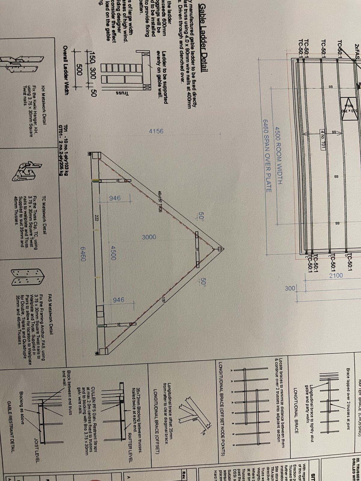

Don’t get what you mean a raised tie attick truss mate they are as the pic below just a normal triangle
And I will be propping the existing ceilings up inside so they can be walked on and a step ladder be put on so they can be unlashed ok

Does the two days include building up those gable ends? You will need a table lift and some very quick brickies.
50 degree pitch too, ouch. Make sure your chippies are over 9 feet tall.(y)
Balance the step ladder on what? You can't plank it because they will be in the way of the truss chords.
No that’s being bricked up after but I can put some tarp on the gables while it’s being done
What you mean a table lift mate
I’m gonna support the ceings from below with scaffold boards and acrows everywhere where the steps will be sitting above
The middle part will be ok as the old are going the same way as the new and the new ones miss where the old ones are I’m sure it will work it’s self out hopefully
And the crane company this is there main job lifting trusses and they said they can easyly do it hopefully they are right

How is a Hiab going to reach the furthest point of the building?
You have a diagonal bracing headache too. You either sheathe the whole interior with ply or deal with the 4"x 1" bracing timber thickness accordingly. Diagonal bracing must connect to the wall plate.
