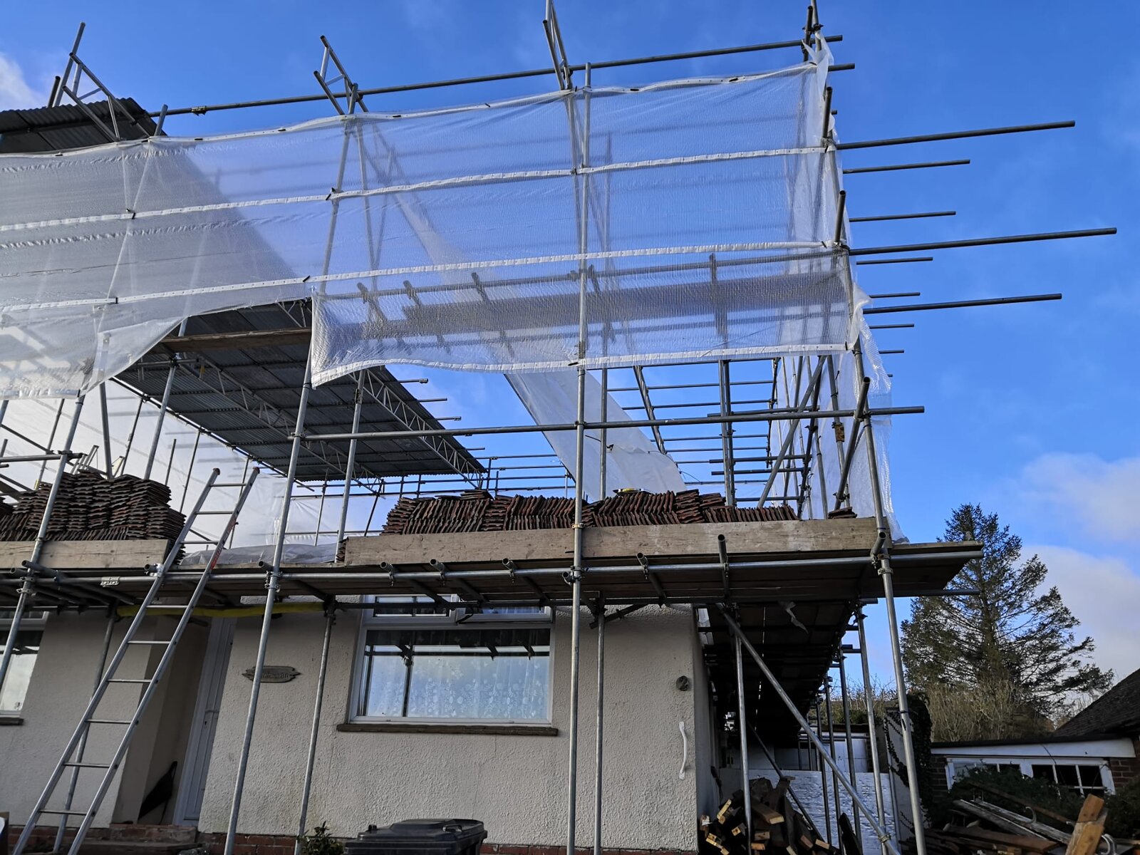

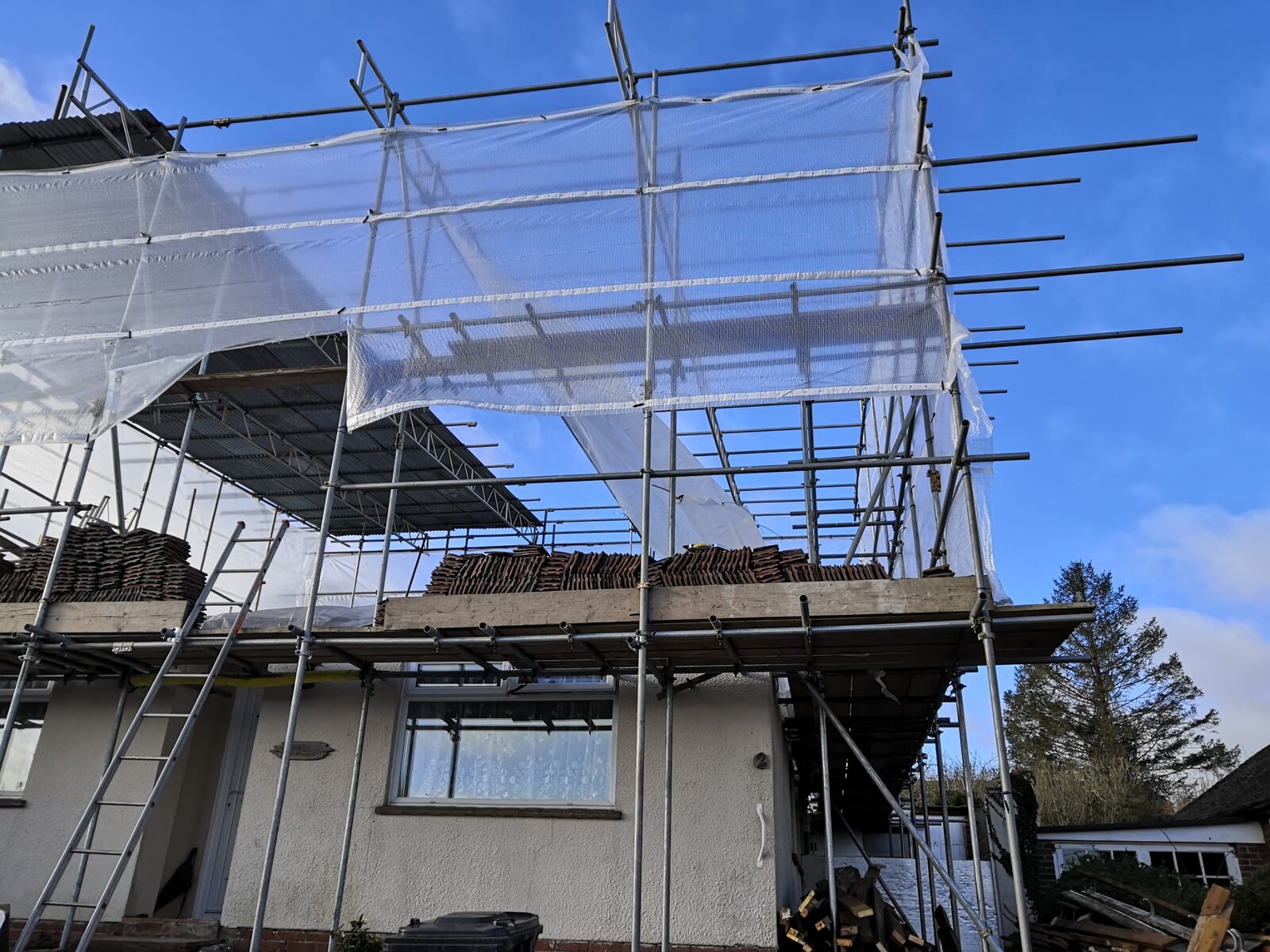

Its 5am crane arrives at 8am then the truss lorry. I'm worried about my extended plates we have the option to externally strap down as we are going to have some external insulation.
My scaffold went up just after Christmas.
My scaffold went up just after Christmas. View attachment 259662
Well having taking some of my roof off
My house has no straps at all on the original roof which is shocking as it’s only 15 years old
So looks like I got to add them now as well which means damaging all the bedroom walls

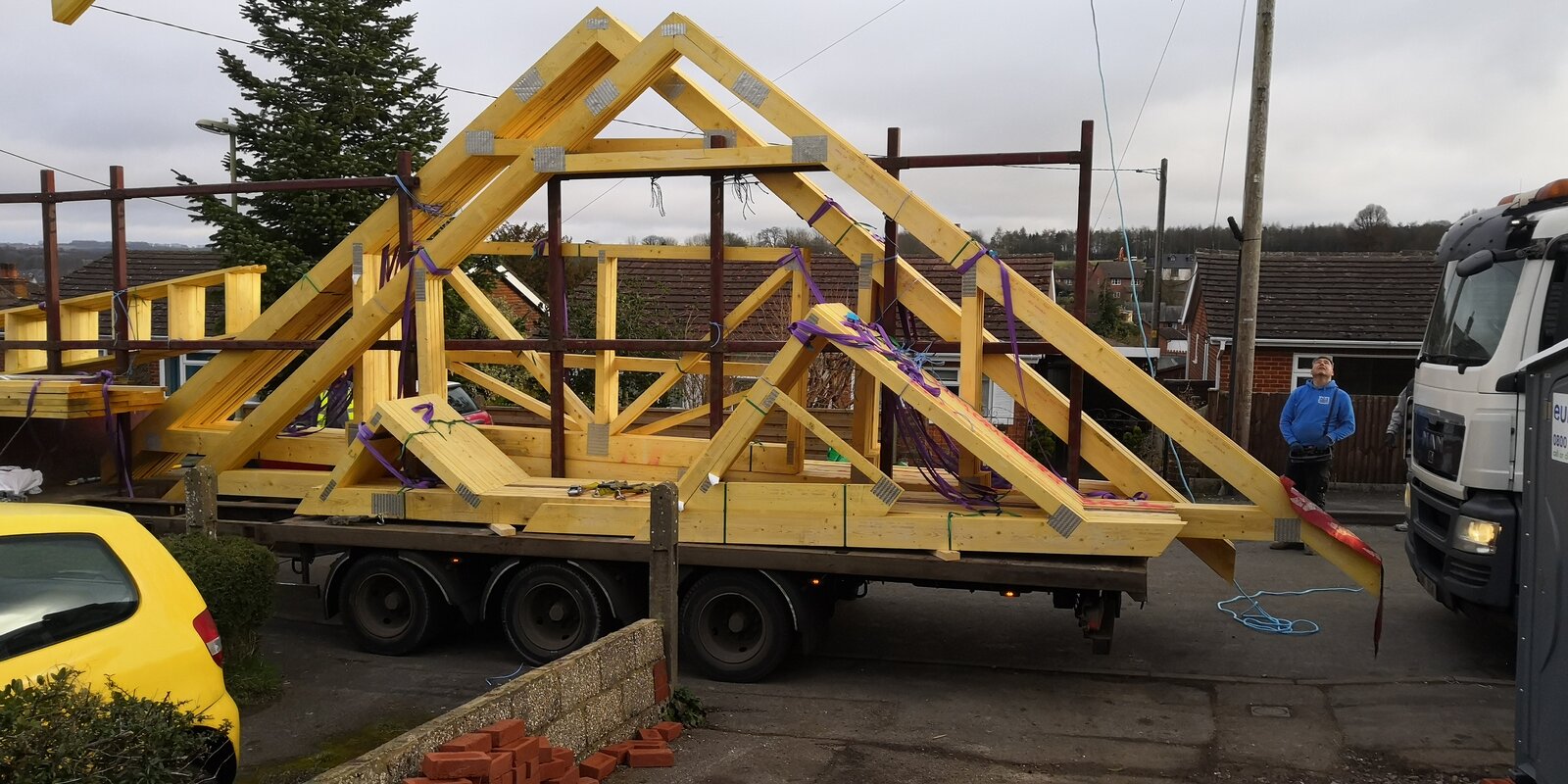

Stressful day. Artic took 6 attempts to get into road. Full on wheel spinning
3.65 mtrs all in
How long did you have the crane for
Mines comming on the 14th ish 4.2 meters tall
Got the crane for 4 hours but I have only 9 singles and 2 doubles to get up on the roof
The rest is cut on site

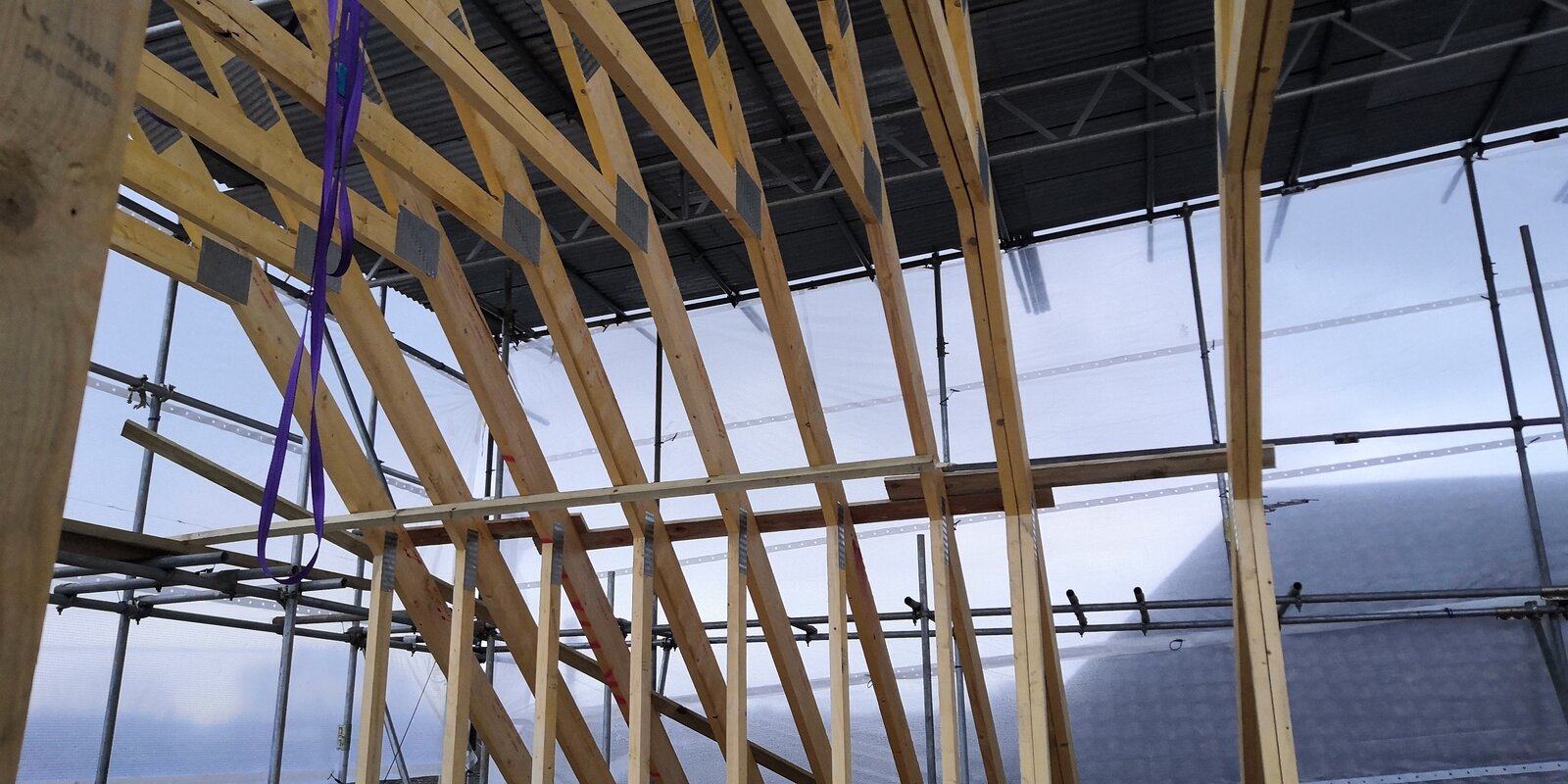

I have raised my wall plate by 75mm as to clear the old ceiling joists
Crane and delivery was here at 8am we had the truss lorry unloaded by 10am then had all trusses up by 1.30. Crane driver gave us a hand to place the first ten trusses by hand and he went about 3.30

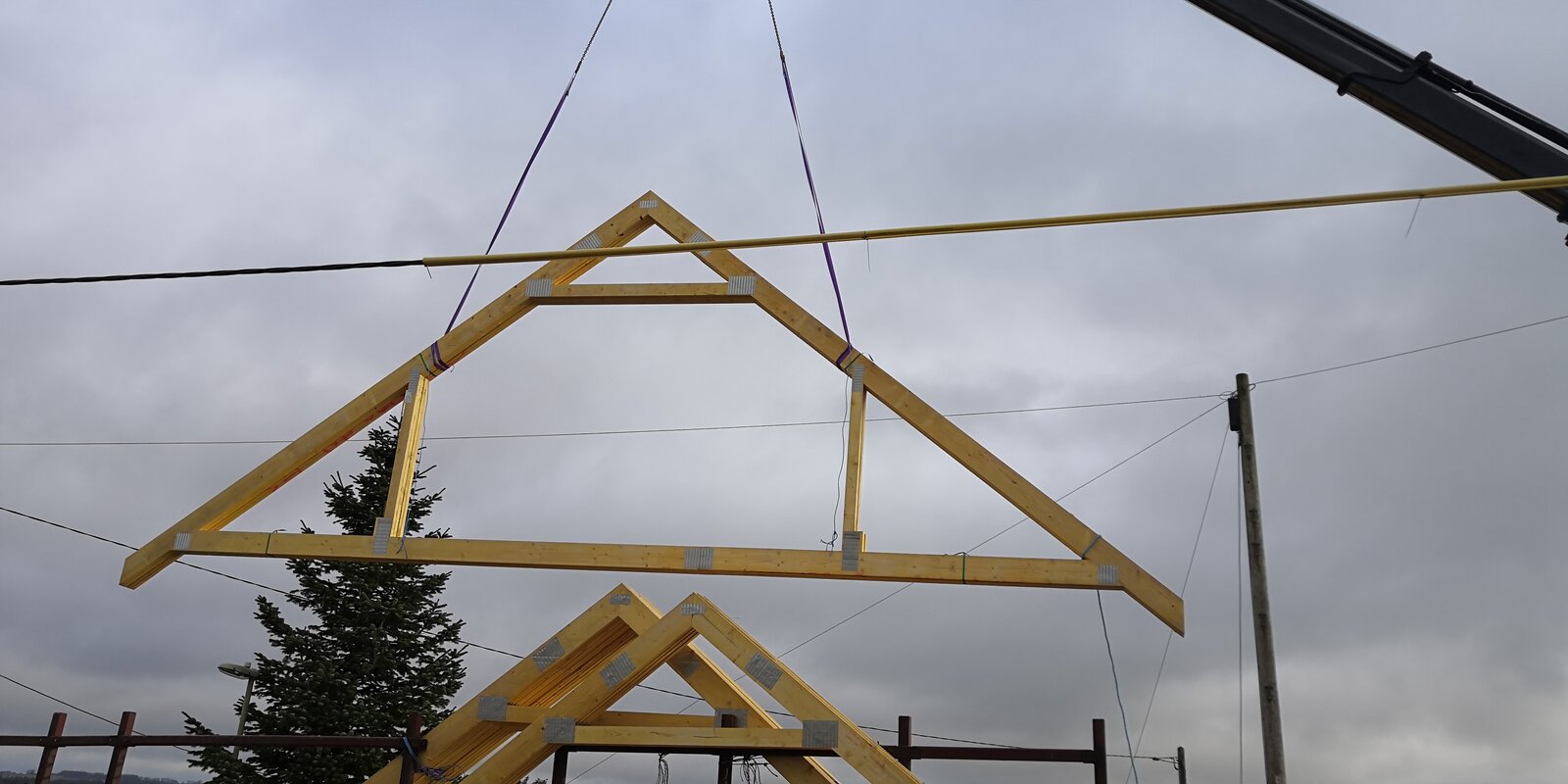

Our raised tie trusses were huge (8m wide!) and heavy. The triples weighed 270 odd kg's.
The crane driver was brilliant and had to negotiate overhead cables. On one of his return trips to load another truss he started lowering his chains. The chains brushed harmlessly passed an overhead cable as the chains descended. There was also a redundant hook with one of those safety clips attached. I watched in horror as the hook brushed passed the cable and then went..SNICK..as the overhead cable sprung into the hook.
Fook.
The cable was 6m in the air.
I got myself a long piece of batten with a piece of wood fixed at the top. I then had to get the crane driver to orientate the hook so that the pressure of the cable was trying to exit the hook. I then waggled my stick frantically trying to beat the hook clip to free the overhead cable. Thankfully it sprang free.
You don't need that added fun when hoisting up massive trusses in an enclosed space, especially when the sky is full of rain.

Well all in by 3
And covered up bloody weather
