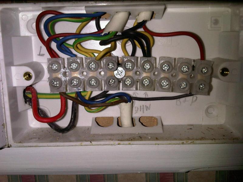

You learn something everyday. Never known a Open vented cylinder and system fitted with a 2 port and a 3port valve. The wiring would be interesting. Can someone explain the purpose? :eek:

I'll take a snap of what I think is the control box when I get a moment. The valves are in the attack so that's another story.

Come on op. Get busy with the camera.
There's lots of us here want to know what sort of SY Plan hybrid system you're running there.
lol I just got back from food shopping (really).
Hang on, I'll undo the box where all the wires go to. Hopefully it'll be what you are after.
