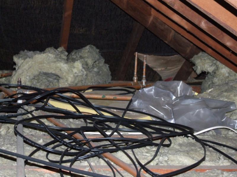

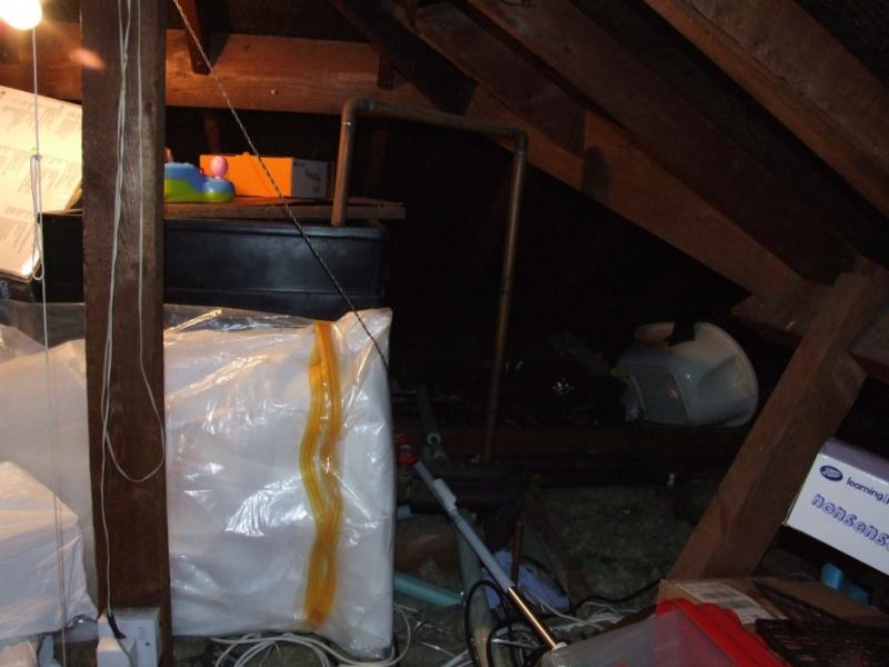

Valves and auto air vents
I seem to have many of these manual air vents. Is it worth changing them all to auto vents? Though why are there so many! I would need to do an additional 8 - 12 vents if I were to convert.

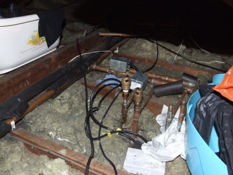

Valve 1
Valve 2

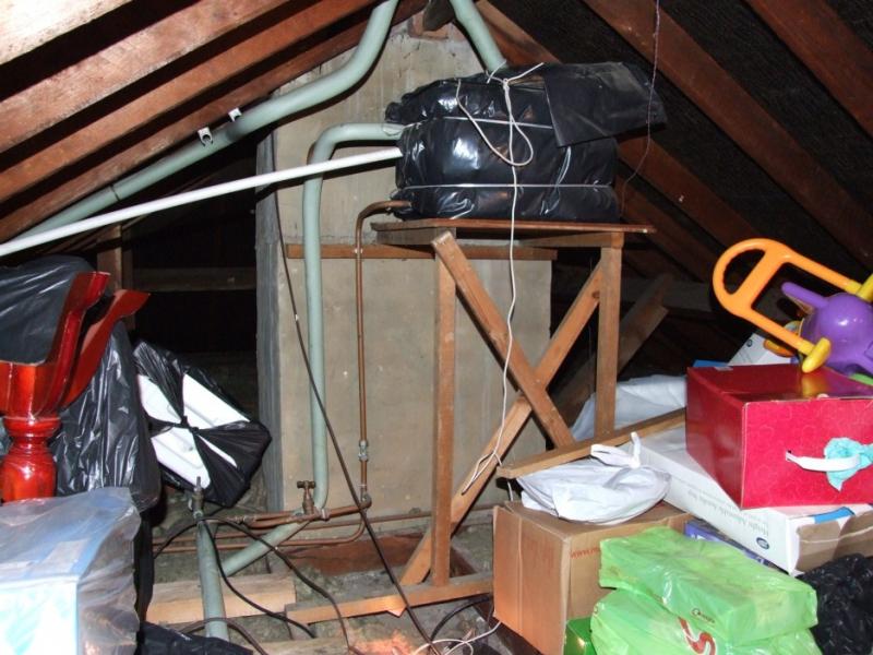

Storage Tank. Fed by a 15mm pipe. I'll look at upgrading it if I can find a 22mm source as it should fill it up quicker. Though I don't think I'll find one, if not I'll leave as is.
Storage Tank Size

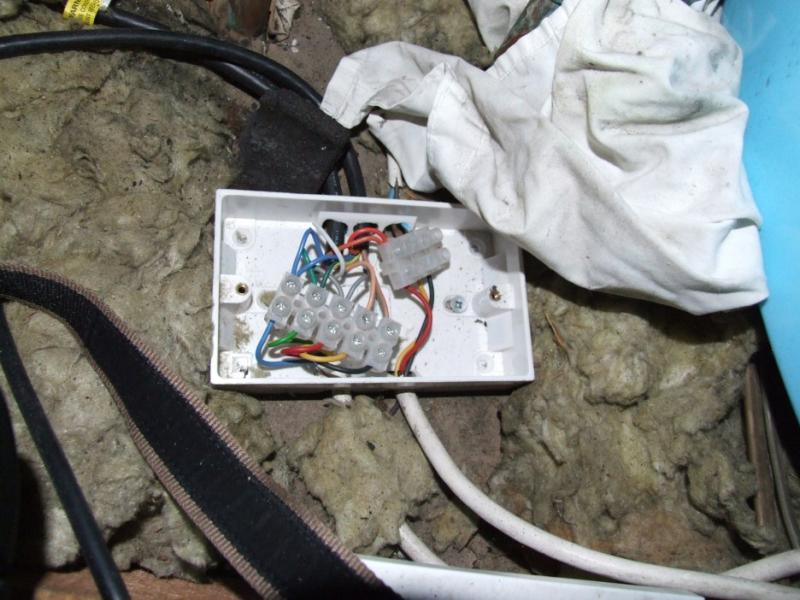

Valve wiring
Another shot of the storage tank

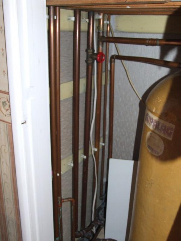

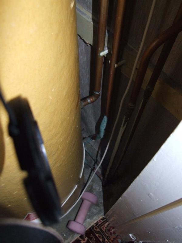

Cylinder + Immersion - Is it worth upgrading this also - any benefit?
Cylinder Connections

Not a hybrid at all. Plain Jane S Plan.
And leave the tank's pipe as 15mm. Won't make any difference.
And unless they were removed for the benefit of the 'photo shoot', some of those pipes in loft need some insulation.

Your system should have a bypass, preferably automatic, between the flow and return after boiler, now we have established it's S Plan.

Thanks for the advice on not upgrading the 15mm pipe to the tank.
Right at least I now know for sure its an S Plan.
Nope, those pipes don't have insulation. In fact the whole loft needs to be done as the depth isn’t quite enough... it’s on my list.
So this bypass what would it look like?
Lastly what are all those air vents about? Do I really need that many? There’s too many :(
Maybe not exciting, but S Plan is my preferred set-up.
The bypass maybe just a gate valve on a pipe linking F and R pipes, or one of these.

Being in the loft, your F and R pipes are the highest part of the system, and as such may collect air. Instad of this air lodging somewhere you wouldn't want it, these tails with their vents help trap the air.
I would leave them as they are. If you haven't bled them for a while, undo the caps until water comes out. Will need venting after a drain down, especially.

Must admit I haven't seen anything like that. I will have a closer look where the boiler is housed. Though as everything so far seems to be in order with the S Plan setup, albeit the bathroom rads turning on when the water is turned you would think/hope it was installed somewhere.

Great! I'll leave the air vents as is then, would have been a lot of work & unnecessary cost for very little gain.
