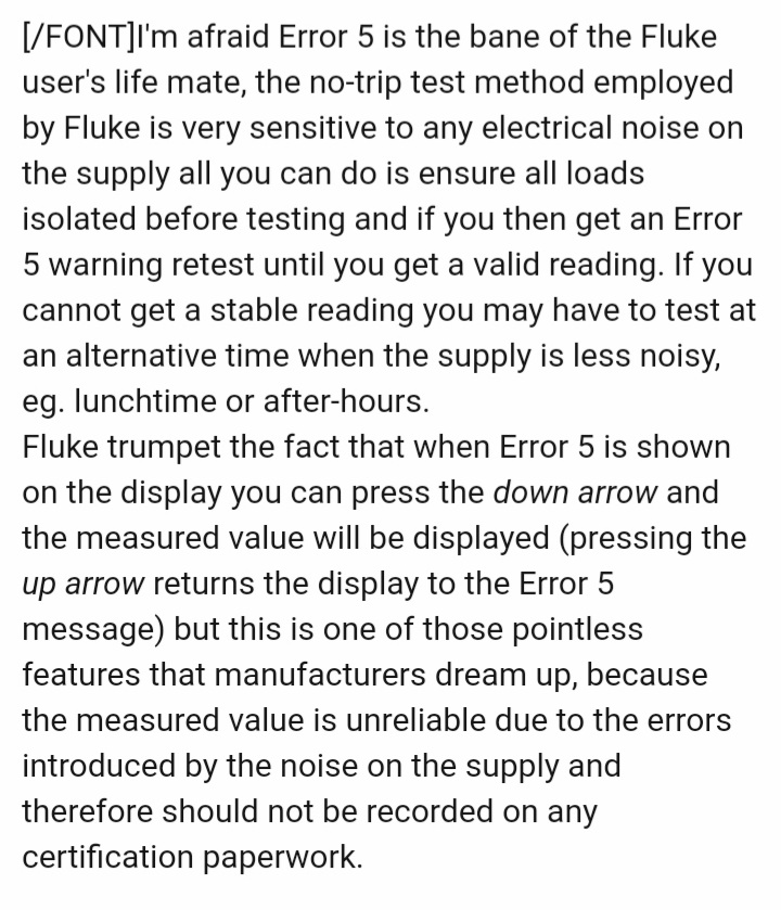

Sorry, probably not helpful in determining a cause, but a search led me here:
...and the last comment was quite interesting:
My KT64 has a display symbol 'noise'. The manual states that when doing EFLI testing and this displays you can get a reading by turning off ATT (anti trip technology). ATT is to stop RCD trip during test. Not sure if Fluke has this feature?
There are no settings for disabling the anti-trip on the Fluke, and if this is to be believed, the "Err 5", is a common occurrence:
It is true that the 1652 offers nothing other than 'no trip' loop impedance measurements, but other models in the range (I think including the 1653) do.
