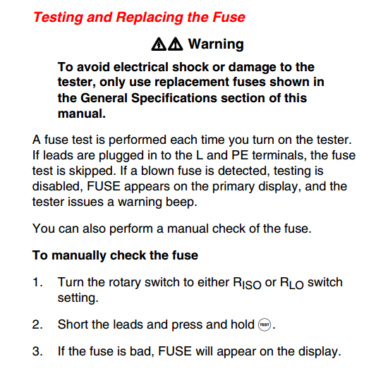

Page 43 apparently says a bit about it skipping a test.
I dont really like linking to rival forums but 4th october post
Ah, that's a fuse test (which is skipped if one powers up with the leads plugged in) ...
p43 of Fluke 1562 Manual said:
A fuse test is performed each time you turn on the tester. If leads are plugged into the L and PE terminals, the fuse test is skipped. If a blown fuse is detected, testing is disabled, FUSE appears on the primary display, and the tester issues a warning beep

Although, to my mind, far from a sensible reason for the test, Rocky has now brought our attention to one effect of not plugging in the leads - if one powers up the machine without leads plugs in, it undertakes an initial 'fuse test', but it doesn't do that test if it detects leads. Does that make any sense to you?

Now you have brought to our attention the fact that, for some extraordinary reason, the initial 'fuse test' is skipped if one powers up with leads plugged in, that goes a little way to explaining why I found different behaviour with/without leads when I 'simulated fuse failures' (by removing them) ....
Ah, it's actually more complicated than I previously described. ... If a lead is plugged into the L socket, the "LEAd" message appears on power-up, regardless of whether or not the 'internal' fuse is in place.
If no lead is plugged into the L socket, with the internal fuse in place, one again gets the "LEAd" message. However if (with no lead plugged in) one removes the internal fuse, one gets the "Err1" message. It takes about 1 second for that message to appear, and when it does appear there is an audible click of a relay operating. There is no such click when the internal fuse is present, whether or not a lead is plugged in (i.e. when I get the "LEAd" message).
I have now realised at least one reason why the internal fuse is 'hidden'. Since it's in series with the L-lead, and is in just a bare 'skeleton' fuse holder, it would be 'live' if an L-lead were plugged in and connected to the L of an installation. In contrast, the user-accessible fuse (in the 'battery compartment') is in series with the PE lead, and hence will usually be safe to touch. This illustrates another difference between the N and L+PE lead sockets - the N is not fused, but the other two are, and the fact that only L and PE ones have 'lead present detection' might be in some way related to this.
If I remove the PE fuse and then switch on, whether I have leads plugged in or not I still get the "LEAd" message (not the Err1 I get if I remove the L-fuse with leads unplugged). However, if I unplug the PE lead (but not if I unplug only the L-lead), I do get the 'relay click' which I get when the Err1 message appears (with L-fuse removed). You tell me :)

Both L and PE are fused, and I would have thought that both would be similarly likely to blow. If the PE fuse blows then, if one powers up without leads, the user is told of the failure and can replace the fuse himself/herself. If the L fuse blows, one gets an 'Err1' error message ('return to manufacturer for repair'), since that fuse is not accessible for user replacement. As I wrote before, one 'explanation' is that making a 'bare' L fuse (like the PE one) accessible for user replacement might be considered to be potentially 'dangerous' (for idiots). However, they would only have needed to spend a few pence for some sort of insulated fuse holder on the back panel to make that fuse also user-replaceable.
