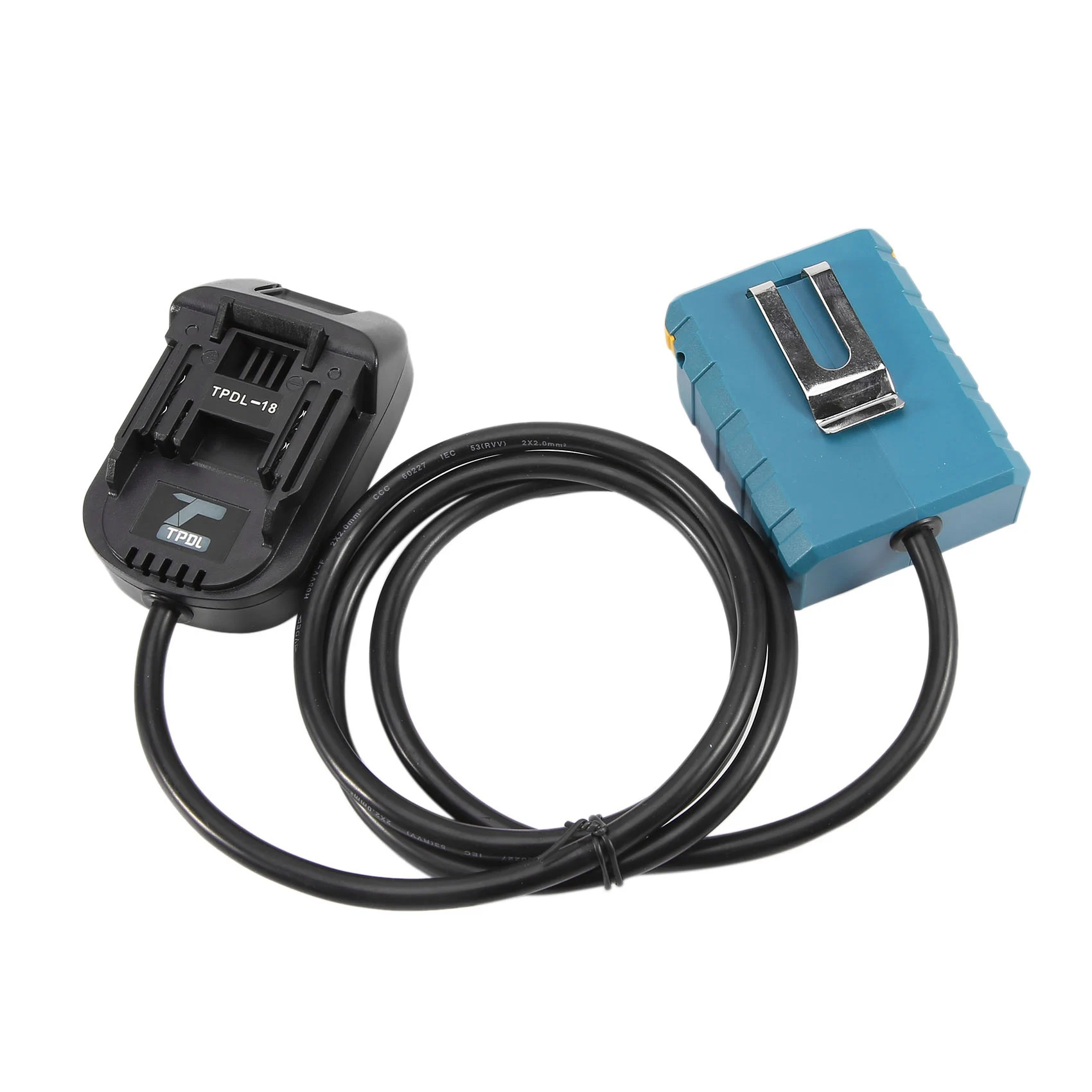

many an occasion where a lead system placing around half the weight off a tool on a belt or suspended elsewhere can be a life saver but only mak at present have this option :unsure:
Indeed, there are various ones cropping up on aliexpress for instance
However none on Banggood, which I consider a slightly up-market version of Ali. The quality looks a bit dubious. I'd expect a more substantial grommet arrangement on the cable. Obviously with something on a belt-clip the grommet has to be top notch, even better than for a corded power tool IMHO. Once 3rd party kit is looking a bit more like this:
Then perhaps I'll bite.
