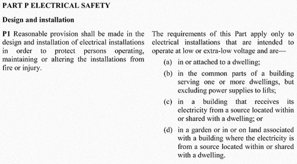

Nothing is statutory except Part P of The Building Regulations and Regulation 12 which lists notifiable work.

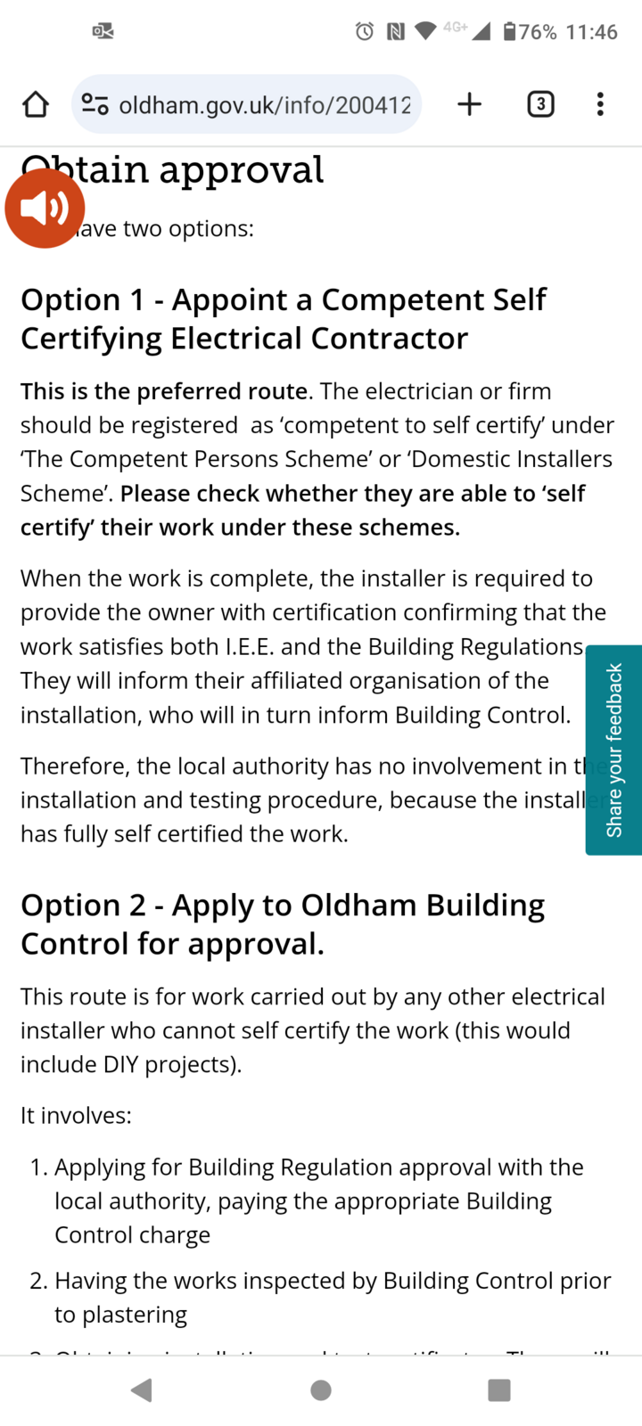

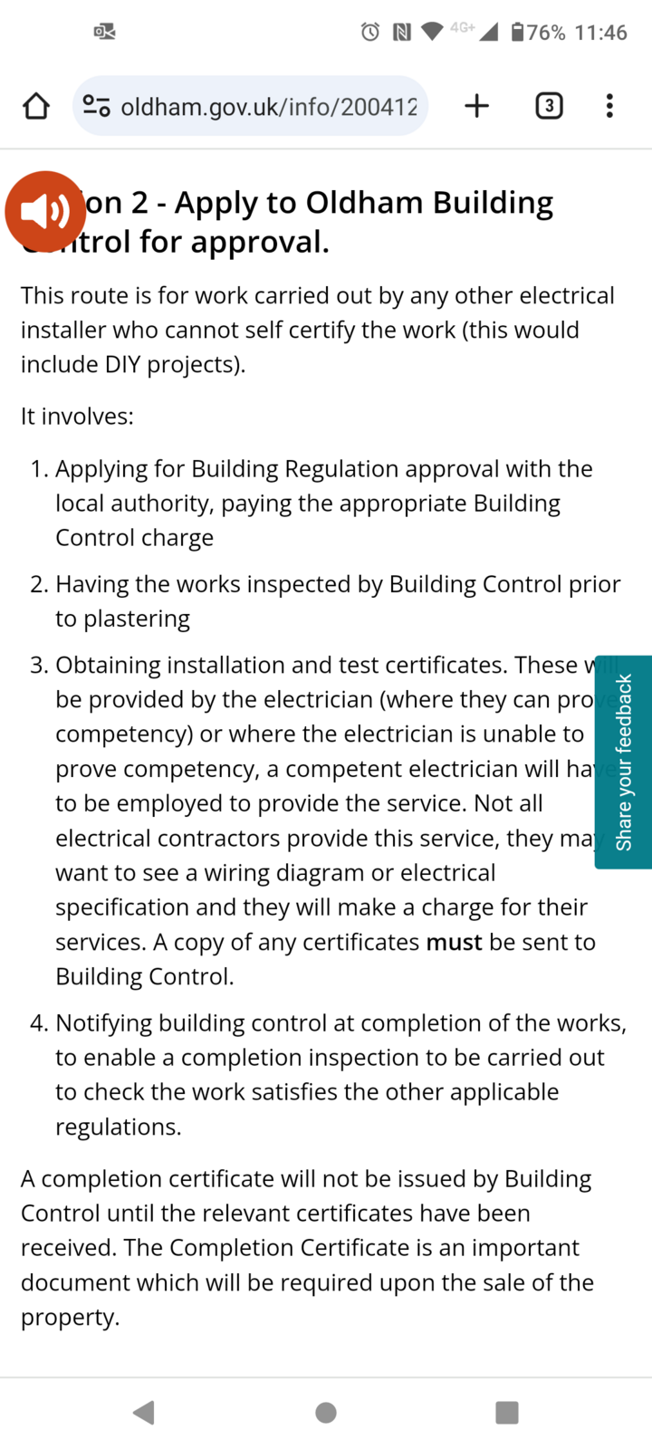

I've posted a few times about DIY electrical work, mainly because I've done a bit on my house. I'm currently completing a large extension which will involve non notifiable work (extending existing ring and lighting circuits). Building Control came round and said I'd need an (unspecified) certificate.
I looked on the council's website, option 1 is work done, certified and notified via a scheme and this is the DIY option, it doesn't seem to differentiate between notifiable and non notifiable.
Time for me to get onto my dodgy "drive by" electrician!
You want to be telling your building inspector to learn how to do his job, extension of existing circuits requires no further inspection by anyone, he might want a minor works certificate which you can download and complete yourself but that's as much as he can do about it.
Just keep your fingers crossed that nothing goes wrong........If it does you wont be insured
