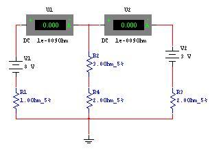

Different resistances wouldn't make it any harder, it would just create messy numbers.
I'd hate to think that anybody charging for his services would know so little about his chosen field of expertise that he got it wrong...
It's exactly that way though an installation electrician would rarely adds the sum of series and parallel resistors and voltage drop across them since their previous college days.
The one above is slightly more complex as in the current does not flow in the direction which you expect and will go the opposite way through the right hand side cell.
Unless that is if we are measuring voltage using a high impedance meter each one will measure approximately the same as the supply voltage local to it.
