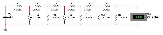

I get 11.429 volts (rounded) across the last lamp.
I've taken the resistance of 2.5 copper as being 0.009 ohms/metre.
Yes as I considered it I realised as the voltage drops so it uses less current so step one was to work out ohms. So I worked out ohms working from last lamp back to supply.
From this I could work out current to first lamp and hence voltage across first lamp then current to second lamp and hence volt drop and so on.
However I did not take into account internal resistance of the transformer or that the current taken by a quartz halogen bulb is not linear and takes more current when cold so in real terms the voltage would be less than calculated.
And only 6 lamps over 8 meters I know that looking at all the spec than ELV is supposed to be better but that's only when supplied with correct voltage and with these figures one wonders if the GU10 is not a better option?
Since BAS does not have answers I have stuck all the figures into Electronic workbench to see the answer that gives.
I see no takers for the problem I gave! Not that I really expected any. But seeing all the different answers for BAS's problem I think maybe better no one does challenge my results.
Seems I was 0.032 volts out on my answer!!!! I reckon Spark 123 and Me got it right and the programs out. My excuse and I'm sticking to it!

RE: the parallel lamps question...
Why's nobody considered the resistance, and hence voltage drop, of the return? BAS never said the 0V cable was made of superconductor! :)
So ericmark - isn't your model missing a few resistors?
Liam
I have taken 18mV/A/m to work out resistance of cable and V/A = Ohms so it will be 18mOhm for both cables I did not see point of using two 9mohm resistors so used 1 x 18mohm resistor.
