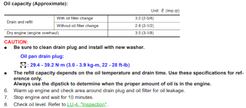

Everything was a huge struggle on the Japanese car. Took me hours to work out how to use the dipstick. The factory service info was wrong. I put in 3 litres as spec'ed and had to extract half a litre out to get the level right. I think the japanese deliberately make it difficult for people to DIY on their cars.

Japanese designed car with all the associated BS. They couldn't even state simply a torque spec without making a meal of it. They give a range. WTF is that about? Do I toque using a lucky dip approach to chose one from the range?

For what it's worth, specifying a range for tightening torque is standard engineering practice. They're not an exact science. In fact, they're a pretty rubbish way of specifying a clamping force, but the equipment is cheap, widely-available, and familiar. You can, indeed, take a "lucky dip" approach between the limits specified and the finished item should function correctly. They could specify an exact value to 15 decimal places, but what would that achieve? The objective is, presumably, to have the oil not come out and the filter not to fall off. Why add cost and complexity where none is required?

Just because any cowboy can do an oil change doesn't mean they do a good job. The last cowboy who did the oil change on the car probably didn't have a crush washer and so he used an impact gun to crush the old washer. I had to undo the sump plug with a breaker bar.
If any toque in a rage is good then it's waste of ink to print a range. It's done for no other reason than obfuscation. It seem oil capacity isn't a science to them either. So they print 3L when it can only take 2.5L.
3L will be the capacity for a brand new, never oiled before engine, or one that's been totally stripped down and rebuilt.
An engine that's previously had oil in it and drained will always have some oil left in it, plus a certain amount of dirt/sediment, particularly if its 20+ years old.
The amount required to fill it will therefore be less than the specification.
And this, from the guy who leaves the same oil and filter for 10 years...:rolleyes:
No matter how gently I do up a sump plug, it needs more torque to undo it a year later. It doesn't necessarily mean it was done up with an impact gun. Mind you, I'm such a "cowboy" that I do have to admit that the aluminium sump plug washer on my car is getting near the end of its life at 33 years old. I'll probably replace it with a Dowty washer when the time comes.
Don't be silly. Most tightening torques are specified as a range. There's a top and bottom limit that's determined by people who know a lot more than you about these things, and provided you stick within those limits, the joint will function as intended. If they'd specified a single number with no tolerance, you'd just as likely have come on here whining that they were being far more exacting than the situation demanded.
Most engines are like that, to a greater or a lesser extent. That's what dipsticks are for.

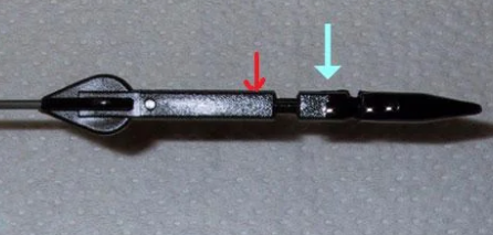

The dipstick they use is designed to drag oil around in the tube to contaminate the read, and it's almost useless for seeing clear new oil. In contrast, a proper matt-finish dipstick works with not the slightest problem, every time, new oil or old oil. Again, it's a designed obstacle. I am not used to an engine with random capacity depending on the time of day or day of month. It's quite a system shock to me.

The dipstick they use is designed to drag oil around in the tube to contaminate the read, and it's almost useless for seeing clear new oil. In contrast, a proper matt-finish dipstick works with not the slightest problem, every time. Again, it's a designed obstacle. I am not used to an engine with random capacity depending on the time of day or day of month. It's quite a system shock to me.
View attachment 267641 View attachment 267642
Hmmmm.... and has this only started happening since they switched on the 5G network after people had been given their Covid jabs, or do you think it's been going on for longer than that...?:unsure: The one you show on the left is the same as my wife's late Nissan X-Trail. It always worked fine for me... The ones like the one on the right are ****e, once diesel engine oil has gone black. Who the hell thought a matt black dipstick was a good way of checking the level of black oil?! So far, I think the bright orange PSA ones are about the best.
Someone with experience of cars. You are a bit suspect I think. Oil, no matter what colour or no colour at all, reflects light. Matt surface less so.
