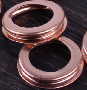

they're supposed to be flat
They are not, your lack of experience shows:
Oh dear... you still haven't worked out the difference between "flat" and the "thin" yet, I see? Come on... It's really not hard! A cylinder head mating surface has to be "flat". However, a cylinder head is not "thin".
Flat is not same as flat surface. Unlike a normal washer, the nissan washer is distinctly not flat even though it has flat surfaces after installation. Obviously, it's a problem on nissans where the sump plug could not be guaranteed to mate to the sump perfectly flat. Hence, the washer is made to adapt to the 'wonkiness' that could happen. This also explains why the garage had to impact gun it to hell to stop leaking. An ordinary washer would not have worked because it would need too much compression on one side. No doubt they tried using an ordinary washer. See, I have come up with this reconstruction just now. When you have a feel for things, you will know exactly what happened. If you were in their shoes, you too would be impacting that plug like a crazed nut, all the while not understanding why there is a problem.
This is one more evidence of japanese manufacturers creating obstacles to trip even the so called experienced garages. Although, their intended target is the DIY'er. I speculate the threads on the sump is deliberately made at an angle to render the ordinary flat washer useless.
One of the small pleasures of going on internet fora, is watching people who are clearly clueless, attempting to "educate" those who (if only they had the wit to realise it), are a lot more knowledgable than themselves on something or other. I suppose it's a sort of 21st century, gender-neutral, virtual form of "mansplaining"...:ROFLMAO:
Yes, that type of washer (often called a "crushable" washer), is partly intended to take up misalignments between the mating surfaces. However, I can assure you that Nissan's (or indeed Renault's, as they were basically the same outfit when that Micra was built) manufacturing capabilities are no different to those of any other car manufacturer - not that many car manufacturers make their own sumps or sump plugs or indeed sealing washers. But then, you didn't become the "foghorn of ignorance" that you are today, by listening to other's peoples' assurances, did you?;)
Getting back to the issue though. A "flat" (or "plain", as they are called in ISO 7089) washer will be available in various thicknesses. You are confusing the terms "flat" and "thin". What you are describing is a "crushable" washer that has either been re-used several times, or has been over-tightened (or both), and has become "thin" as a result.
