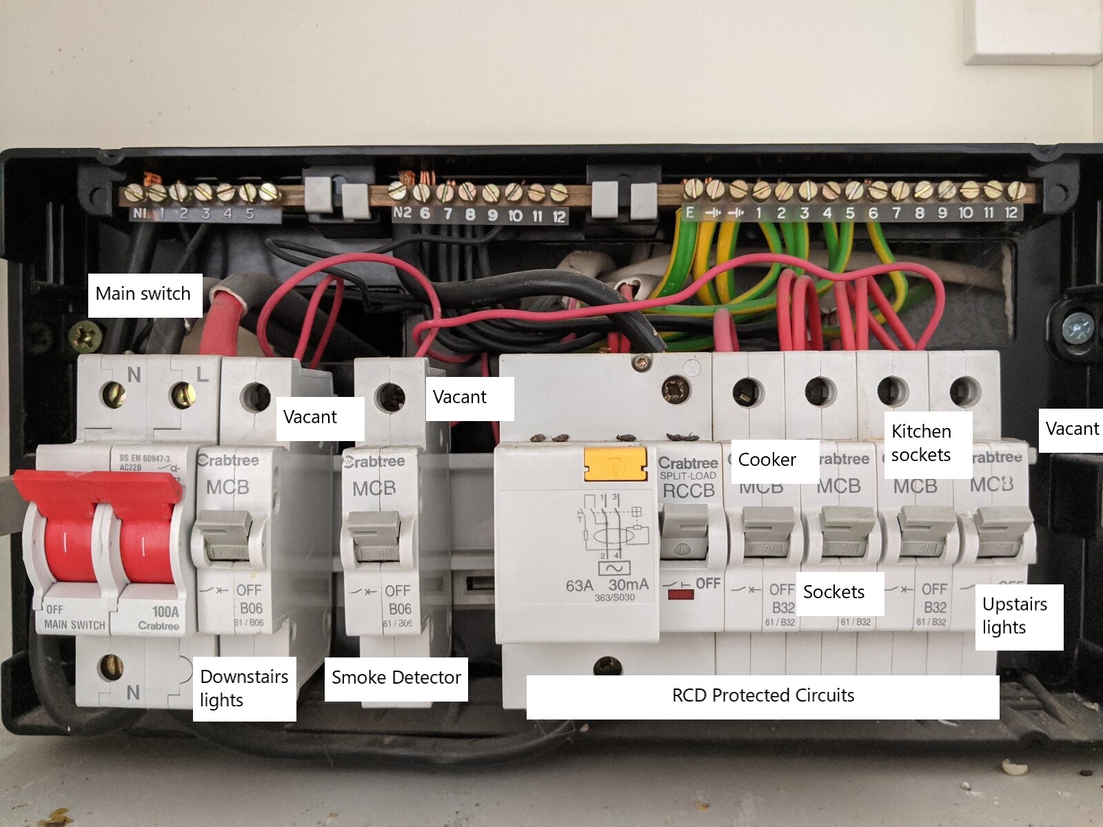

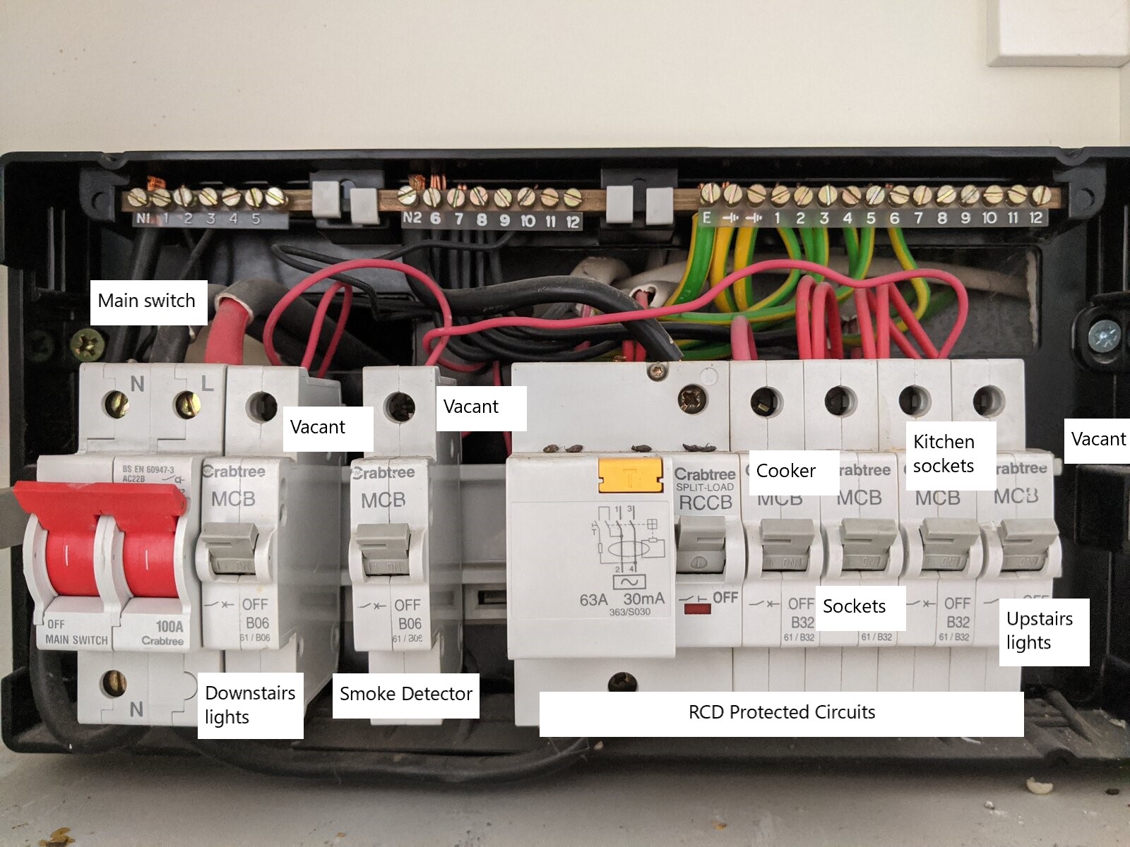

Thank you, I appreciate the help especially given the wrong terminology. I am planning to change my CU in the near future and have a seperate circuit for the outside lights, but in the meantime, could I go for an RCD protected fused spur (like this one: https://www.screwfix.com/p/british-general-900-series-13a-unswitched-passive-fused-spur-white/8250p) instead of the 20A DP Switch? Initially I will have 6 5w led bulbs connected and then in a couple of months I'll have the wiring switched over to a dedicated circuit when my new CU is installed, however at the present my downstairs lighting circuit is the only one that is not on an RCD
Yes, you could - although recently some people have discovered that they are not supposed to be on circuits that are not already on an RCD, but I have no idea why - better than nothing, I suppose.
That's odd - the only one - are you sure?
Apologies, I responded before I had a chance to look at my notes again. The downstairs lighting and smoke detectors are not RCD protected, but everything else appears to be. I've attached a photo of my CU with the labels.

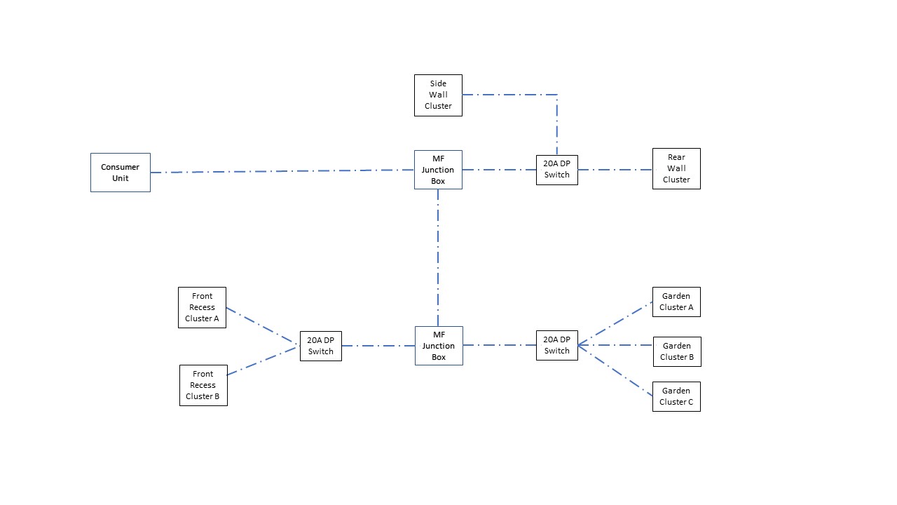

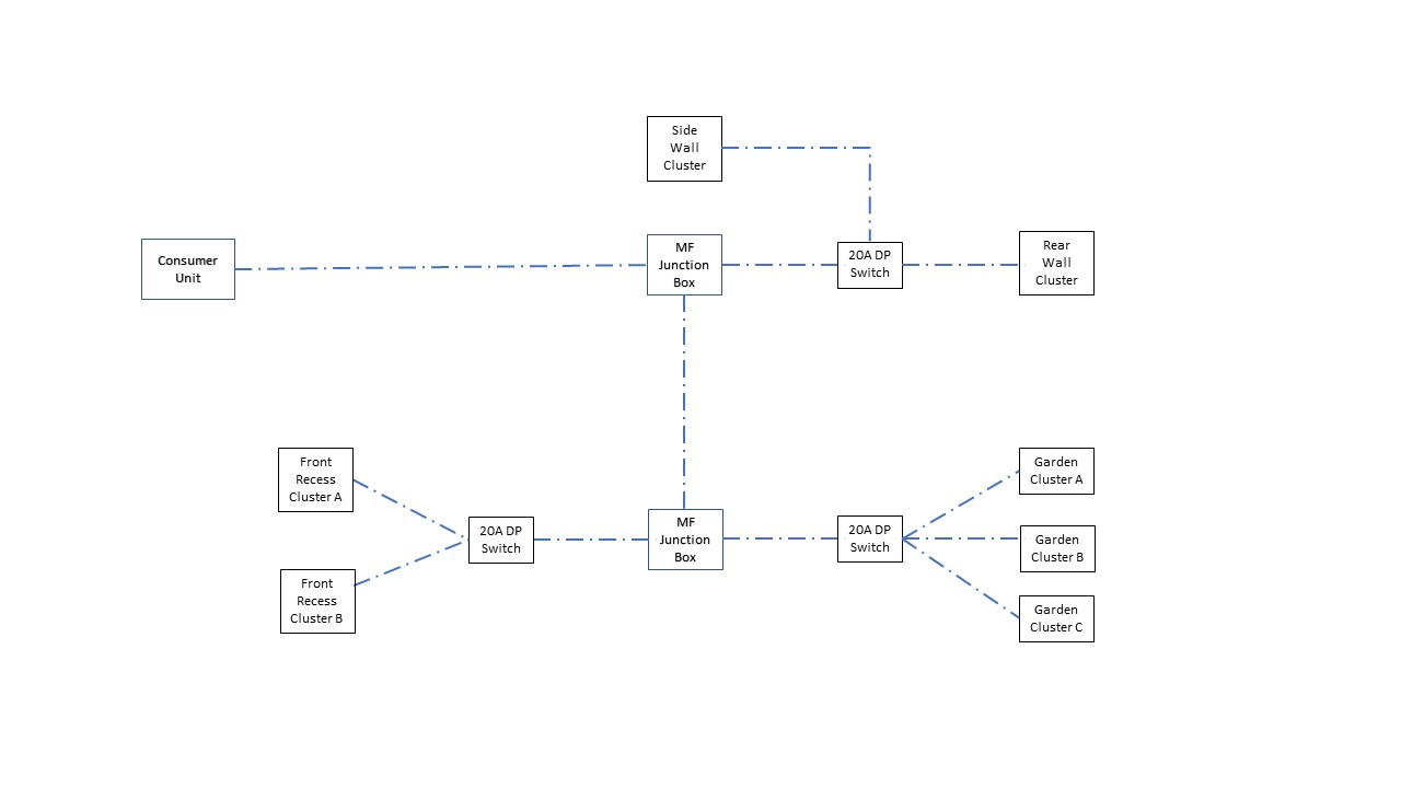

I've had some thoughts on how I'd like to light the front, side and rear of the house and have revised the wiring layout for the new RCD protected circuit, but I would be grateful if someone could cast their eye over this (see attached), particularly for the garden clusters. Is it is feasible to run 3 cables from the DP switch down to each cluster in the garden or should I consider a different method?
All light fittings will have a max 5W LED bulb (or 3W if possible), and the number of lights per cluster will range between 6-14 lights. My aim is not to create masses of light, but illuminate selective features and have a remote dimmer to control light output.
