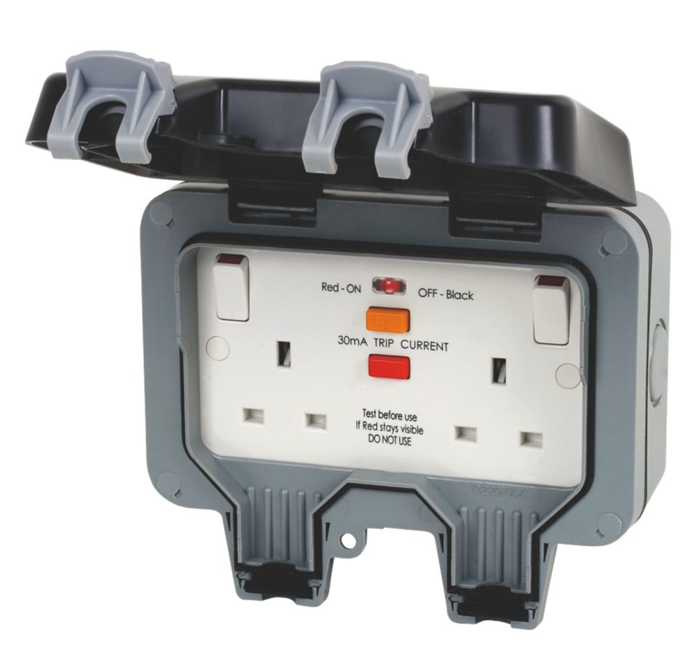

I recently put in an outside socket for a hot tub. The hot tub is rated as 13a and hot tub company recommended this outside socket from Screwfix.
BRITISH GENERAL IP66 13A 2-GANG SP WEATHERPROOF OUTDOOR SWITCHED PASSIVE RCD SOCKET
But I thought I'd get "clever" and instead put in a separate RCD inside and then run cable to the socket location closer to where the hot tub is positioned. So I bought...
BRITISH GENERAL IP66 13A 2-GANG DP WEATHERPROOF OUTDOOR SWITCHED SOCKET

The RCD socket linked to
ae235
I would say not suitable for a hot tub, as the cover will stop plug cooling, great for a 3 amp battery charger or Christmas lights, not really any good for an electric car charger or hot tub.
The RCD FCU is a far better idea where the fuse is cooled by the wall and does not rely on free air, although you can get 15 amp sockets that would fit in the water resistance cover, personally see this as a problem as lawn mowers and the like use moulded 13 amp plugs, even electric car chargers will likely be 13 amp plug or a special for car charging, so in spite of all I have said, in real terms there is no option but use some thing like in the picture, but would not put the cover down when using to first heat hot tub, once hot then as you say mark/space switching will reduce the heat at the plug.
