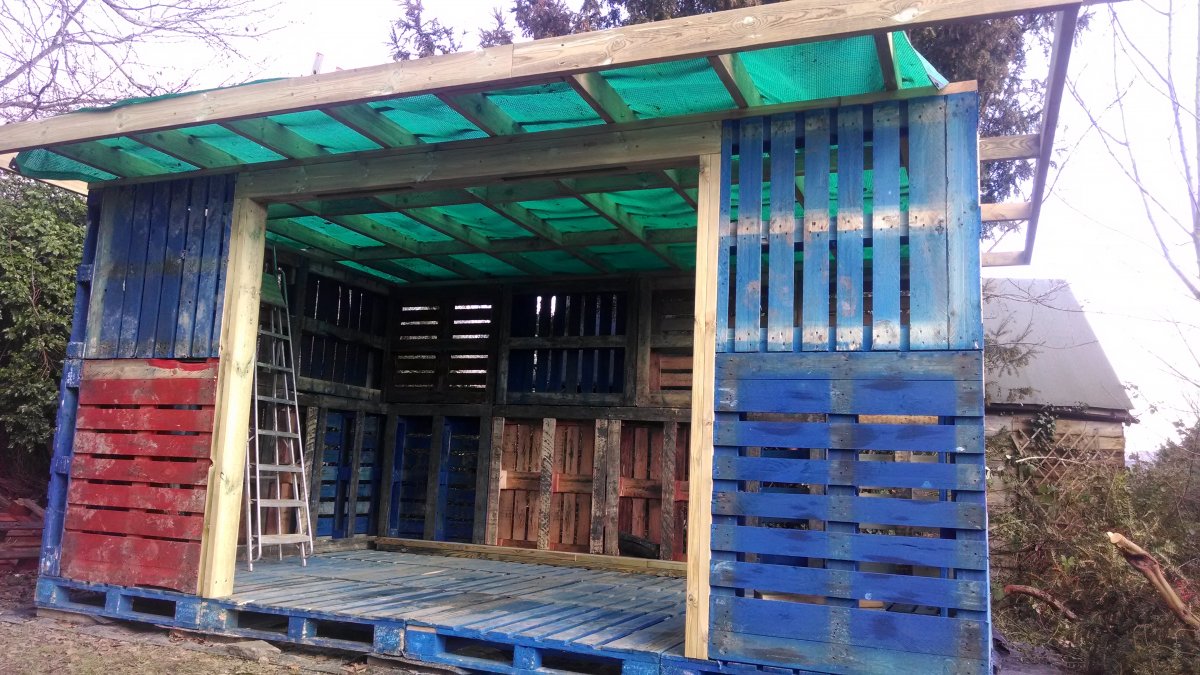

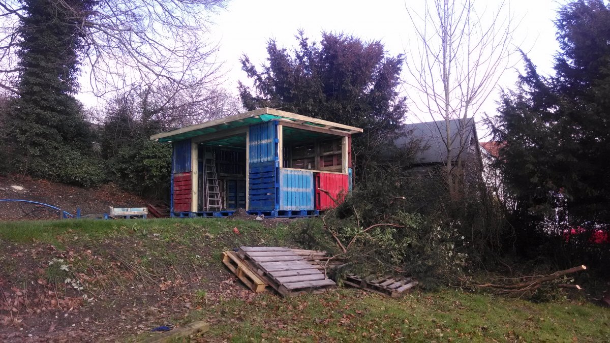

Here's my attempt so far. Putting the roof on tomorrow. How did you do your walls and have you had any problems with condensation or moisture? I'm currently deciding what to do with insulation, breathable membranes, air gaps etc. Not sure it'll make a huge difference in my case as the big double doors will generally be open when its in use so figure it only really needs to be watertight. It's so easy to carried away building it as if someone were to live in it though!
Wow that's looking perfect :) great job.
I've as yet had no issues with damp/moisture. It's dry and secure enough for my 84" projector screen, projector and surround sound :) loving it!!
In terms insulation, B&Q loft insulation is all I got, like £4 a roll, bought about 12 rolls if memory serves. Packed the walls and the ceiling voids with as much as I could, it's really well insulated and toasty on these cold winter nights.
