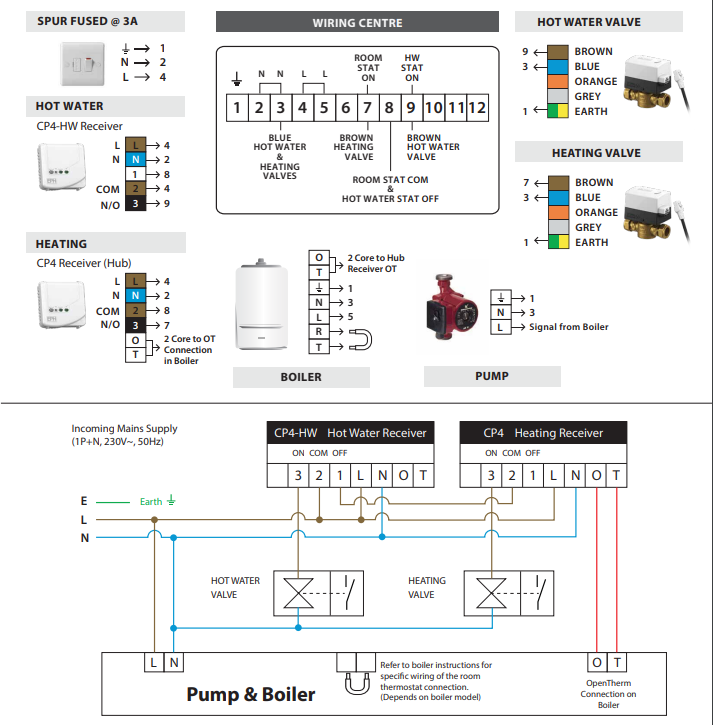

I've recently had a new Ideal boiler installed (Ideal Logic Max Heat 2 H18) and plumbed for PDHW (priority hot water). I use it with EPH CP4 series: CP4i, additional Combipack 4, CP4-HW-OT, wired and configured as per EPH instructions, covering downstairs, upstairs and hot water tank, with the boiler controlled using OpenTherm.
The boiler target flow temperature is set on the master CP4 using HHbO (t-5) in the OpenTherm parameters and the boiler display shows that this is working.
However, for PDHW the aim is to use a lower boiler target flow temperature when running central heating (e.g 55°C) to keep the boiler in condensing mode and higher when heating the hot water tank (e.g. 69°C) to get the tank above the Legionnaires temperature. Unfortunately the EPH set does not support dual temperatures, so I set HHbO to 55°C and use a relay across the OpenTherm wires when HW is on, which causes the boiler to run at its set flow temperature (69°C).
This produces the desired result, but is a bit naff (and the boiler display is wrong when heating HW). Has anyone found a better way?
Are you talking about the setup below?
Have you emailed EPH technical support to ask how it is supposed to work? This diagram doesn't seem to mention a relay. I have only ever read about this type of setup, but had assumed the hot water cylinder temperature and the hot water flow temperature were set on the programmer and were then somehow transmitted to the boiler on the OpenTherm connection.
Above my pay grade, but I have noticed P06 and P08 settings which talk about setting DHW temperature.
I think I've read elsewhere that the Ideal Logic has built in PDHW support and doesn't need to use the EPH controls.
@muggles and @vulcancontinental and @Sim777 may be able to advise.

Thanks for your reply - yes, it's as the setup you showed, but with two CH zones (an additional CP4) and yes, I've been in contact with EPH tech support. You are correct that P06 seems to offer DHW temperature control, but this doesn't actually affect the temperature that the CP4 sends to the boiler over OpenTherm - the CP4 always requests what I've set in HHbO (55°C) and the boiler is quite good at keeping to that. But to get the hot tank water to 55-60°C you need 65-70°C flow temperature.
So, did EPH advise how best to make it work? Is the relay method you currently have the official way of doing this? I also thought it would be less clunky!

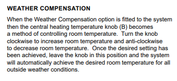

Pages 4 and 5 appear to show the wiring for using SL2 on the Logic. The guide doesn't specifically say it covers Logic 2. But what is the point of having a weather compensation connector on Logic 2 if it can't do PDHW? The flyer for Logic Heat 2 definitely says that it does weather compensation. And anyway, why would a frostat need a separate switched live. It's all very strange but it could just be a mistake. I have found quite a lot of mistakes in various installation manuals. The wiring itself looks quite different to the Vogue wiring.
Yes, Vogue and Logic Max Heat 2 seem different. In summary, the Logic Max Heat 2 offers terminals: SL1 (primary on/off from room stat), SL2 (Frost Stat), OpenTherm and Weather Compensation.
The best way to get the information from Ideal might be to ask them how to do weather compensation on your boiler.
Useful link, thanks, and it shows that the weather compensation is connected into the two terminals just to the right of the OpenTherm terminals in the boiler. The description in that link shows that it affects the boiler target flow temperature, but when OpenTherm is active that is what sets the boiler target flow temperature, so I am doubtful that weather compensation is the way to go.
EPH advised that the Influence setting in the EPH controls can be used to affect the boiler modulation and thus the temperature. But it doesn't do that with my Ideal boiler, which is very good at producing the flow temperature that is requested by the EPH control. EPH said that "It generally works well" but apparently not with my boiler.
As for the relay method, this is not an official recommendation, so I'm not overly keen on it, hence the original post asking for any better ways. However, it is just shorting the OpenTherm terminals and so is in line with the OpenTherm spec (it simulates a heat demand as from an on/off system) and the Ideal installation instructions (which show the OpenTherm connections shorted when not using OpenTherm).
