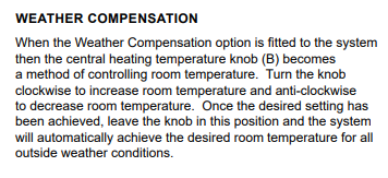

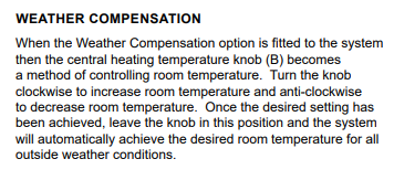

The point was that @Notch7 above suggested using the built in weather compensation function, as an alternative to OpenTherm, in order to achieve PDHW. The OP (@Cleph) said that the boiler isn't capable of doing that because the SL2 on this boiler doesn't allow it. I was pointing out that it must possible. It is even mentioned in the user guide (see below). Presumably the wiring would have to change.

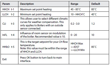

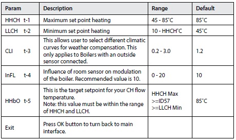

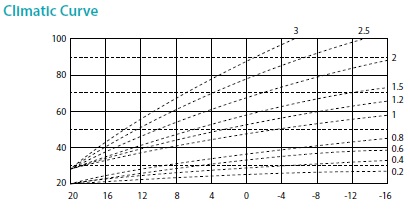

I am encouraged to hear that my room stats would still work if weather compensation is fitted, but I guess the question is whether adding a weather compensation kit would disable the OpenTherm control from the EPH stats. Here's the page from the EPH user guide for setting OpenTherm parameters:

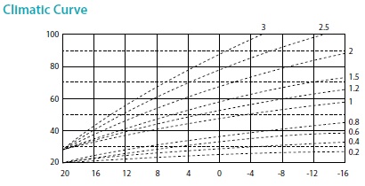

And the climatic curves from the next page are:
Which go in a similar direction to the Ideal WC curves that @MNW67 showed above (if you allow for the reversed axis).
If the Ideal WC Kit worked sensibly, i.e. took account of the OpenTherm information from the EPH stats, then it would be great. But if it's not sensible then it will override the OpenTherm values and I will have spent money unnecessarily. I guess I need to think of a question, but if anyone has experience of OpenTherm with the Ideal WC kit I'd welcome any input.

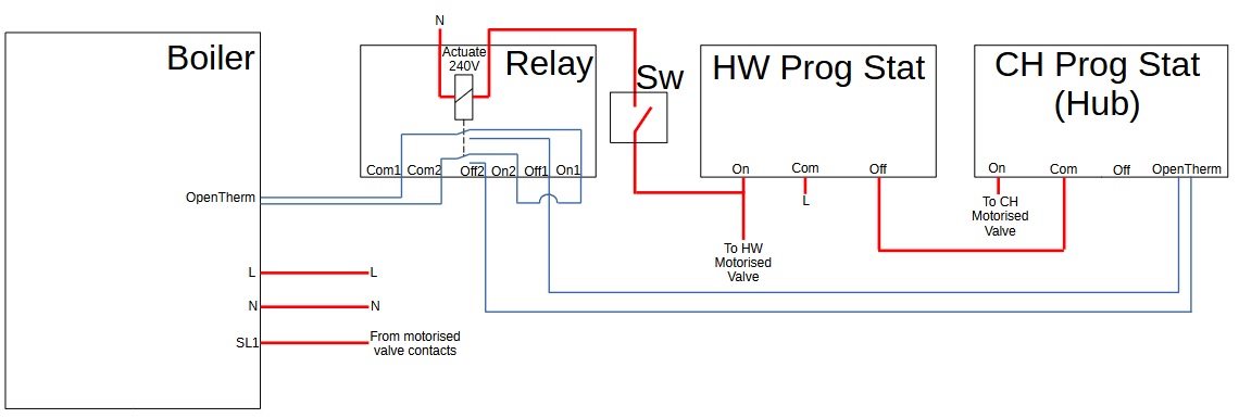

I've recently had a new Ideal boiler installed (Ideal Logic Max Heat 2 H18) and plumbed for PDHW (priority hot water). I use it with EPH CP4 series: CP4i, additional Combipack 4, CP4-HW-OT, wired and configured as per EPH instructions, covering downstairs, upstairs and hot water tank, with the boiler controlled using OpenTherm.
The boiler target flow temperature is set on the master CP4 using HHbO (t-5) in the OpenTherm parameters and the boiler display shows that this is working.
However, for PDHW the aim is to use a lower boiler target flow temperature when running central heating (e.g 55°C) to keep the boiler in condensing mode and higher when heating the hot water tank (e.g. 69°C) to get the tank above the Legionnaires temperature. Unfortunately the EPH set does not support dual temperatures, so I set HHbO to 55°C and use a relay across the OpenTherm wires when HW is on, which causes the boiler to run at its set flow temperature (69°C).
This produces the desired result, but is a bit naff (and the boiler display is wrong when heating HW). Has anyone found a better way?

Sure, @chrisk801. I based my setup on a diagram in these forums but can't locate it at present, so I've sketched out what I have, which is much as you describe:
The relay is off when HW is off, thus connecting the boiler OpenTherm contacts to the OpenTherm output of the downstairs CH prog stat, which sets the boiler to run at 55°C. When HW turns on it actuates the relay, which disconnects the OpenTherm from the CH prog stat and applies a short across the boiler's OpenTherm contacts (and because I have set the boiler to 69°C that's what it runs at). Here's another reference: https://www.diynot.com/diy/threads/opentherm-with-s-plan-system.534229/post-5305901
The relay I used was https://www.discountfiresupplies.co...50_60Hz-Coil)-in-White-or-Red-Single-Gang-Box
I've shown a switch in the line from HW Prog Stat On to the relay actuate input, which we keep closed (On). But I could turn off that switch, which would simply mean that the boiler temperature continues to be controlled by OpenTherm from the CH Prog Stat.
@MNW67 - It depends on your wiring. Mine is PDHW by virtue of the wire from the Off of HW Prog Stat to the Com of the CH Prog Stats. But I actually have a switch in that wire so that I can, if needed, run both CH and HW at the same time, for example if we've been away and want everything heated up quickly - I think that's the equivalent of S-plan?
