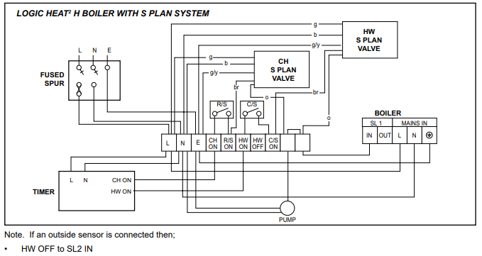

On the logic system boiler the wiring diagram for S plan on logic with weather comp shows BLR on goes to SL1 and hot water off goes to SL2.

Finally, I have just found the below diagram in the installation manual for the regular version of the Logic Heat2 (not the Max version manual). It says "Note. If an outside sensor is connected then HW OFF to SL2 IN". This is exactly how it has been done on previous versions of the Logic, as shown in the Weather Compensation Guide linked to above. However, the main wiring schematic in the regular version manual also shows SL2 as "Switched Live Frost Stat" just like it does in your manual. It seems pretty clear that this reference to the Frost Stat is just a mistake.

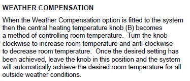

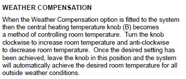

Although this might be the route that Ideal force one to follow, I am still very doubtful about it because of this paragraph in the user guide, page 4, as linked by @MNW67:
This is absolutely not what I want, because my room temperatures are set to different levels at different times of day (we like it warmer in the evenings) and are different between my two heating zones (bedrooms cooler). That's all handled by the EPH programmable stats.

It doesn’t actually control room temperature, it’s badly described, it’s used by the boiler to make a comparison with the outside temperature so the boiler can calculate best flow temperature. It’s a notional temperature setting.
@Cleph
That quote about how weather compensation works on the Ideal boilers is extremely confusing. I don't know why they have written it like that. With weather compensation, you still set the actual room temperatures using the room thermostats! The "Room Temperature Setpoint", which you choose with the boiler knob, does not affect that actual room temperature. Instead, it just adjusts the flow temperature based on the curve you choose and the outside temperature. Below is the information from the Ideal Weather Compensation Kit guide. It is very, very confusing. I would imagine that Ideal were trying to simplify things with their description of how it works, but they've just made it worse.

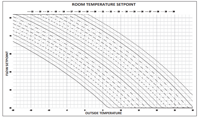

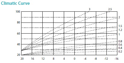

I am encouraged to hear that my room stats would still work if weather compensation is fitted, but I guess the question is whether adding a weather compensation kit would disable the OpenTherm control from the EPH stats. Here's the page from the EPH user guide for setting OpenTherm parameters:
And the climatic curves from the next page are:
Which go in a similar direction to the Ideal WC curves that @MNW67 showed above (if you allow for the reversed axis).
If the Ideal WC Kit worked sensibly, i.e. took account of the OpenTherm information from the EPH stats, then it would be great. But if it's not sensible then it will override the OpenTherm values and I will have spent money unnecessarily. I guess I need to think of a question, but if anyone has experience of OpenTherm with the Ideal WC kit I'd welcome any input.
