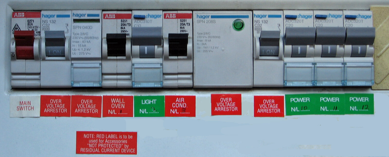

We have 16A circuits and 16A sockets.
Australia "gets by" with (unfused) 10 A Socket Outlets on 20 A (2.5 mm²) Radials - and "Ring" Circuits are not permitted.
(15 A Sockets can be installed on such Radials, if required.
This used to be done for "Window Air Conditioners")
Kitchens are usually supplied by two separate 20 A circuits, (with 10 A Socket Outlets)
BUT
each of these circuits usually supply other rooms as well. (Bed Rooms, Lounge, Laundry, Garage etc .
[Diversity])
Most average homes "get by" with three to four 20 A Radial circuits, plus one or two "Lighting Circuits" - of 10 A (1.5 mm²)
(Hence,, no "Winston" problems with using 10 A Socket-Outlets on Lighting Circuits" !)

Below is pictured a CU in a two bedroom house.
Typical, except that it has "over voltage" protection - which is not yet common
