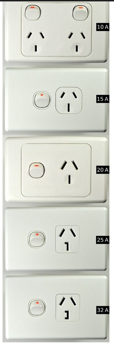

What I'm less clear about is the 'point' of having all those variants of sockets. If one assumes 20A circuits, what is the difference between the 10A, 15A and 20A sockets that could be connected to it, other than that they will only accept a plug of the same or lower 'rating'? Are the 15A ones really not able to 'safely carry' 15A or 20A, or the 15A ones not able to 'safely carry'; 20A?
In other words, at first sight it would seem (to me) that it would be simpler and more flexible/versatile for all sockets on 20A circuits to be 20A ones. What am I missing?

The !0 A, 15 A and 20 A socket-outlets shown are connected to circuits rated at 20 A (2.5 mm²).
25 A and 32 A socket-outlets are supplied by circuits of those higher ratings
The "higher rated" socket-outlets are for use with devices with a higher current "draw".
Window mounted Air-Conditioners often required more than 10 A, so 15 A socket-outlets were required.
("Installed" (hard wired) Air-Conditioners are now much more common.)
Surface mounted 10 socket-outlets (https://commons.wikimedia.org/wiki/File:Australian_Surface_Socket-Outlet_and_Plug.jpg ), used largely for "luminaires" and "ceiling-fans", are usually installed on 10 A (1.5 mm²) "Lighting Circuits".
(Hence, there should be no problems of which any "Winston" could complain !)
While these higher rated socket-outlets exist, I doubt if 99% of the Australian population will ever have seen any above 15 A in use (I have not)
The 15 A Plug and Socket-outlet is used at Caravan Parks.
Higher rated socket-outlets tend to be "Industrial" and "Round-Pin" socket-outlets are usually used above 15 A.

there is really no "current carrying differences" between 10 A, 15 A and 20 A Socket outlets - except that 20 A Socket-Outlets are not available as "doubles" while 15 A Socket-Outlets are !!
(https://directwholesale.com.au/prod...-250v-15amp-horizontal-twin-powerpoint-white/ )
The "capacity" of the flexible "cord" used is probably more significant.

... there is really no "current carrying differences" between 10 A, 15 A and 20 A Socket outlets ...
That's what I suspected, and the reason I asked what was the difference (other than pin sizes) between 10A and 20A outlets. As you go on to say ..
