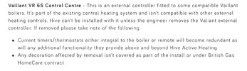

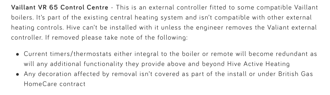

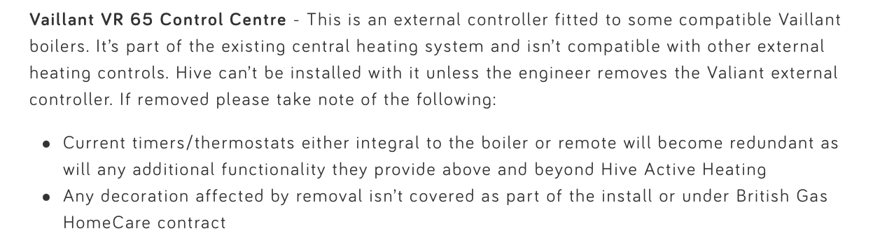

I have the VR66 and looked into getting a Hive.
Looking at the Hive website it says that it isn't compatible with the VR65 (which is the same as the VR66 really) and was told I would need to completely decommission the wiring centre and start again

It really isn't anything to worry about. The Hive is doing all the work of the control centre (the VR65 will be redundant after the hive install), you just have to make the right connections, which Ian has suggested.
From Hive website:

yes you can use the hive, but you need to remove the existing control, not a hard job to do, what they mean is you cant have both connected at the same time
