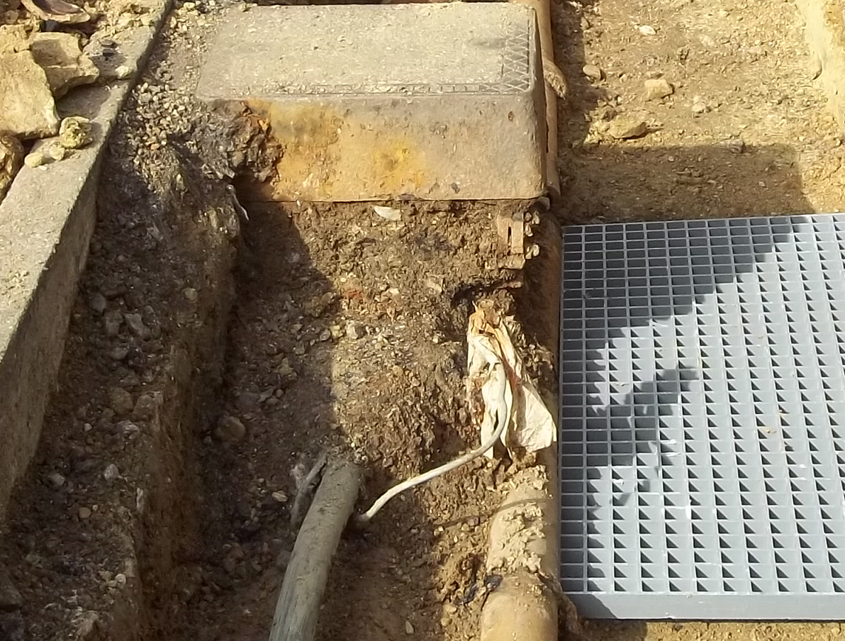

PME earth electrode discovered under the pavement.......So they DO exist.....
You must be right next to the pot end, they are on the end of every CNE cable (3phases plus combined neutral/earth on a PME system
On WPDs network, every joint on the main has to have a ‘pigtail’, a coil of copper wire left in the ground. Apparently they don’t put rods in any more after a few near misses!
Every service alteration I see done involving a joint has a pigtail and a length of hard drawn bare copper run in the trench.
This is part of SSEN procedure too, has been a thing for 6 or so years now, wasn’t done when I did my training though!
Were these 'near misses' the worst they experienced, or did they also have some 'hits'? :)
