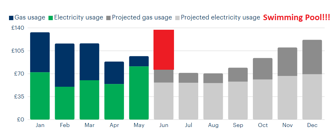

Keep an eye on your electric meter readings. Before you fit the heater take a meter reading over 24 hours, then take another reading after you have had it on for 24 hours and see the difference. From that you will be able to calculate roughly how much it will cost you to run it.
Thanks. I am expecting it to hit us hard, but hopefully it will not cost more than the money we're saving in petrol each month.
Electric bills are already £25 more a month, with 2 PCs and 2 xboxes on all day, plus about 20 extra cups of tea, and an electric oven and hob cooking all these extra meals. Still cheaper than work lunches and school dinners though!
After lockdown ends it might be different. If we all decide we love pool life then I'll probably get a more efficient heater in 2021.
I've updated my Bulb prediction for June ...

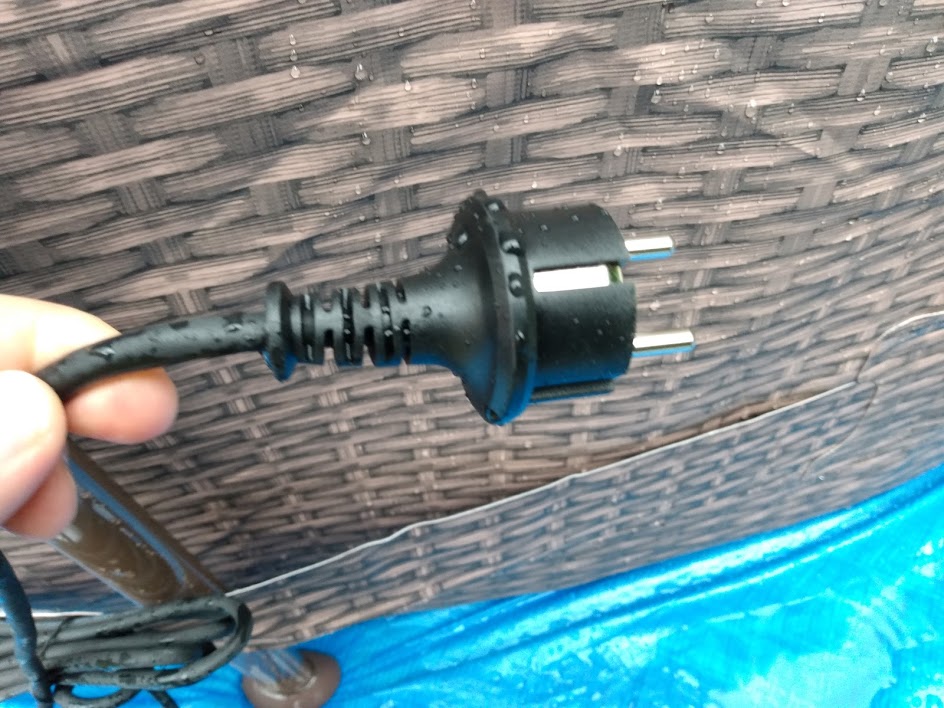

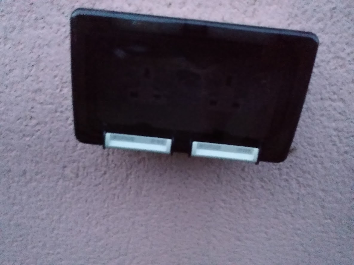

OK, I have set up the pool and looked at the filter instructions. A bit surprised to read that it should not be plugged into an extension cable. Bit of a spanner in the works! It also has a European plug with adaptor.

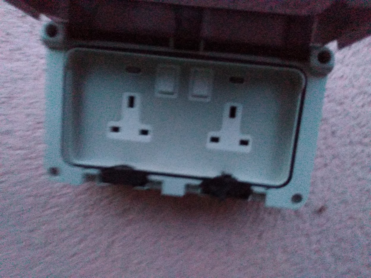

So, I know the best practice thing is to pay a sparky to bury a proper cable and hook up suitable outdoor sockets. But, I just spent the last of my money on an over priced paddling pool.

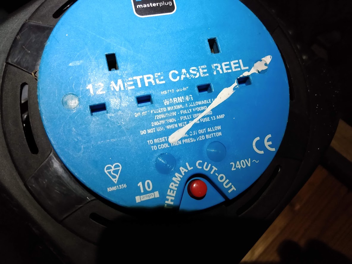

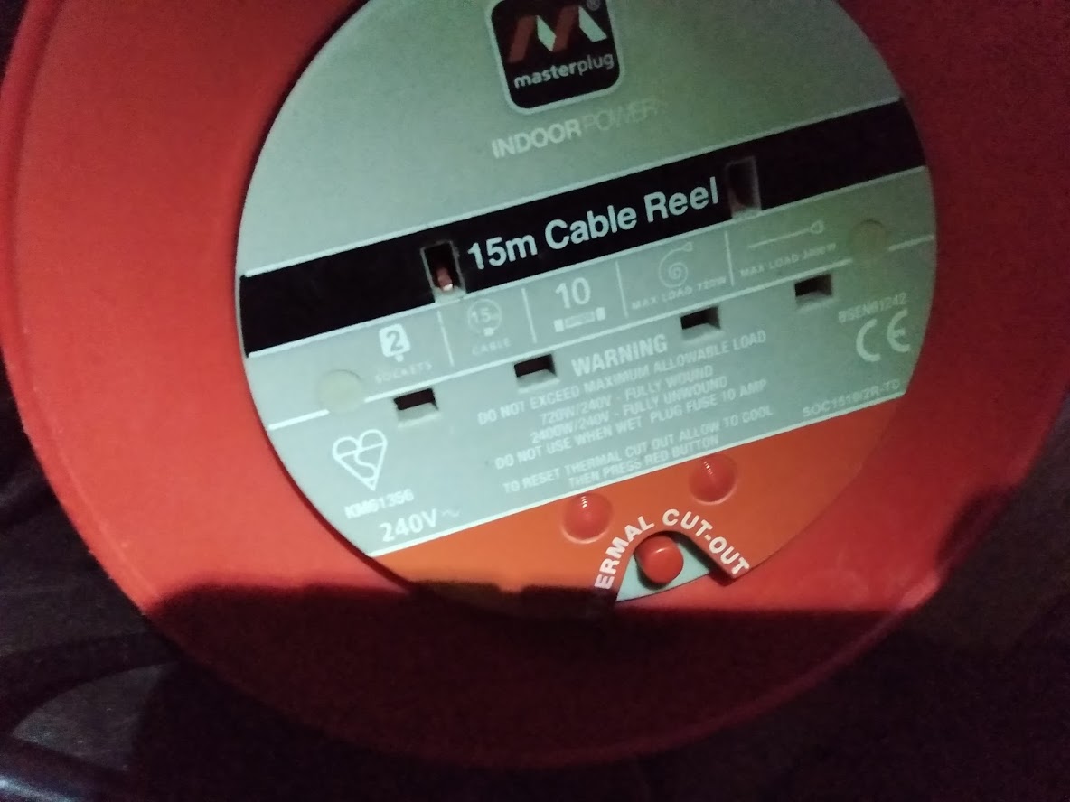

I have an outside double socket, and 2 extension leads. Both extension leads say they can handle 2200W.

Yes, shouldn't be a problem then, unwound? They need to be unwound to reach the pool.
One of the reasons they say not to use an extension is because people don't always fully unwind them, however, there is also the danger they can get splashed if near the pool or the pool should burst.
Personally I would cut that plug off, (you need to anyway), and I would extend the cable with crimps and heat shrink, waterproof sleeving instead of using plug in extensions.
How is the cable attached to the heater itself? Would it be easy to replace it with a longer cable? You should be able to buy a 20-30m cable that will carry 2.2kw easily enough, it’s just under 10A
Just get a cable with waterproof connector. As others have said as long as it is unwound it should be ok.
I did similar but used a 2.5mm cable but then had to use a toughplug on one end.

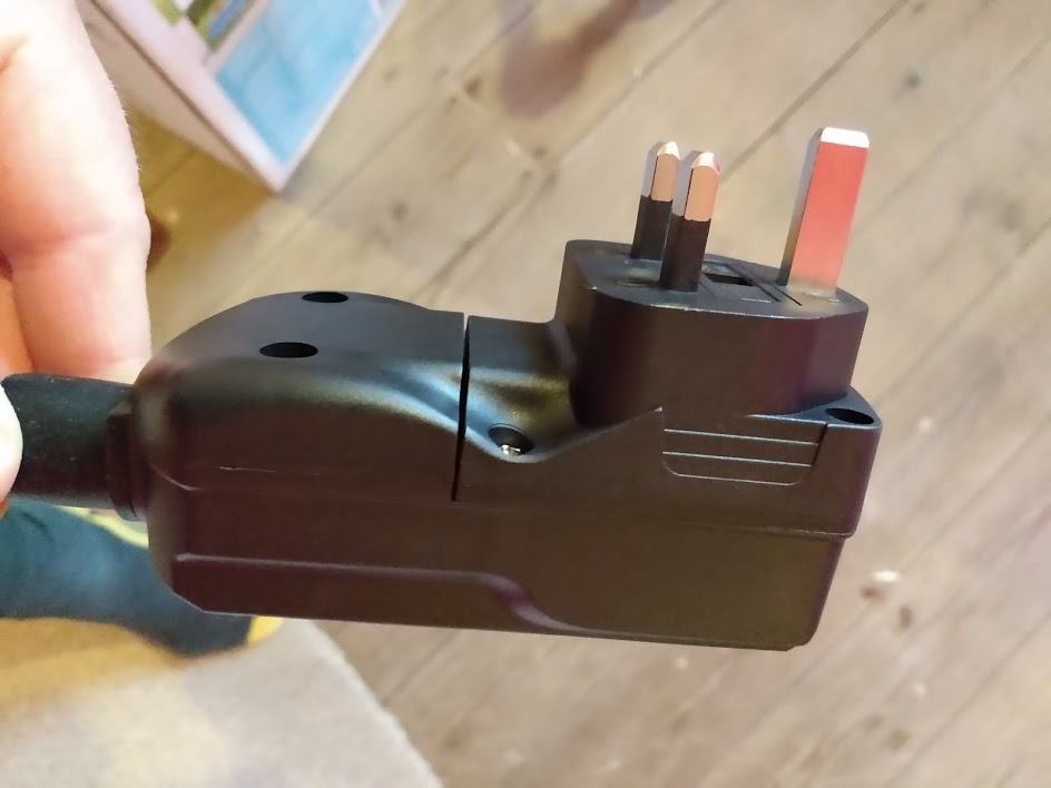

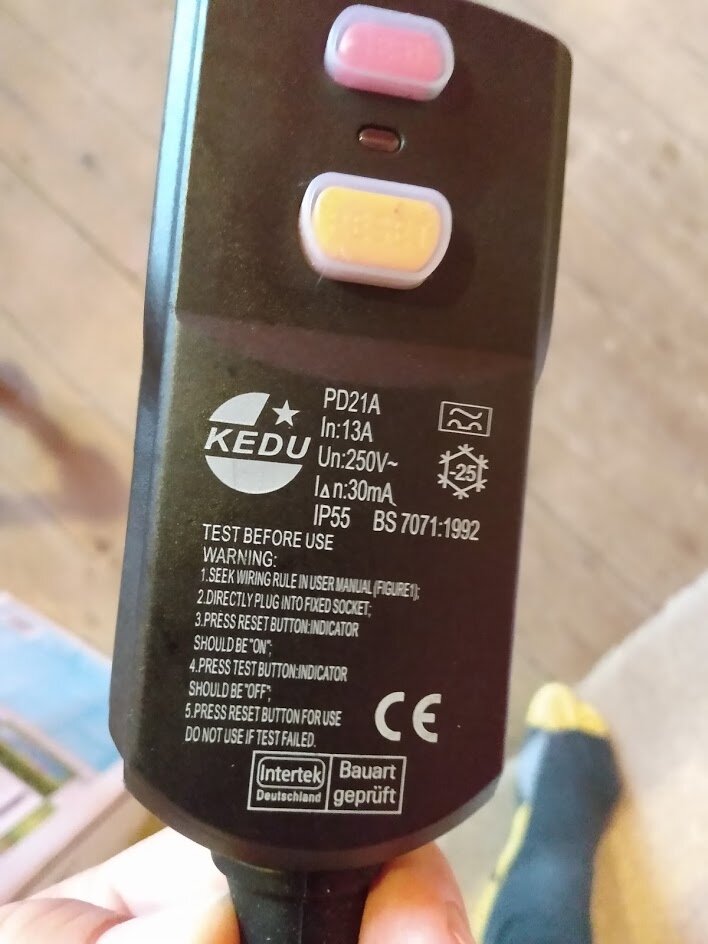

The 2.2w heater has a big plug with what I assume is a safety cutoff included
The filter pump has a European plug. Can I literally just cut this off and put on a standard UK plug, but without an earth? Why don't Europeans plus have earth?
That is an RCD on the heater and must not be removed. It is an important safety device should something go wrong with the heater.
The European one can safely be cut off and a standard 13A plug fitted with the correct rating fuse.
