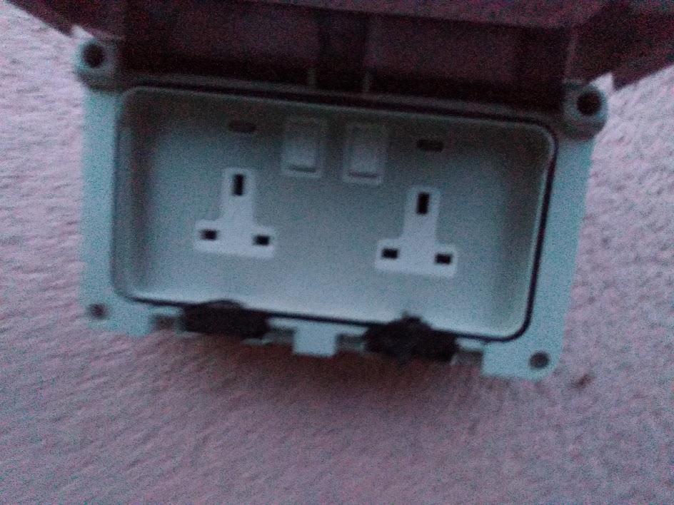

Pool guy said we really need a proper plug socket put in too, might as well get that done - will make cutting the grass easier too.

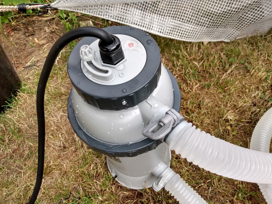

I've asked an electrician to quote to install a new outdoor socket. I'll probably just what I have for this year, ie. the simple heater + filter in the photos, but might upgrade to air source heat pump for next year, if supplies / prices get back to normal. Pool guy suggested buying all pool stuff in Jan/Feb, as this is when prices are lowest (not just high because of lockdown!).
Anyway, would I need anything different if I go air source heat pump, or will the same double rainproof socket on a stick be OK?
Far better than 2 standard extension leads. Make sure that the covers are securely closed to prevent water getting in and the source plug, i.e. the one you are plugging into the supply socket at the house end is actually indoors or you defeat the object of waterproof sockets.

My outdoor socket is watertight. I will only run this during the day when at home, or if I am forced back to the office, then I will probably run it at night. Cannot find any 2.5mm ones. With the existing the setup the first extension plug got warm, but not hot, and the socket not hot at all, and no extension cables hot. but will improve for more piece of mind.
Found this, 2.5mm, 20m
https://www.industrialextensionlead...y-13amp-25mm-cable-extension-lead-10586-p.asp
Does that look better?

This would be good but you would also need to use the enclosure box in your other post as the lid won't close on the socket because of the RCD on the heater.
So going for your 2.5mm extension lead with the enclosure box means you could plug the heater c/w RCD into the extension and weatherproof it by closing the box properly.

Plugged into existing external socket, with the weather cover closed. And should be good for now?
2.5mm orange flex, as commonly used for caravan hook-ups, is easily found. The orange colour also makes it more obvious when laid on grass.
Yes that will be fine but only as a temporary measure until your electrician installs a proper supply closer to the pool.
How's the heating up coming along? Notice any appreciable difference yet?
Not yet, only had it on for a few hours, then the kids got in. Didn't put the heater back on as forecast was for rain and thunderstorms for the next few days, although sunny at the moment! Will put it on when new waterproof cable arrives.
I assume OK to leave running all the time, but best to turn off remove if lightning expected? Or just leave it?
Yes you can leave it running but not while people are in the pool, (not sure why but that seems to be the instructions with most heaters). Keep your pump running at all times to keep the filtration working but you can turn them off overnight. If you leave your heater running all the time expect a Thank You card from the National Grid for boosting their profits. LOL
