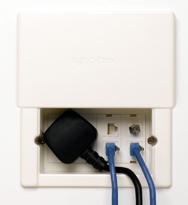

One of these in the ceiling, fully recessed, cover slides over to hide the sockets. All that's on show are the short cables between the outlet and the projector.
Outlets inside can be configured to whatever is required.
Still have no idea why concealing the equivalent of an extension lead in the ceiling and wall is even being considered.
