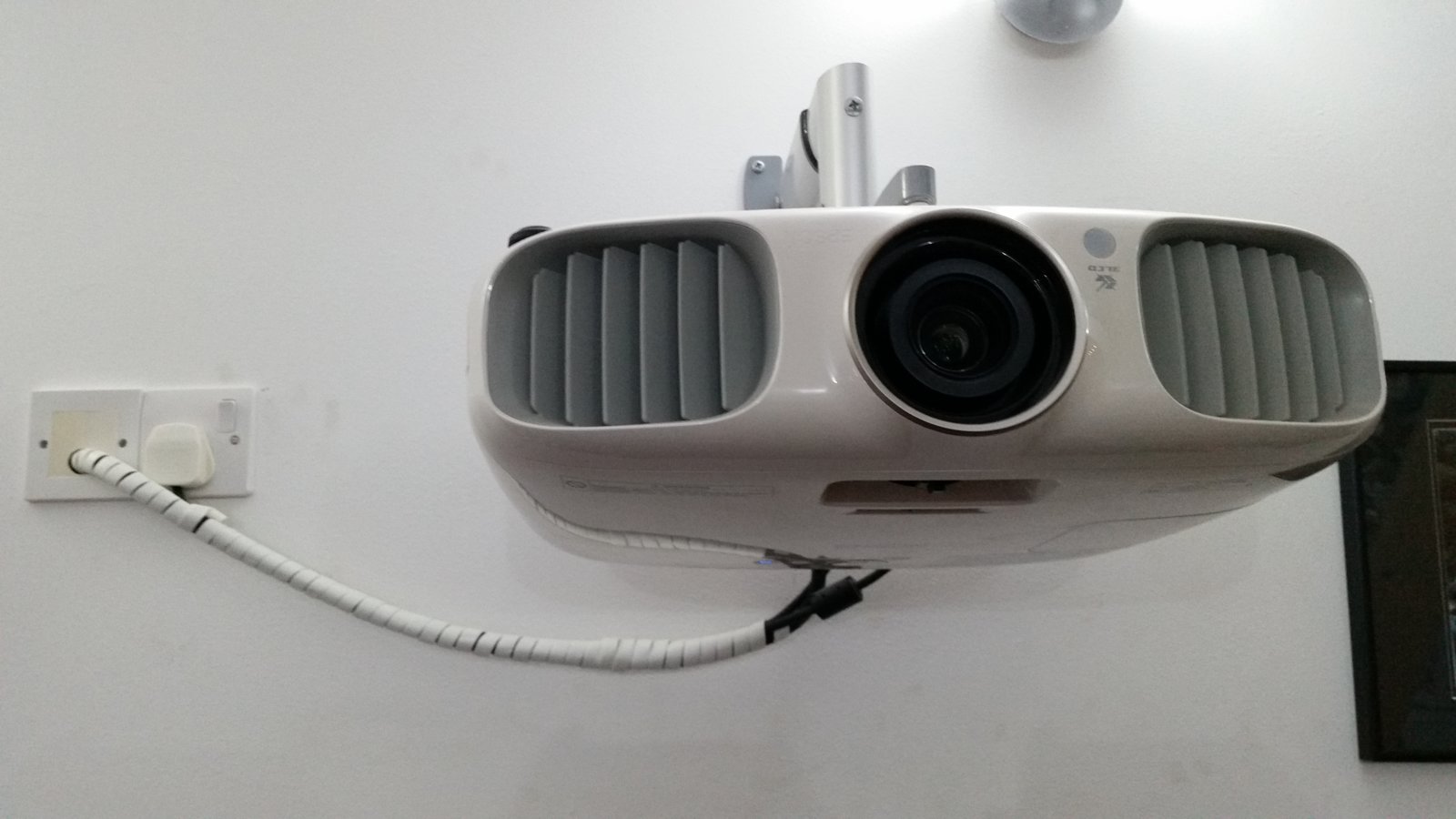

Power cables in the wall?

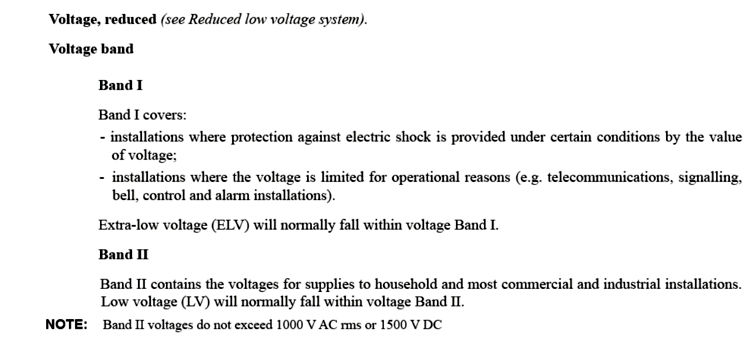

Once again you reveal how pointless it is for you to spout your nonsense when you have no idea what the wiring regulations say, because you have never had nor read a copy. Maybe time to stop posting, George?

"Band I is a TV broadcast band 48 to 68MHz, no longer used in Europe.
Band II is the FM broadcast band."
But totally irrelevant because you have not got the basic knowledge required to advise visitors to this site.
Still have no idea why concealing the equivalent of an extension lead in the ceiling and wall is even being considered.
@flameport purely to avoid the cost of getting an electrician in
Oh and I’ve seen some terrible interference from power cables so I’d considered putting two trunks in

For the record, I buried a conduit big enough for a video cable connector and a mains cable. Regarding band i/band ii, I took a view. This was that if the two cables were safe next to each other in the open (or safe enough to hold in the hand), then they were safe near each other in a two inch conduit. (Strictly speaking this does not meet regulations.) The installation has been buried in the plaster for 12 years without cracks appearing.
It seems logical to fit a socket. Anyone who can channel out the wall, should be able to fit that socket, and not need an electrician.
Not the prettiest, but I only had limited time.
@flameport I need a sparky to fit the wiring though? Even though I know what cable to use and how to spur from the existing ring?
What makes you think that? If you are competent to do it safely, you can do it.
