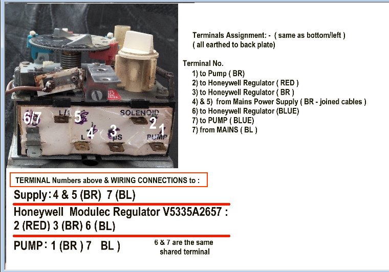

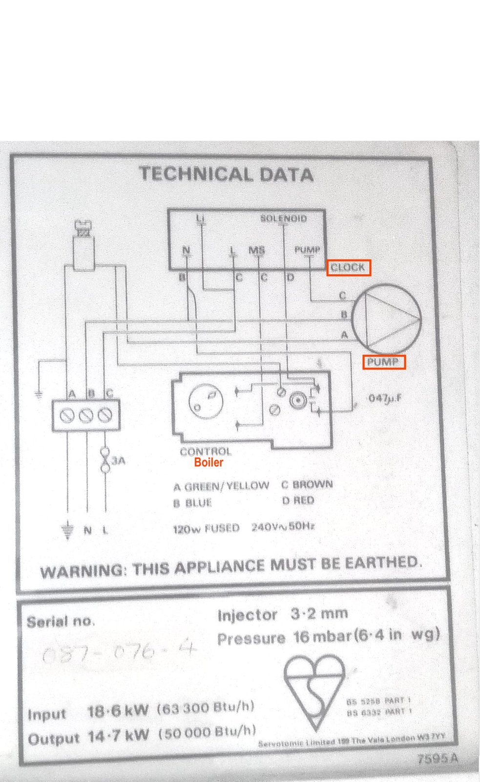

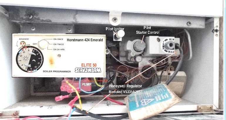

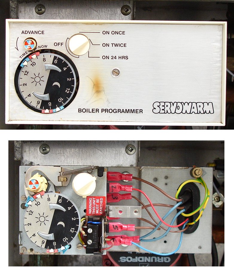

I wonder if anyone is able to help. I have a ServoWarm Elite 50 Boiler . it is over 30 years old , and is extremely reliable and has never really broken down. This is a simple hot water boiler system . with a pump and thermostat all in the housing. there is no room thermostat. so all it does is, send hot water around in a single circuit serving the emersion tank and central heating. The boiler thermostat is controlled by the max//min settings in the honeywell modulec unit and when hot enough the boiler turns off, and on again etc until the timer goes off. then the pump overrun continues for a little while.
My problem is, the programmer , a Horstmann 424 Emerald ( discontinued ) clock is faulty due to a slipping/worn plastic gear wheel and required manual switching. I need a replacement programmer .. This clock was a bespoke unit for this boiler, with a built in pump over run switch . Horstmann UK recommended a modern version , a 425 Coronet, but it has no pump overrun ( so they cannot advise on it ) . In which case I could just get any single switch timer/programmer for hot water only.. and connect some delay relay unit as pump overrun. Does anyone know if there is such a thing as an external relay / pump overrun unit that can be connected from a new programmer ( any of the above) to the pump?

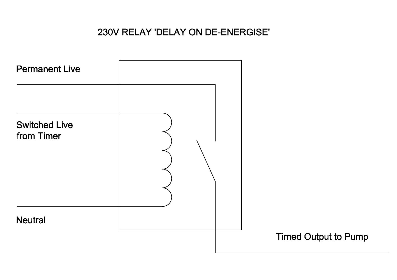

You could wire the switched output from the new timer that is live when the timer is 'on' to the coil of a suitably rated 'delay on de-energise' relay. Then wire the contact to a permanent live and the pump. That would keep the pump running for a preset time when the timer went off.

The timer is also controlling the boiler. So, if you were also connect a permanent live to 'C' it will also be connected to the boiler and keep it 'on' permanently. The thermostat could be wired to make use of its changeover contact to avoid this as below.
1. When the pipe is cool (the position shown in the diagram above) and the timer switches on the boiler, the pump will also start as the thermostat connects it to same switched live from the timer.
2. As the pipe heats up, the pipe thermostat contact will switch over, and the pump will now be connected to the permanent live.
3. The timer goes 'off' as does the boiler, but the pump will continue to run from the permanent live.
4. The pipe cools and the thermostat switches over back to the timeswitch live which is now 'off' and the pump stops.

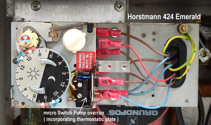

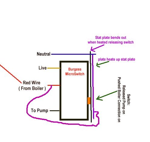

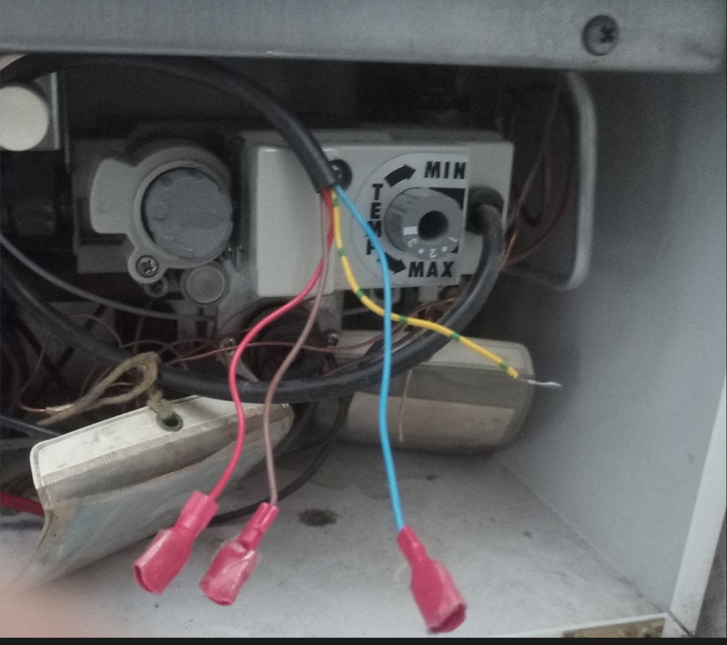

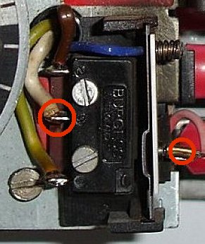

I am looking at the red wire in the cable from the boiler. it is connected to the "solenoid" terminal of the timer, and leads to the timers pump overrun microswitch unit ( see 2 red circles ) and joined to the 2nd red circle is on a strange ( i think), semi conducting plate that heats up the adjacent stat plate causing it to bow, and release the microswitch, and switching on the pump.
Is it fair to presume that this red wire will be dormant in the new configuration we are discussing

I agree with your reasoning, but without a wiring diagram I can't say for certain. These things were a bit before my time.

I wonder if the following images can be of any help to establish whether or not the Red wire from the boiler can be discarded in the new config. If so. then there are only 2 cables to consider: to Pump ( L-N-E ) and to Boiler ( L-N-E with Red sealed off )
The timer 'Solenoid' terminal is where the RED wire connects - I try to illustrate it in the 2nd hand drawn image . Basically this is only live to heat up the microswitch stat to release the switch and supply power to the pump. once switch is released the red wire connection is off. Why this red wire needs to come from the boiler puzzles me. ( probably low voltage? at a guess. dont know)

Mat29a do you have a pdf or link to the boilers installation & servicing instructions ?
[ too old to find on google I think. but please see technical data in my post above ]
does the boiler have an overheat device :?:
[ yes the boiler has overheat switch, you can see it in the overall image - a round black dome with a tiny red push switch that pops up if boiler overheats. Over heating would occur rarely when the pumper overrun cheap (£2) micro switch wears out once every 8 years or so. ]
Not seen one of them boilers for years,they always had the burn scorch mark on the timer fascia
[the Boiler is about 30yrs old. very simple and nothing to breakdown and never did. heats up water in one circuit to serve emersion tank & c/heating.
The timer plastic casing has scorch mark built up over the years due to heat from the built-in pump overrun stat plate. it is a small plate and gets very hot ... ]

No this is just like any normal mounted boiler. with timer and pump at the bottom.
This ebay unit is the same 424 Emerald model but it has no pump overrun. This boiler has a bespoke 424 emerald , same design but they added a clever pump over run with microswitch. So my replacement will need an external relay/overrun connection to the pump.
