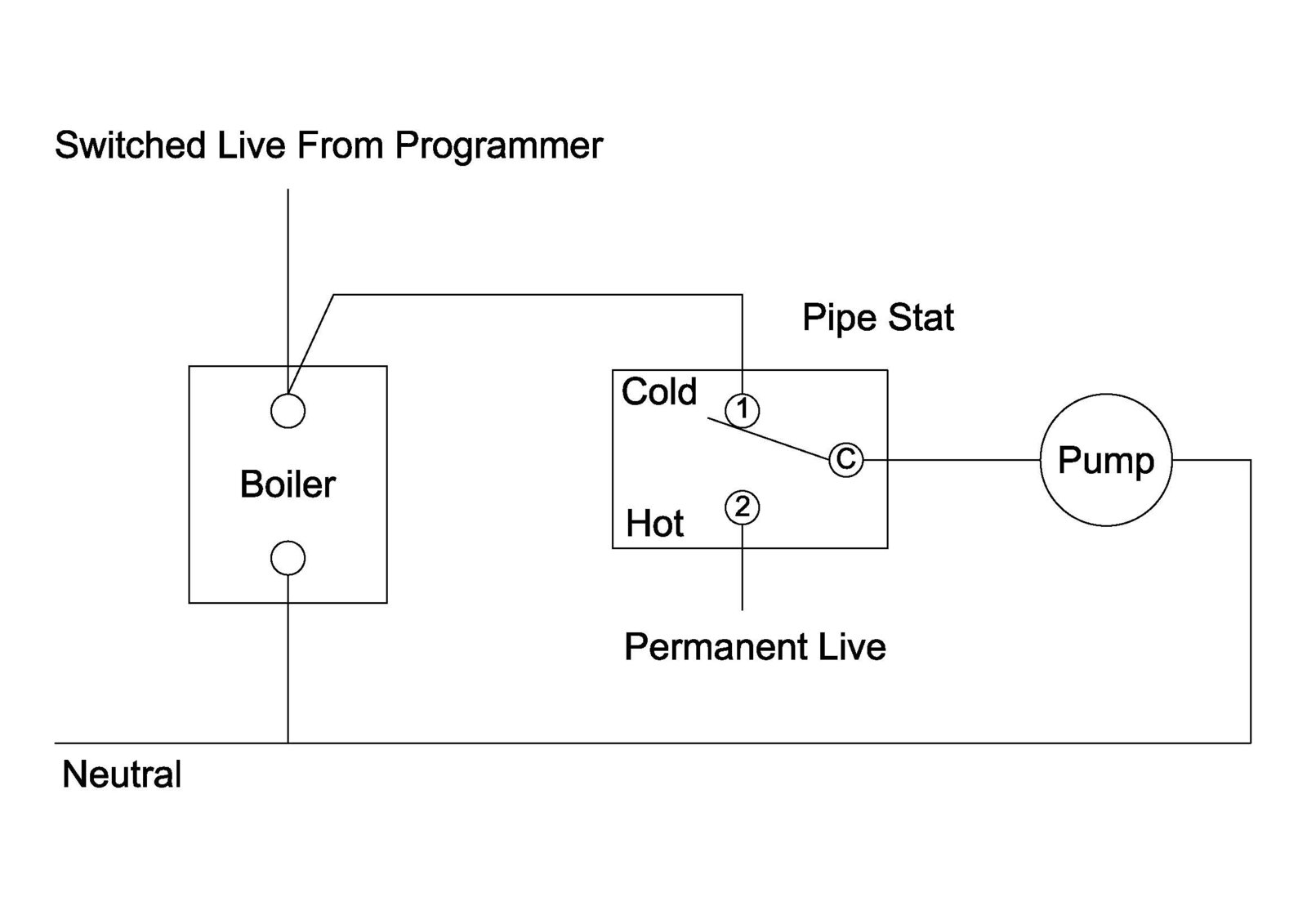

The timer is also controlling the boiler. So, if you were also connect a permanent live to 'C' it will also be connected to the boiler and keep it 'on' permanently. The thermostat could be wired to make use of its changeover contact to avoid this as below.
1. When the pipe is cool (the position shown in the diagram above) and the timer switches on the boiler, the pump will also start as the thermostat connects it to same switched live from the timer.
2. As the pipe heats up, the pipe thermostat contact will switch over, and the pump will now be connected to the permanent live.
3. The timer goes 'off' as does the boiler, but the pump will continue to run from the permanent live.
4. The pipe cools and the thermostat switches over back to the timeswitch live which is now 'off' and the pump stops.

Interestingly the pipe thermostat wiring diagram I posted earlier and your diagram of the "Burgess Switch" work in exactly the same way using a changeover contact to switch the pump between the 'boiler switched live' and a 'permanent live'. The only difference is that the microswitch has its own heating device that heats up with the boiler. The pipe thermostat uses a hot pipe heated by the boiler instead. The pipe thermostat should be fitted to the flow pipe just as it leaves the boiler.

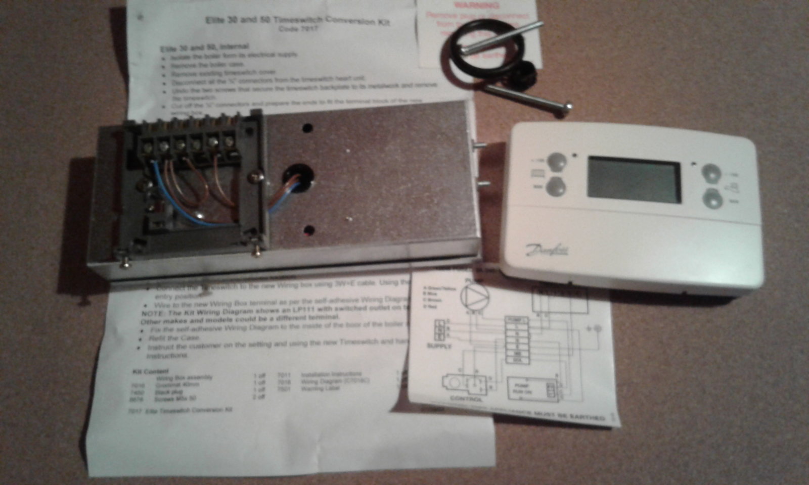

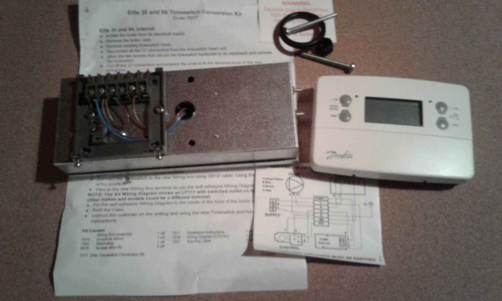

if your going to do a job do it right. this is what you need
Interesting. That uses a timer circuit to provide the pump overrun, so it's basically what was discussed earlier (before the pipe stat solution) but conveniently pre-wired and mounted in an enclosure for you. If the steel box has the same mountings as the existing timer then it would certainly make for an easy exchange.
But there's something a bit odd in that it is shown partnered with a dual channel Danfoss FP715 programmer...
..when the Horstmann it is designed to replace is only single channel, and the backplate wiring shown in the kit diagram and photo shows wiring for a single channel timeswitch (The wire loop between L and 1, and the single switching wire in terminal 3 are the clues) but it wouldn't be a Danfoss single channel model, as they use terminal 4 instead of terminal 3 that is used by some other makes.

Do you think ifcpat conversion kit suggestion is an attractive solution/option? . just I can't yet understand the images ifcpat kindly posted.
(I have quite slow thinker and in picking up things , so always have to struggle :( )

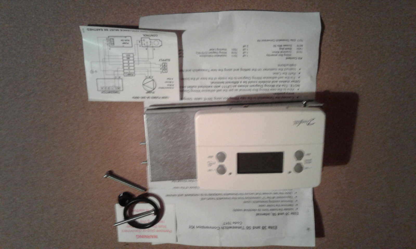

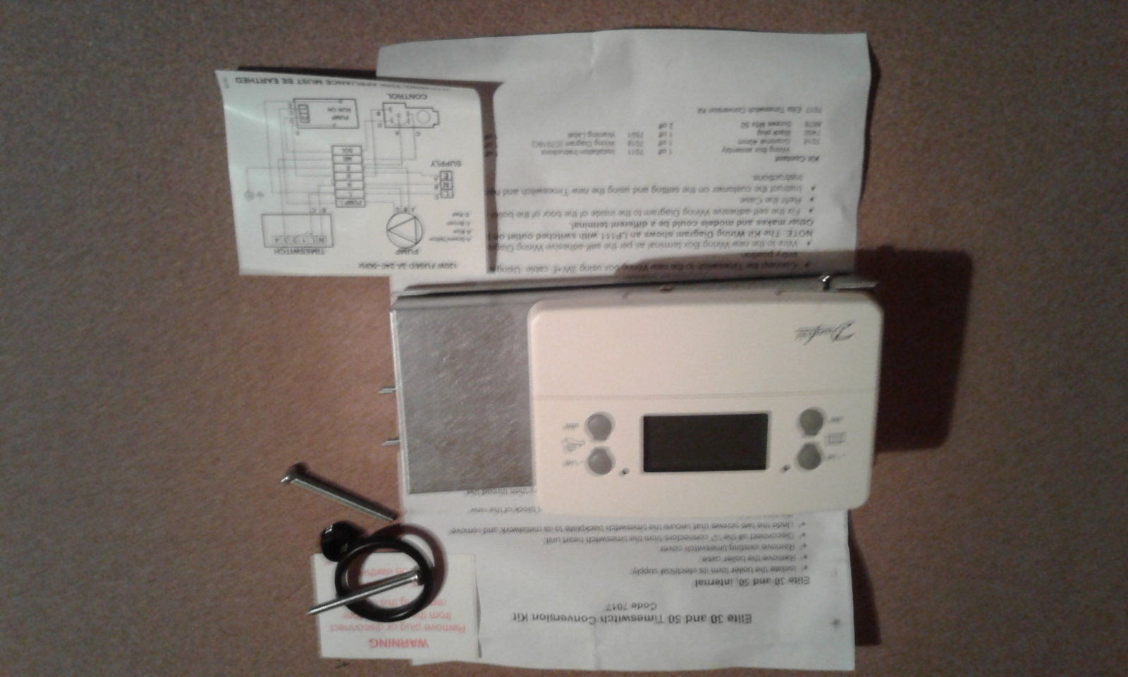

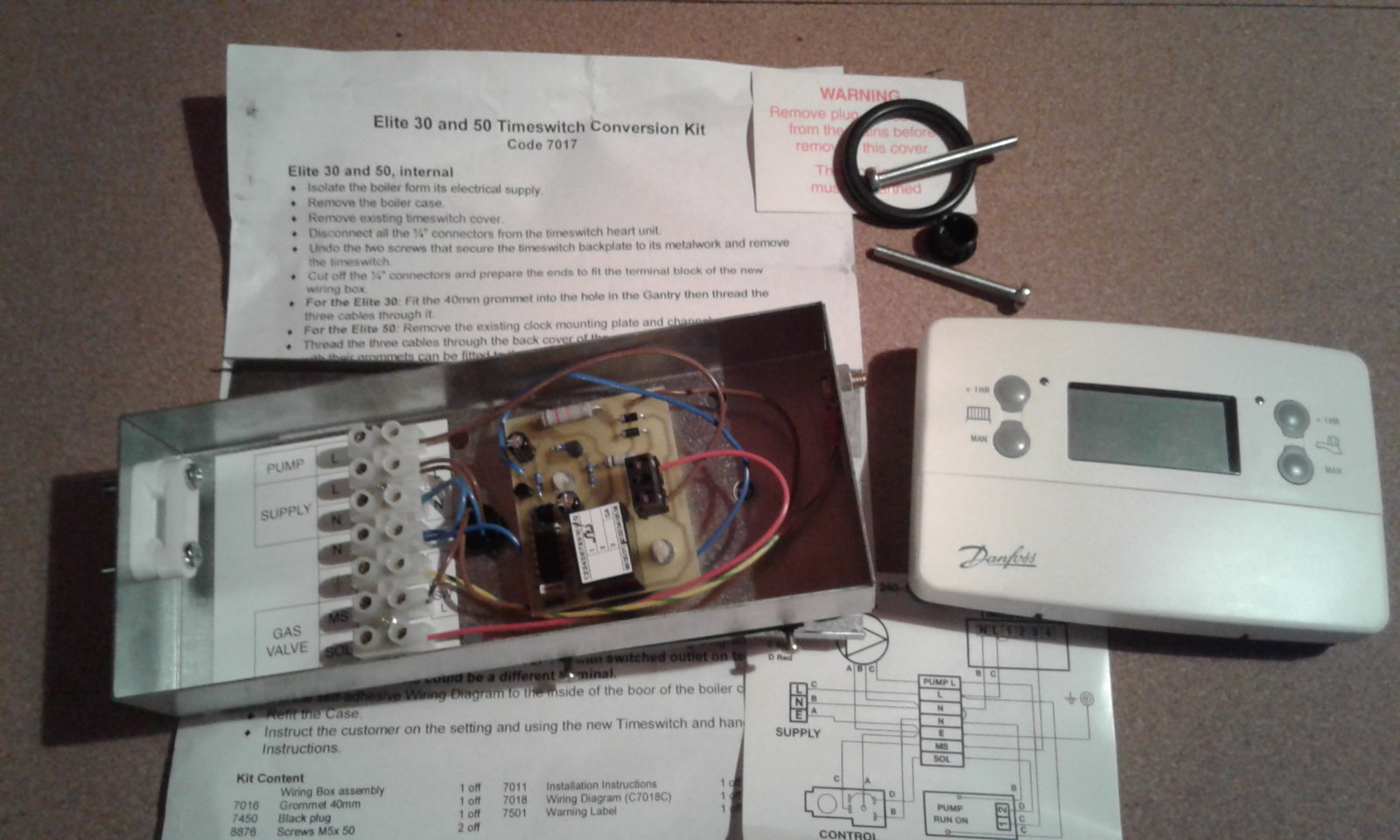

pics show elite 30 and 50 timeswitch conversion kit. simple it's a kit. I've shown it with danfoss programmer, as it was all I had to hand at the time but it is prewired for a danfoss ts715 timer, the kit as everything needed and was made by servowarm.

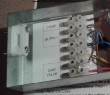

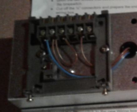

- studying the terminals - 1 - 7 from top:, if I elaborate as I see it ( I think)
I would like to use this merely as a pump over run relay.
(the boiler will be switched from timer so can I just ignore 5-7)?)
1) L out to pump
2) - 3) permanent L/N from mains ( or timer permanent L)
4) N out to Pump
most likely need 7) from boiler ... ( red wire )
Will it be Elite 30 or 50 in this case, ( I googled and cant seem to find this kit )
many thanks
There would be no point in doing that. The kit is designed to be installed as is as a straight swap and takes all the system requirements into account. If you start changing things, then you are back to square one and the question about the red wire.
If the kit comes without the timer, which I suspect from Ifcpat's post, that it does; then you can still use it with the Horstmann 424 Emerald you have ordered, which would be wired to the conversion kit terminals. L, N and MS.
The 30 & 50 will refer to the heat output of the boiler, 30,000 or 50,000 btu's but the literature states that the kit is suitable for both.
All of this assumes that you can still get one of course. I'm not even sure the Servowarm in question are still in business.

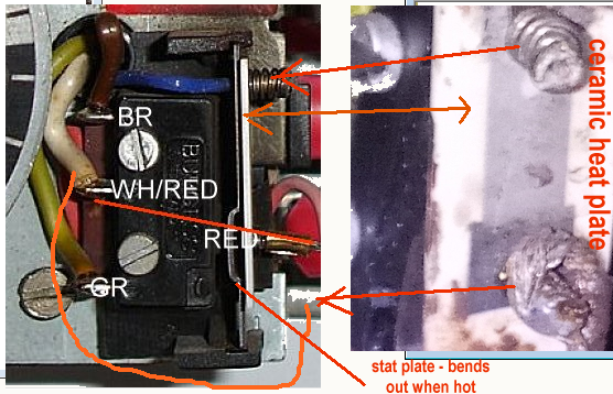

I could remove the simple overrun unit and transfer it to the new 424,
but it is so tatty ( broke then fixed it last time when replacing microswitch) , and not worth doing.
It may be possible to rebuild this unit, using the stat plate , but the ceramic plate will be a problem to find.

yes I have them to sell, but if you fit your horstman timer then you will no longer be able to close the front drop down cover. this boiler is obsolete, but I have every part you would ever need to keep it working for the next 20 years. the kit I pictured is part of what servowarm called a comfort pack, so your heating system could be updated to a y plan ie 3 port valve, timed dhw or heating. I can also supply replacement heat exchanger, gas valve, overheat stat, flow and return valves, flow and return valve service kits
Good point. Perhaps it would be possible to mount the timer outside of the boiler, and run a cable to it.
Ah. That would explain the two channel programmer then.
