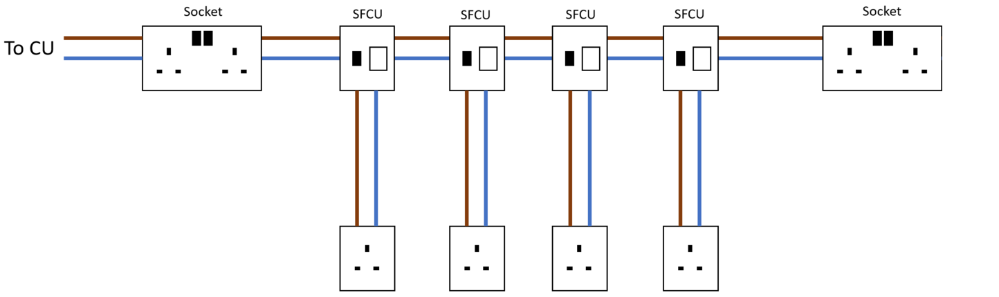

Wiring remote switched sockets for Kitchen appliances
With identical logic, the exchange could have been like this:
When wiring accessible switches for hidden kitchen appliance sockets into a radial
