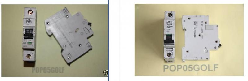

Need a picture of the CU.
It could be an older model with Type 1/ Type 2 MCB's.
1995 mk I think were the same profile at the time as Merlin gerin, as in the right hand photo
Not ideal but as the new schneider ones still fit the old Merlin gerin, then its likely the new schneider will also fit your board
They then changed to the ones in the left picture and have changed again since then i think
full
When did MK phase out the 3871s? I know the standard was withdrawn in 94 but if they didn't predate that by much it's possible that he's got 3871s
I have the LN59xx series of mcbs. (On the right) All 'B' models. It's being suggested to use 'c' if I can, 'cos they're motor rated?
Those in the RHS picture posted by rocky are rebadged Merlin Gerin/schneider C60 multi-9 breakers, while mix and match isn't desireable, when its just a case of badge engineering going on, its not the biggest sin in the book. Unfortunatly the C60 range is no longer current and has been replaced with IC60 (acti-9) [they state these as being compatable with the older ranges, but often look out of place]
The good news if you should be able to track down a multi-9 breaker in suitable rating, becuase there must have been hundreds of thousands fitted over the past twenty years, mostly in commericial and industrial environments, so C types of most ratings will be obtainable
