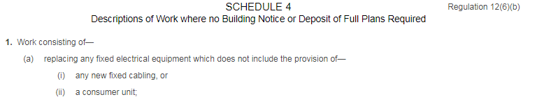

T...But I'd like to ask... is changing this MCB for one with a higher threshold notifiable in Wales?
Good question, and it really depends upon how one interprets the word "replace". In Wales, "replacing any fixed electrical equipment" is not notifiable provided that it does not involve the provision of new fixed cabling or a new CU. Whether 'replace' includes changing an MCB for one of different rating, I don't know. On the face of it, it would seem a little unlikely that they intended that one could change all the MCBs in a CU to ones of different ratings without notification, but I really don't know.

Schedule 4 which still applies in Wales is a list of the things which are NOT notifiable.
http://www.legislation.gov.uk/uksi/2010/2214/schedule/4/made
I would think it should be notifiable as it could make the installation less safe and non-compliant if testing is not possible because of lack of knowledge or equipment.
However, it must surely come under - or rather NOT come under and hence NOT be notifiable - the following:
Indeed so.

However, it must surely come under - or rather NOT come under and hence NOT be notifiable - the following:...
That's what I referred to - but, as I said, it really depends upon the (undefined) meaning of "replace". As above, I agree with you that one would have thought 'replacing' an OPD with one of higher rating 'should' be notifiable. As I also said, I do start wondering when I think about the fact that, using your argument, one could theoretically change all the OPDs in a CU for ones of different ratings without notification - and I find it hard to believe that whoever wrote it intended that such would not be notifiable...
... so, if changing multiple OPDs for ones of different ratings were (should be) notifiable, that might also apply to changing the rating of just one.
Yet again, a problem of absent definitions. I know we all scorn mention of 'like for like replacement' (since the rules don't mention that anywhere) - but this is one situation in which it would be nice to know whether or not they regard changing an OPD for one of different rating as being just a 'replacement'.
