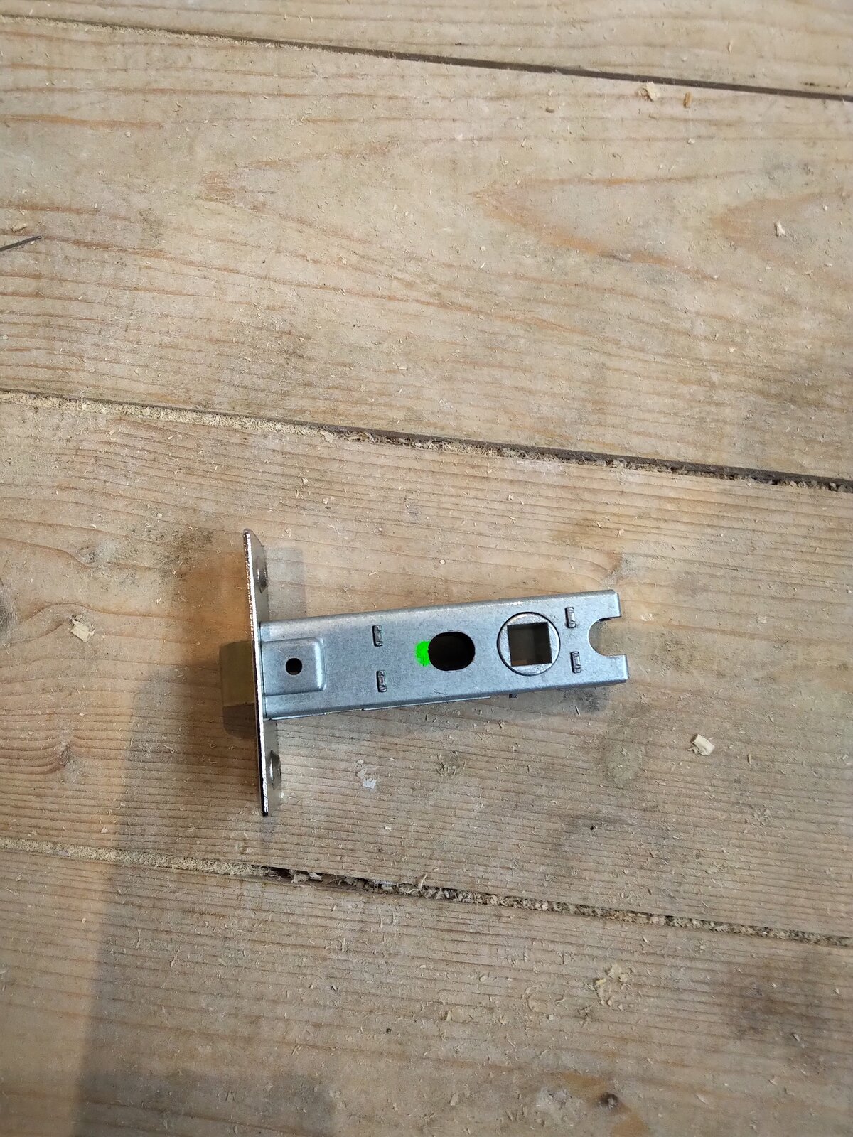

I recently fitted my first doors solo with no experience and found the latches and bolt through fixings on the handles tricky. I used ryobis latch jig then marked door using a square for the (big square bit bit between handles) at correct backset. Drilled from both sides to avoild splitting with a sharp spade bit.
The bolt through fixings i marked off the handles attached across the square bit. This meant i had to rework the latch sometimes with a dremmel. IMG_20201014_1039253.jpg
Im not really sure why this happened, but found a way to work around it so thought i would share

I don't understand this. Have I missed something?
You put a square on the edge of the door, aligned to the mark for the centre of the hole you drilled for the tubular latch
draw a line on the door face
measure from the door edge the distance of the two piercings in the latch (or hold it against the mark) and mark them
(you usually do this measuring and marking in one go, before you drill for the latch)
When you have a paper template, you might get away without using a square and measure, but I would, to check.
drill the hole furthest from the door edge. Insert the latch. Peer through the hole. Can you see the piercing? If no, you will have to enlarge or reposition your hole. if you move the hole, redraw your line to find the position for the other hole.
if you are using the sleeve-nuts, it does not matter if your hole is a bit big.
Then drill the second hole
Once you have fastened those two screws, and checked that the latch operates freely with no binding, you can drill the others.
Sounds very straightforward in theory, but in practice, when a doors been planed, not so much (for someone who hasn't done it before anyway) We got there in the end. Determined we would, as the builder who fitted our other internal doors just used screws on each side , and didn't do a very good job so the handles keep coming loose now and we got locked in the utility room because the spindle slid right through.
