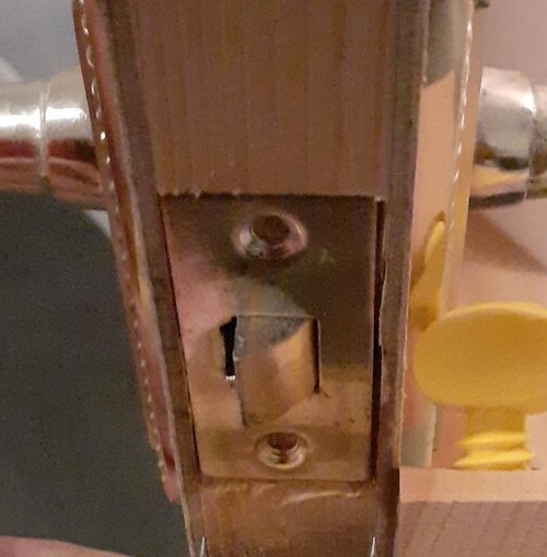

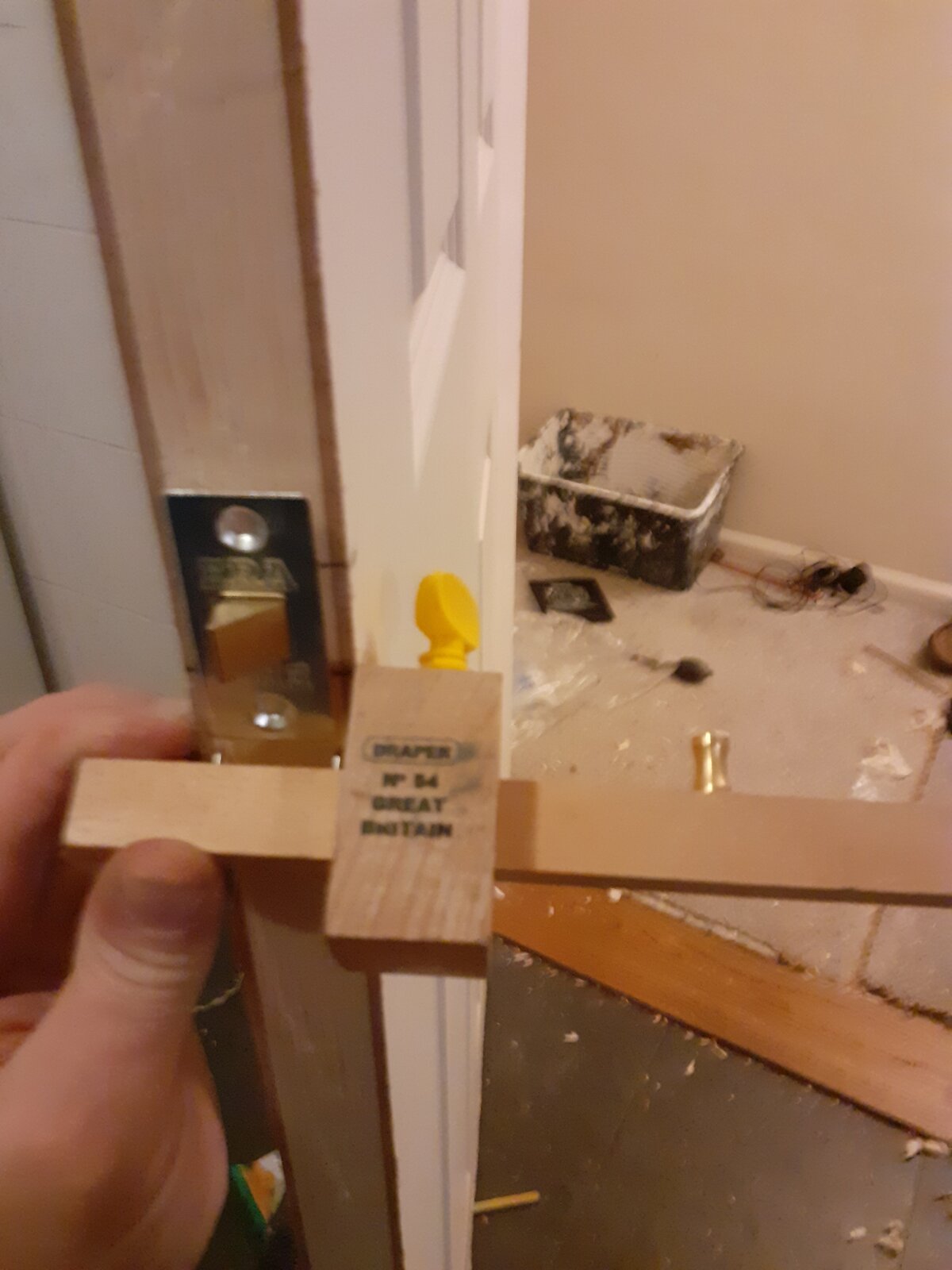

Had another go at using marking gauge on door plate. Think I got it wrong because plate wouldn't push in enough. Think chiseled out hole was too small (narrow).
Do you simply put plate on door and push two pins right into wood on either edge of plate (whilst it is held in centre )then tighten obviously block against side in right position the remove plate and mark vertical lines?

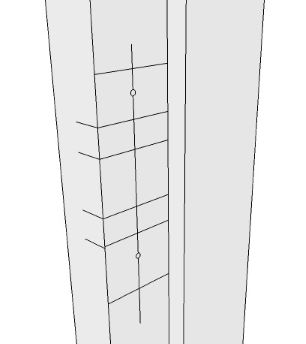

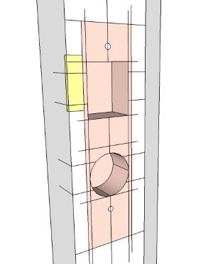

Next measure the door thickness, which is maybe 44mm (for an FD30) and do the same for the rebate it is going into (door frames and rebated casings only). The rebate should be about 1mm deeper than the thickness of the door. This is to allow for 1mm thickness of paint finish. If it isn't 1mm greater than the thickness of the door you have a problem qwhich will need to be dealt with a bit of adjustment (see below). As I said the lock should have been fixed in the middle of the door, so if you transfer the centre line of the lock drillings (i.e. the centre of the door) onto a combination square (directly transfer from the centre line marked on the door, never by setting to the numbers on the scale as this is a sure fire way to introduce errors). Yo can also mark the top and bottom screw hole positions as you do need to avoid these when cutting the recesses. That is then used to mark the centre line of the keep in the door frame/lining/casing. You should now have a set of markings which looks like this in the rebate:

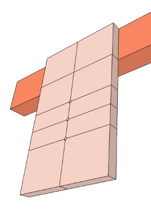

Now measure the width of the keep. This is often different to the width of the lock face plate. Add half the width of the keep to the measurement on your combi square, so if that measurement read as "23mm" and your keep (main body part) was 28mm wide, you'd add 14mm to the setting on the combi square, giving 37mm. Put a pencil line down the rebate. Do the same for the outside edge of the keep body, but subtract the hald width from the centyre line measurement (23mm - 14mm = 9mm) and again make a pencil mark. Measure the widths of the pockets at the rear of the keep and repeat the exercise for them:

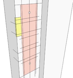

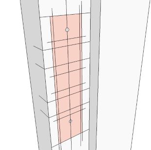

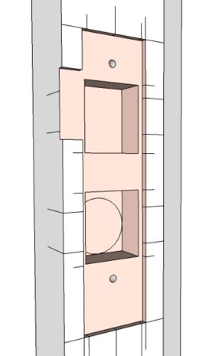

Next mark the top and bottom extents of the pockets on the rebate. The area in pink is the pocket you will need to recess to the thickness of the keep:

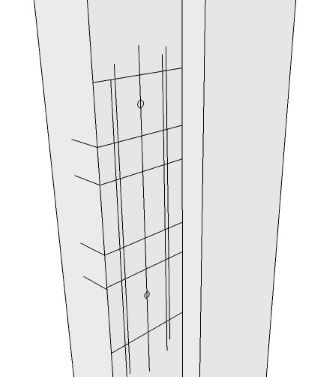

Then you need to mark out the position of the little bent protection tab if the keep has that, together with its' thickness. This is shown in yellow here:
What I tend to do then is drill out the waste with an appropriately-sized Forstner bit (in a tool kit you rarely need more then a couple TBH) then finish with a chisel, or in some cases I just take it out with a chisel (obviously you need to sever the fibres first, so your chisels need to be razor sharp - blunt doesn't hack it and will leave you with a result that ends up looking like you carved it out with a spoon):
Note: the lower one is shown drilled, the upper one is shown drilled and fully chiselled. This shouldn't be done using either an auger bit or a spade bit because on very deep keeps you coiuld end up coming out the back of the casing/lining. I've found some nice bits of Amazon with built-in depth stops which are ideal for the job.
Having chopped out the recesses the shallow recess for the keep is taken out with a sharp chisel - yet again you absolutely need to knife the lines neatly before using the chisel:
You can now offer in your keep and make any adjustments necessary to get it to sit flush, such as cha,mfering the leading edge of the tab recess, radiusing the corners wher the tab meets the main plate, etc.
Obviously this doesn't cover more awkward features such as radius-ended keeps, keeps with plastic box inserts (for the recesses), etc which add further layers of complexity, but I wouldn't expect you to even look at doing those.
As you can see there is almost as much work putting the keep in properly and neatly as there is in putting the lock in in the first case. A properly fitted keep will close with a nice "click" and you shouldn't be able to rattle the door once it has been painted

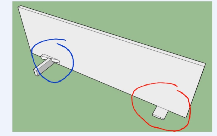

Quick question this - would two wedged pieces of wood be more stable than one u suggested in a picture I found u posted before in an old thread?
I made this awhile back
I circled the wedged piece on one colour and just baton in other colour.

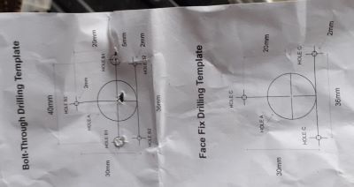

Third extra tip: Don't use tapes to measure out when you are fitting locks, other than for the obvious measurements, like the spindle height from the floor. This principle applies to almost all joinery work - never measure anything unless you have to, and use a rod or jig, etc to transfer measurements, Similarly don't depend on printed guides stuck on the door as they are prone to inaccuracy:

It's generally a waste of time making two of them. If you make the door block properly you just don't need two of them for lightweight domestic-size doors. If yours doesn't hold the door relatively firmly then you probably need to make it out of wider timber and a bit more carefully. At the end of the day it's a quick and dirty tool to make-up, as needs be, from a single offcut of wood which (in my case) will be tossed on the skip when I'm done with it. What it isn't is a joiner's bench

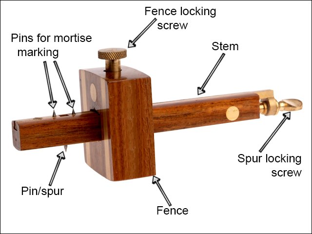

I understood what you said about not marking the keep side of door out with mortise gauge.
And using mortise gauge to find centre point of door not lining then drilled out latch hole, no problem.
Mortise gauge is great for that for me.

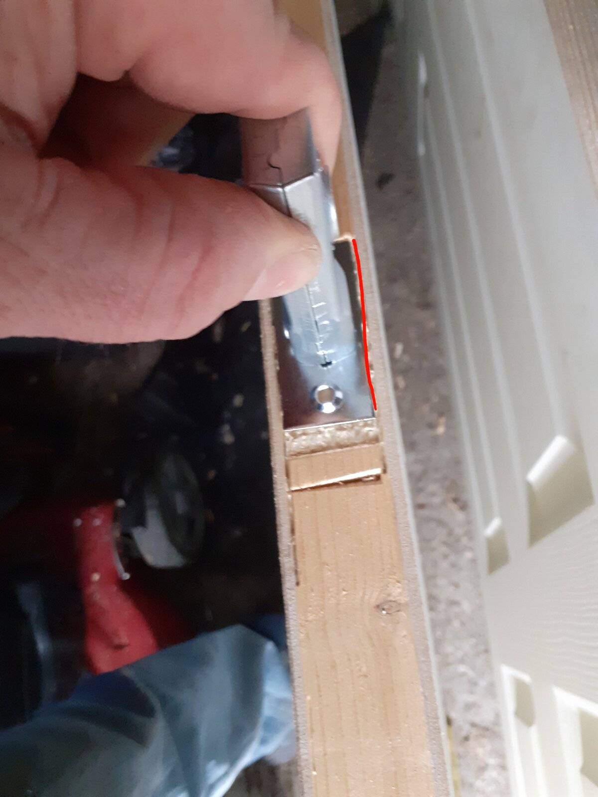

My issue was using two pins to mark out edges of face plate (part which goes into door that's called a faceplate isn't it?), i just tried again and it's too wide. The pins pushed either side of plate into door -score then when chiselled out (along vertical edges are TOO wide.
Maybe just use a sharp pencil then score with stanley safest for my abilities and not use both pins
The two outside edges of pin are marking it too
wide. Maybe technique? But I ain't got it. Red mark shows 1mm too thick.
Pix on scrap door shows it's too wide
If you set the points of the gauge directly from the lock face plate, how can they be too wide? You aren't putting the sides of the pins against the edges of the face plate, are you? Watch how this guy sets a mortise gauge from a chisel at about 0:17 - same principle only he's using a chisel and not a lock face plate, but otherwise it's the same
Note that he doesn't measure the width of the chisel or the width of the wood - neither is needed
Got it. Yeah I was doing that.
His words 'VERY TIP OF PINS on either side of chisel' . I was pushing them into the wood either side if lock/latch plate therefore giving myself too wide a mark.
