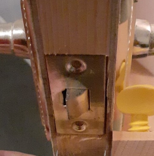

Do you ALWAYS score marking gauges' Mark's with a Stanley before chiselling? I guess they're too light to chisel straight from

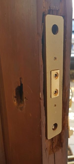

Yes, because if you don't you risk ending up with a recess which looks like one of these, or worse (from my rogues gallery):
(recognise the top one?) All as rough as a bear's arriss (and the bottom one was from an American lock fitting web site!). The recess is supposed to be neat with straight edges and no broken/smashed fibres.

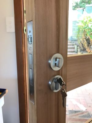

This is how neat they should be:
Wood has grain. For cuts across the grain it is highly advisable to sever the fibres before starting to chop out a recess or you'll end up with an unholy mess. For the sides if you knife the line (no, NOT freehand) or put the chisel on it and give it a tap to start it (which is why you have a wide chisel in your kit) it helps keep the sides straight at the surface. The idea is to do the job neatly - not bodge it and scarper....

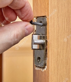

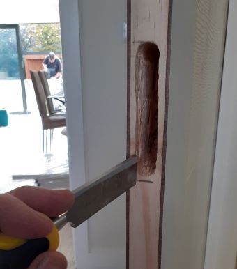

Oh yes, and if you try doing this:
without cutting across the grain first at that pencil line you'll like as not split the door.

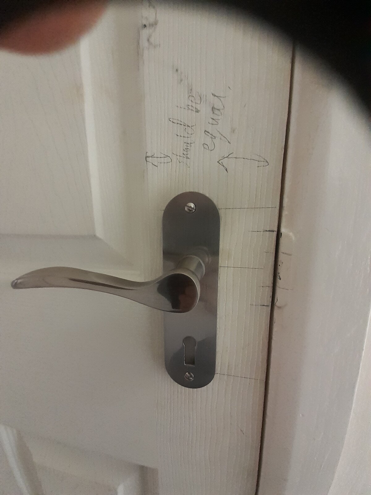

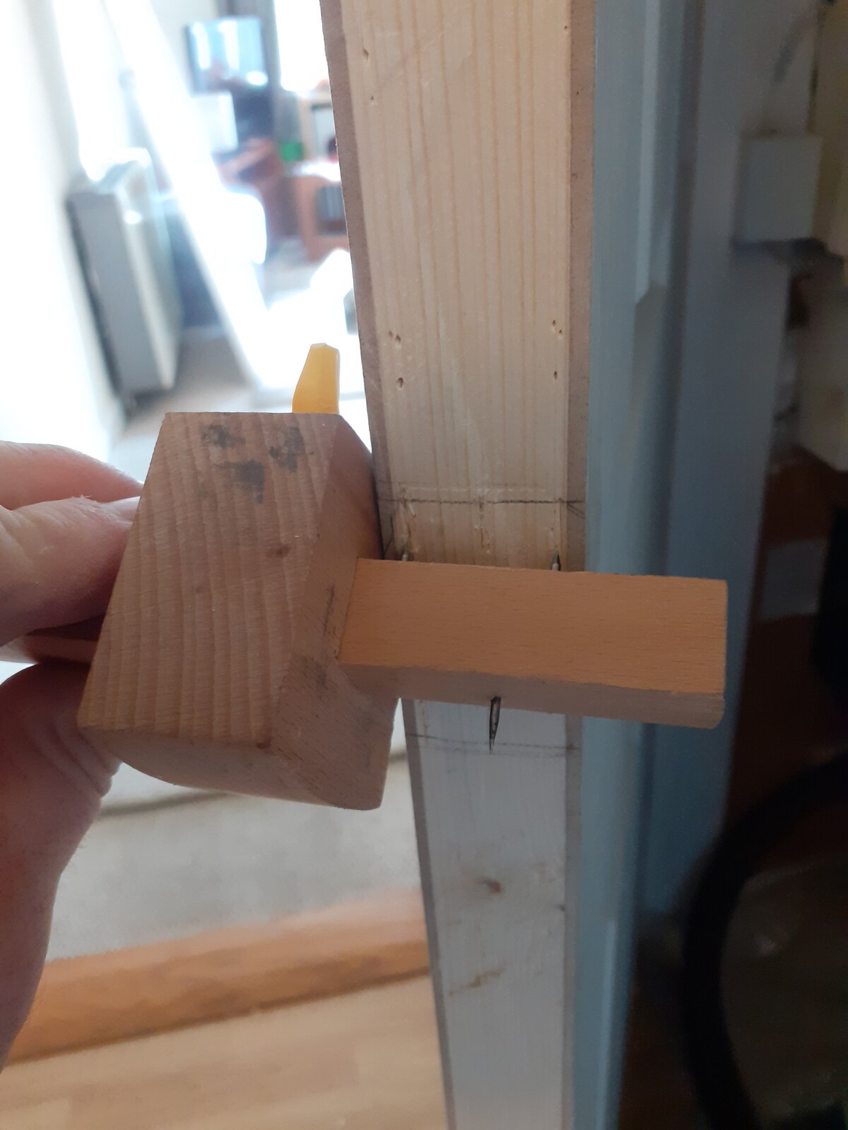

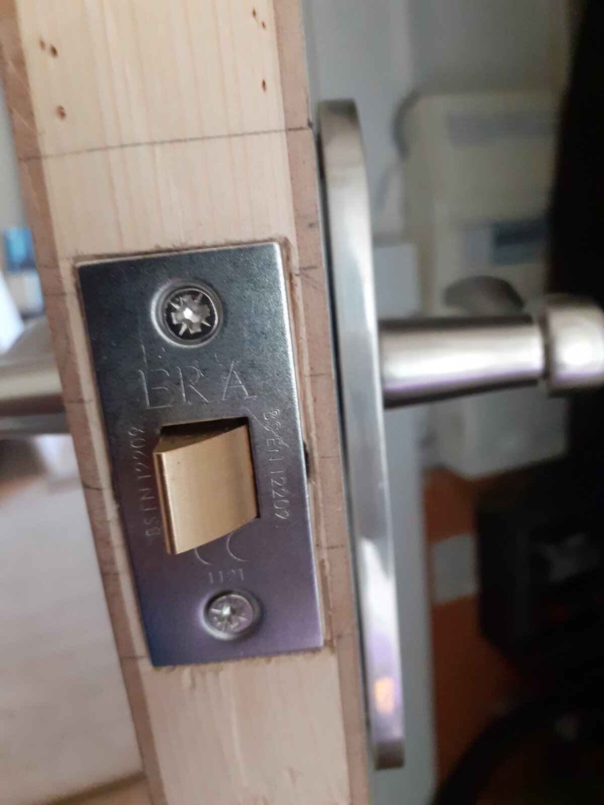

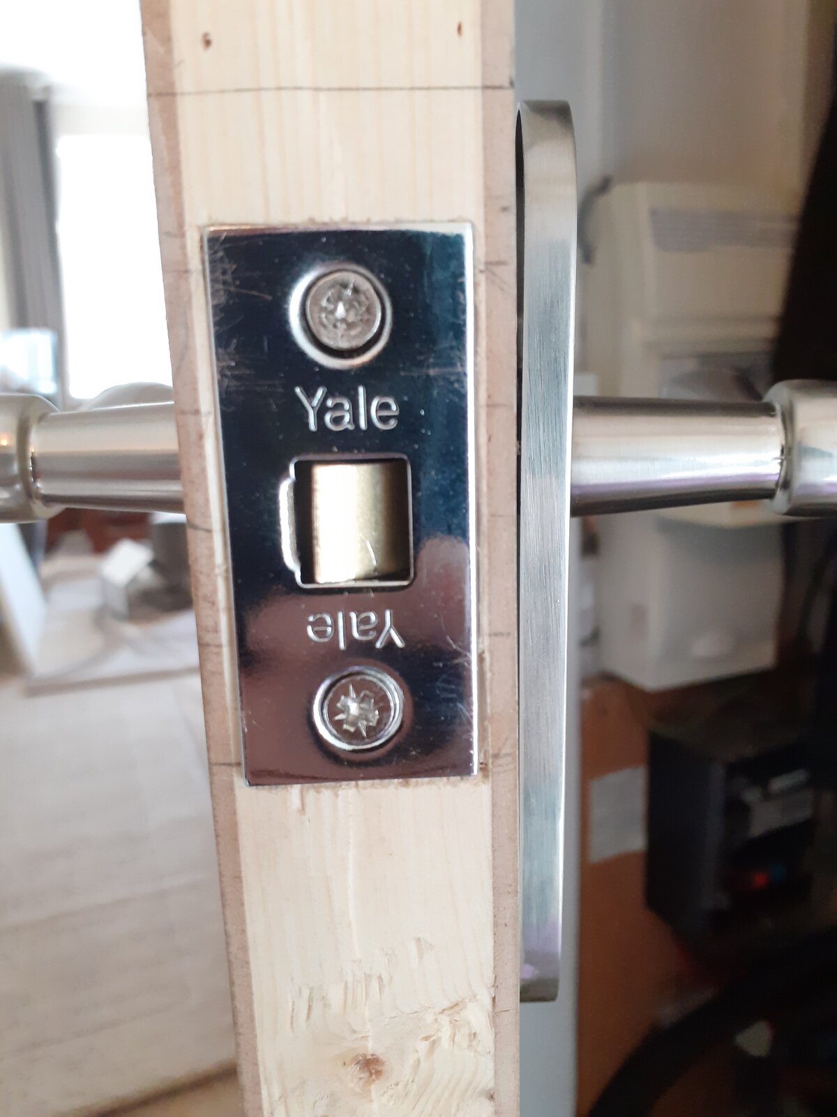

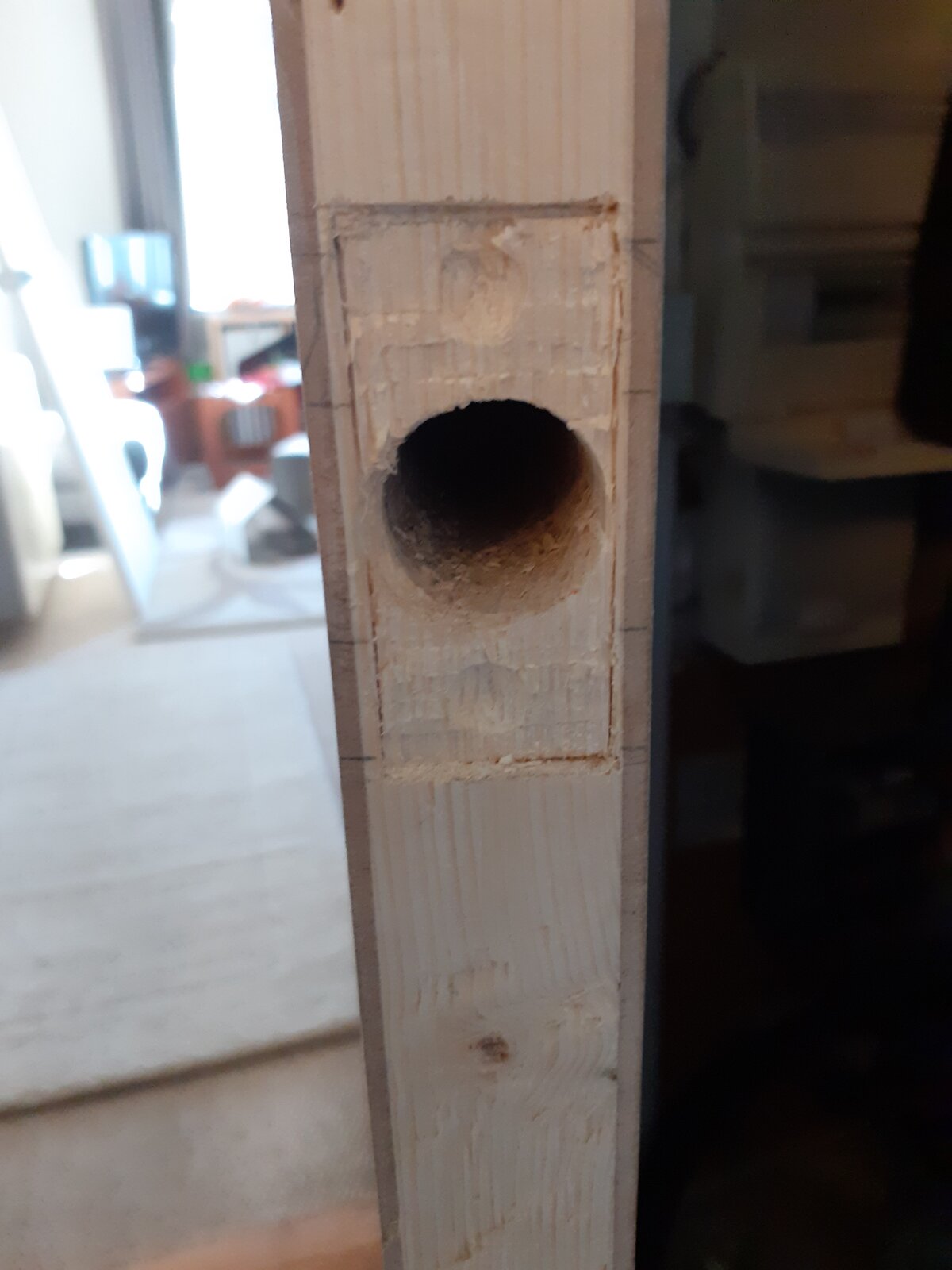

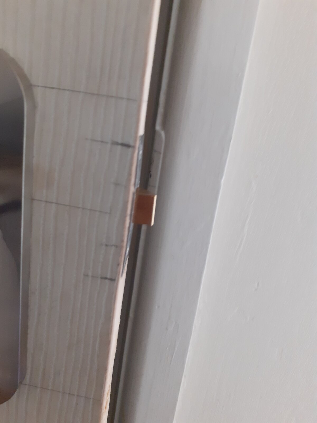

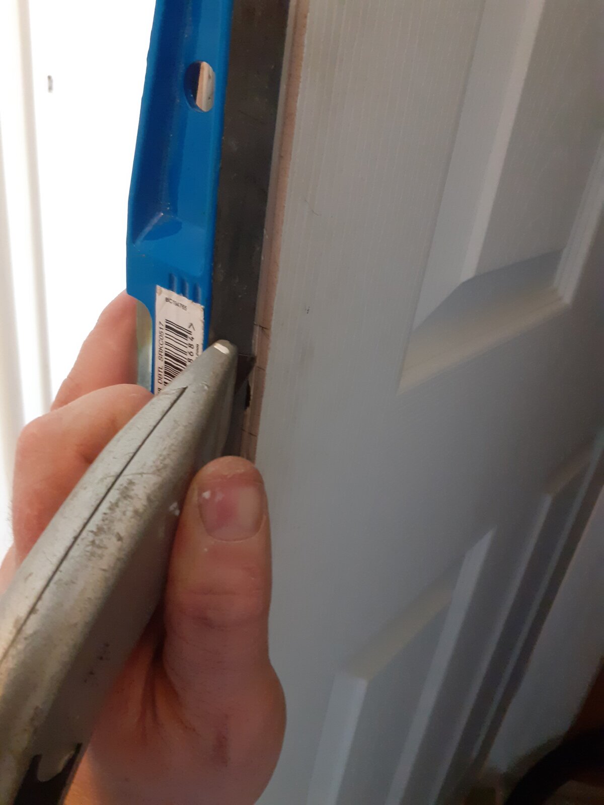

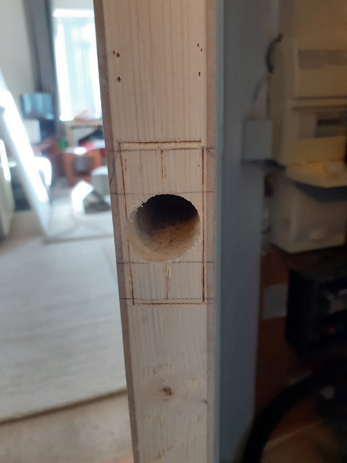

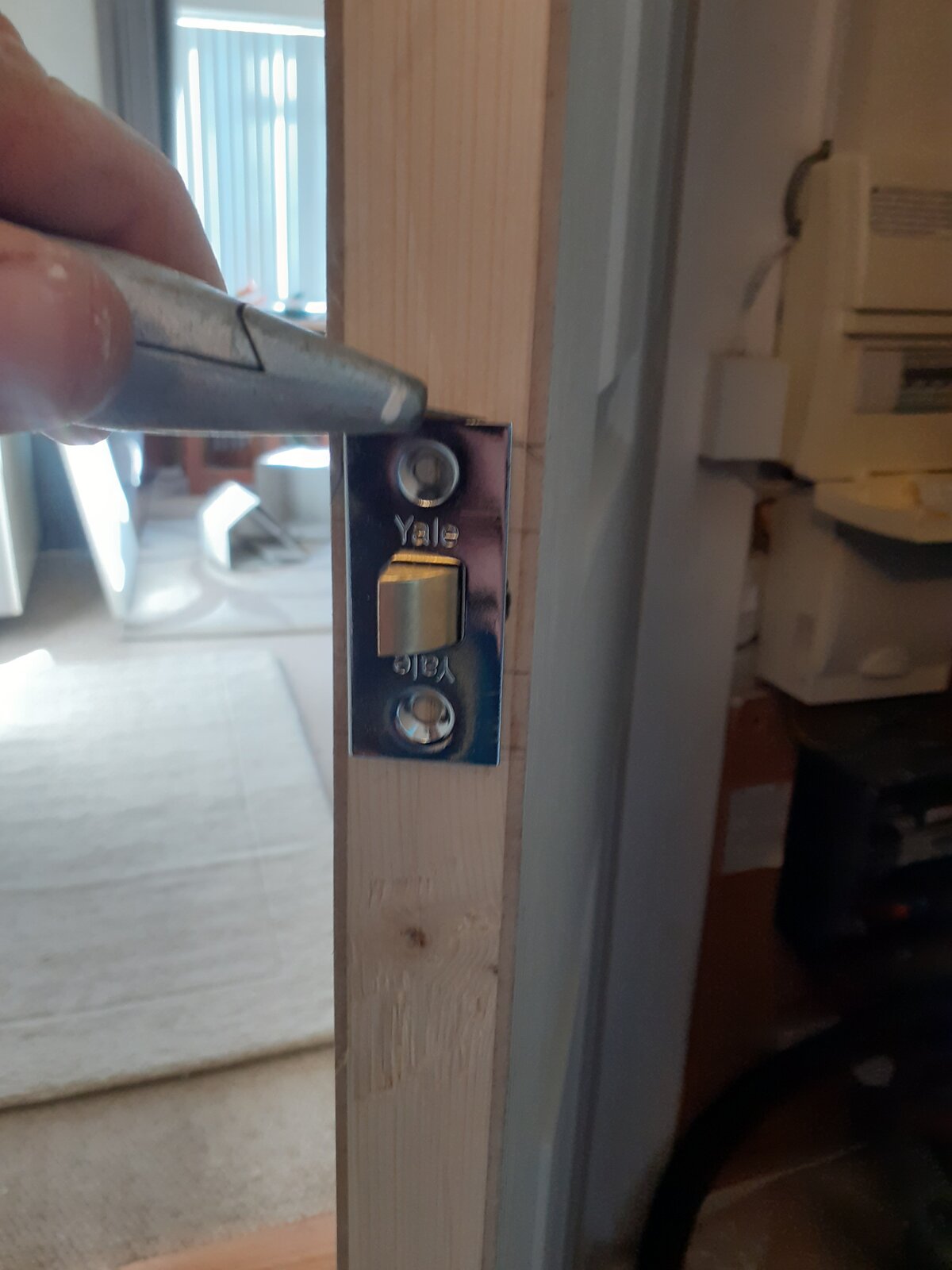

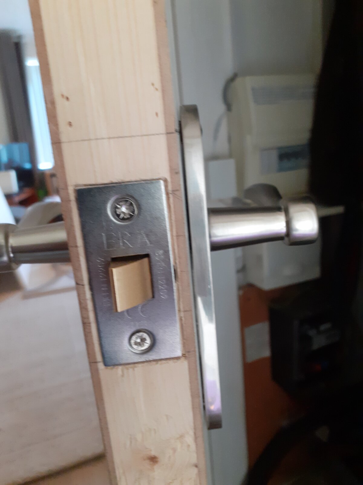

Did another door in my flat. Apparently I'm a millionaire according to one poster, my flat is in Mayfair.
Anyway, I used marking gauge for centre and edge of face plate think fence on gauge wasnt at 90 degrees perfectly so it wasnt marked perfectly.
Centre was actually a bit out and I didnt drill central tried to redrill with spade to left a bit when realised I was off centre and pulling it to left while drilling but was tricky anyway my main point was getting edges good on faceplate. I scored the top of plate with Stanley, using top edge of faceplate and marking gauge for verticals then scored with knife then chiselled top and bottom to severe the grain (think wasn't doing this previously) then chiselled out. Think it's an improvement.
Also noticed it's a narrower door and think I needed a 64mm not 76mm latch as it's not central in panel.
