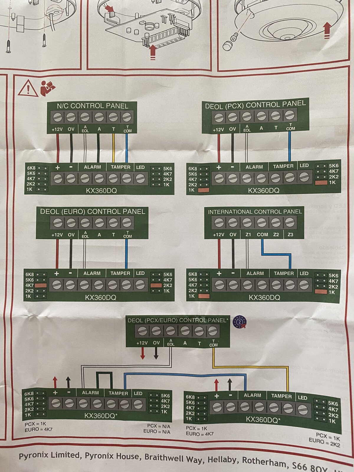

How do want to wire pir?

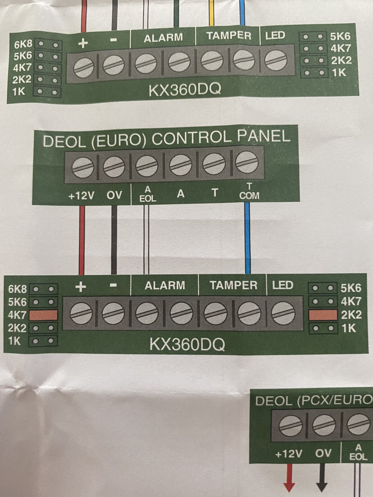

Jumpers off for traditional wiring or Jumpers on for EOL 4k7 & 2k2
This is a picture of the options listed on the instructions and I'm going to post a picture of the option I have used which is showing a fault.
That's the correct wiring diagram for EOL
wire as that and check jumpers are on 4k7 and 2k2

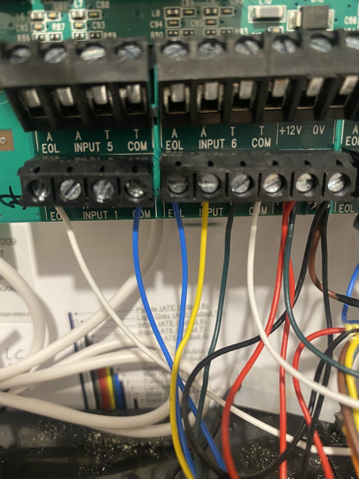

Mmm... So can I place the red and black to Auxiliary 12v power on the panel as I didn't know which connections I would put the red and black on the board as they are marked (Input 1) A and T?
Just for your reference, the keypad says 'Tamper on Input' if that helps?
On your control panel you have +12v & Ov
These are the power terminals for the detectors.
A A & T T are the zone connections
So
A EOL and T com are the terminals for the EOL connection from the pir
Keypad display is telling me not wired correctly.
Post photo of control panel wiring
It's input 1 i'm using, input 2 is the door contact from earlier.
That looks correct.

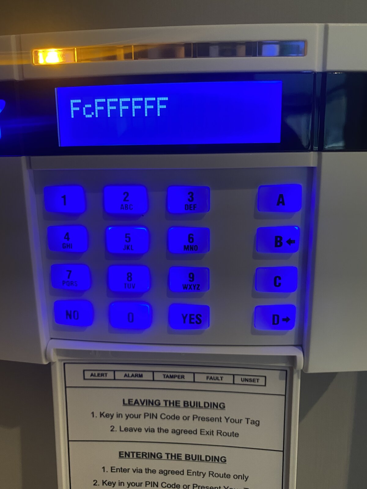

Post photo of keypad display
If all çccccccc then OK
If occccccc then issue
