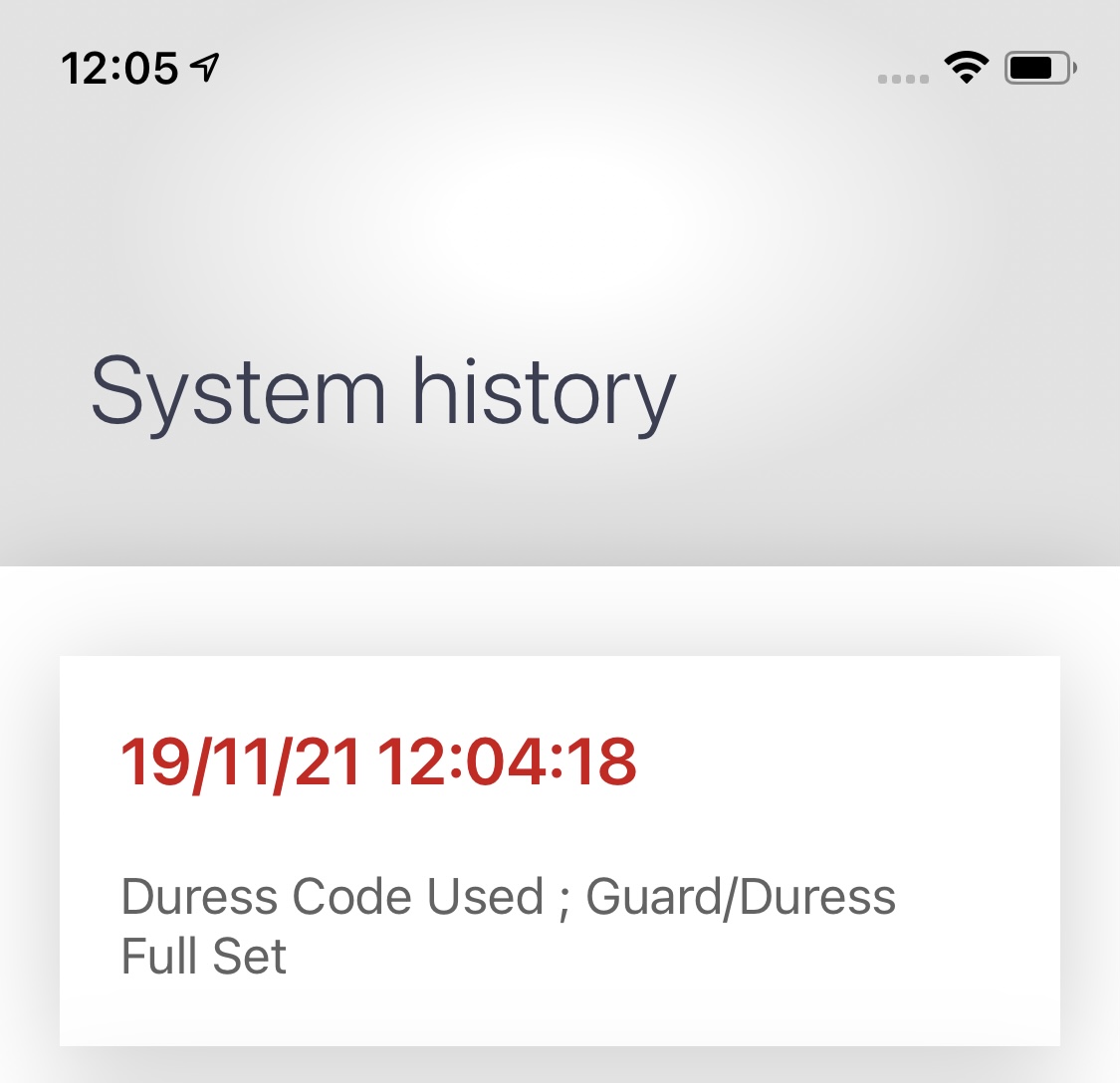

I think I have solved that. I had it set to number 5(Tamper) instead of 6(Intruder).
When I turn the alarm off I receive this message (see picture from app). ?
Think you need to go back to basics and sort one problem first.
Duress code has nothing to do with zone input settings.
Put links in spare zones as suggested, then post picture of diagnostics on keypad this should then the f's to con un used zones.

Yes, I have everything now working. Only last thing seems to be codes. I need to enter (end user) code, and change Engineer code along with Master Manager code.
I have actually cleared the end user code and now I can't turn it on?
sorry, yes, the master code works. Need to enter new user code and replace the other code so there not factory.
