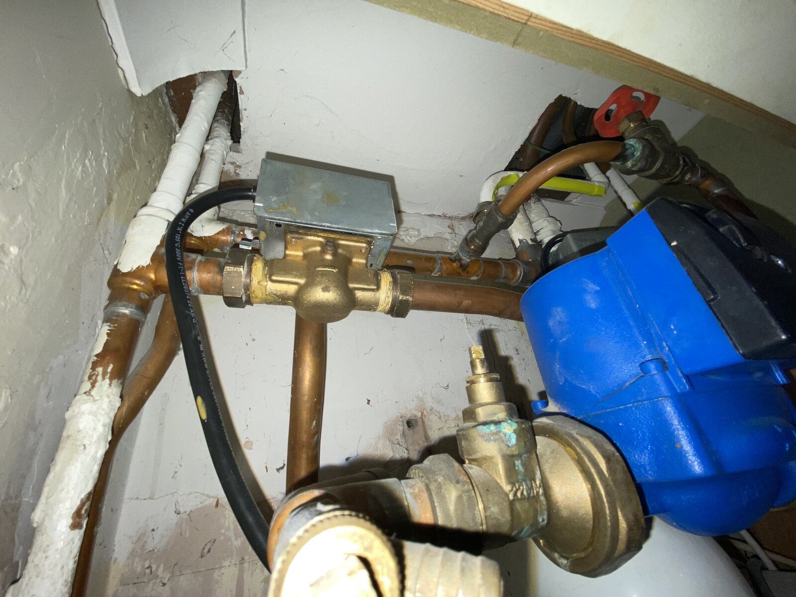

The boiler is a potterton suprema 80L. I’ve gone through the manual online and don’t see any reference to a bypass valve but maybe those familiar with the boiler will know better
81456E3F-A754-4767-913B-6EF615700A70.png The boiler is a potterton suprema 80L. I’ve gone through the manual online and don’t see any reference to a bypass valve but maybe those familiar with the boiler will know better

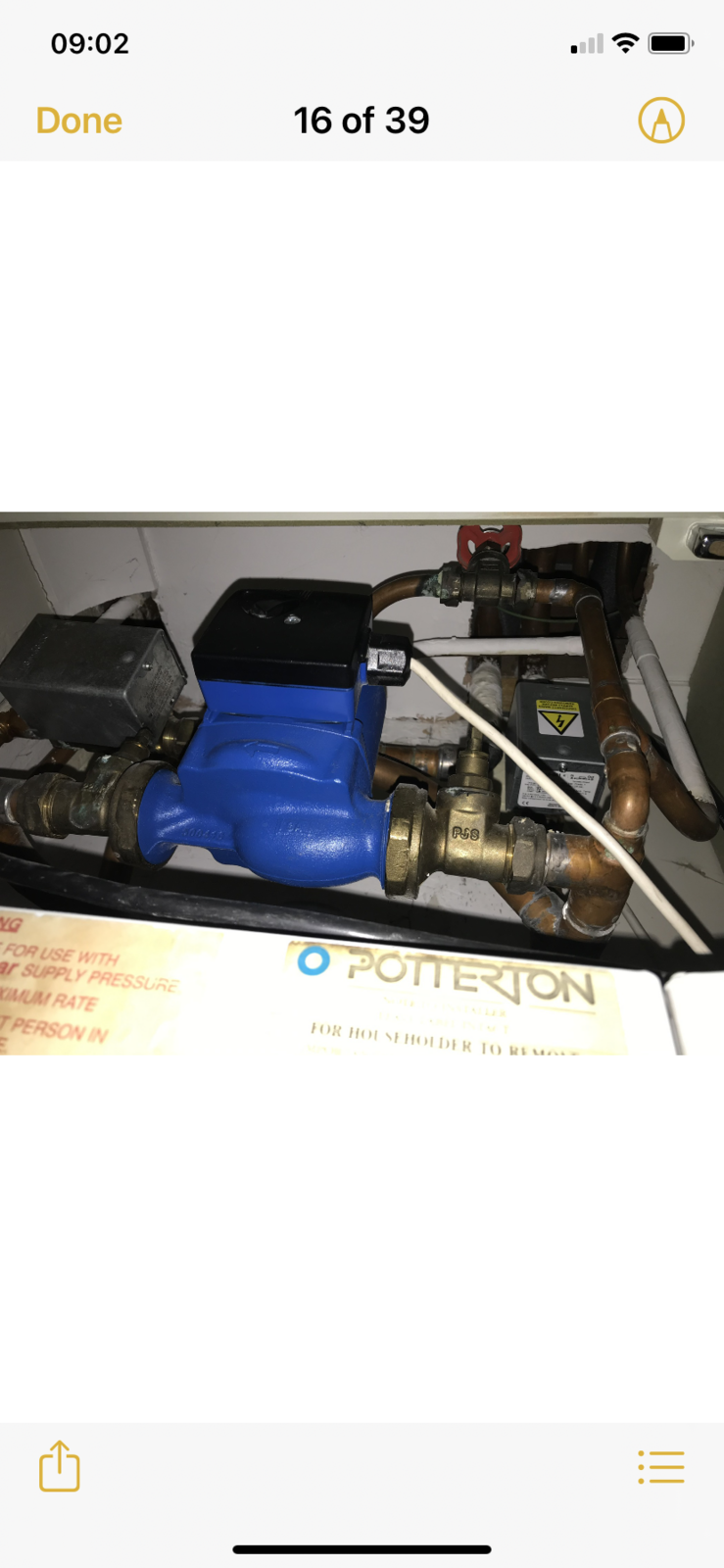

Madrab. As you will see other than being a cramped space with the red gate valve in question as you predicted, the pump as others have noted on a previous post, is on the return circuit And that the pump is at the wrong angle …
OK, it's a Suprima 80L? That's an oldy but goldy regular (Heat only)boiler. It won't have an internal bypass hence the valve. My goodness they haven't half shoehorned all that in have they. That's a bit of a servicing mare by the looks of it.
Not good for the pump shaft to be vertical, premature bearing wear etc but lots are installed horizontally for space reasons or it's under the floor. All it needs though is the pump twisted 90Deg so the shaft is still horizontal.
Yes, that valve looks like a bypass. Pump on the return, not really that much of an issue, pump positioning is more critical in an open vented system in relation to the feed and vent rather than where on the system it is actually placed.
All that being said, still need to understand where abouts the rads that heat up when the HW is on, are piped into the circuit.
Looking at that though, no reason the rads couldn't be moved and ideally change the gate valve for an ABV in place of the gate valve.

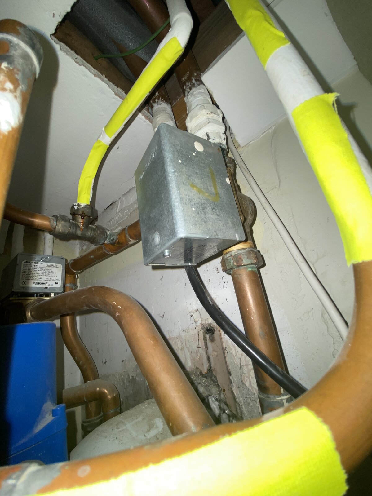

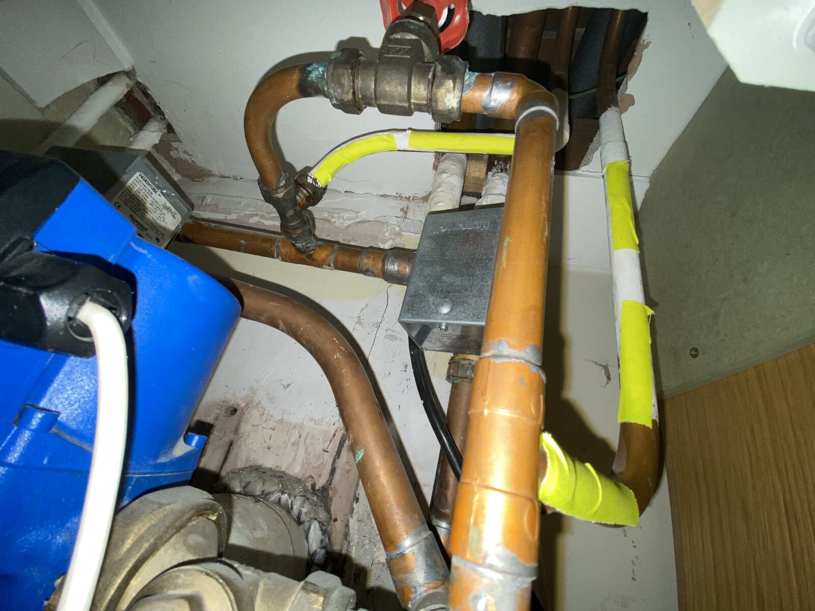

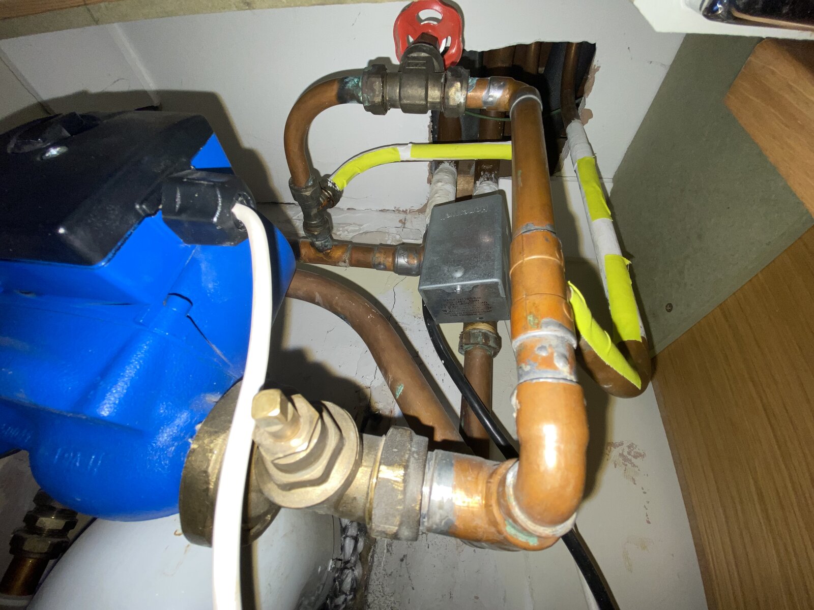

Thanks Madrab. I’ll put a bit of hi viz tape on the two pipes in question and upload another photo
Hope this shows it much clearer than I can explain it … hopefully it lets you see the two pipes in question that go soley to the bathroom rad causing the issue in question

It’s either piped that way or cylinder return isn’t last tee before boiler and reverse circulation is taking place.
Easy to determine.
Jeff, it’s piped to that one rad via those two highlighted pipes as all the others are on the main CH loop beyond the zone valves.
Not much room above the boiler but I’m guessing if I could somehow Tee off the main CH circuit into those pipes feeding that one rad that ‘should’ solve it ?
You would need to take the flow pipe (see which one heats up first from cold), probably the top one, to the rad and then tee it into the flow after the CH 2 port valve. The return could possibly stay where it is, depending on how close the main return from the HW cylinder is (reverse circulation). It will also need balanced to ensure it doesn't upset the flow to the other rads on the CH circuit.
