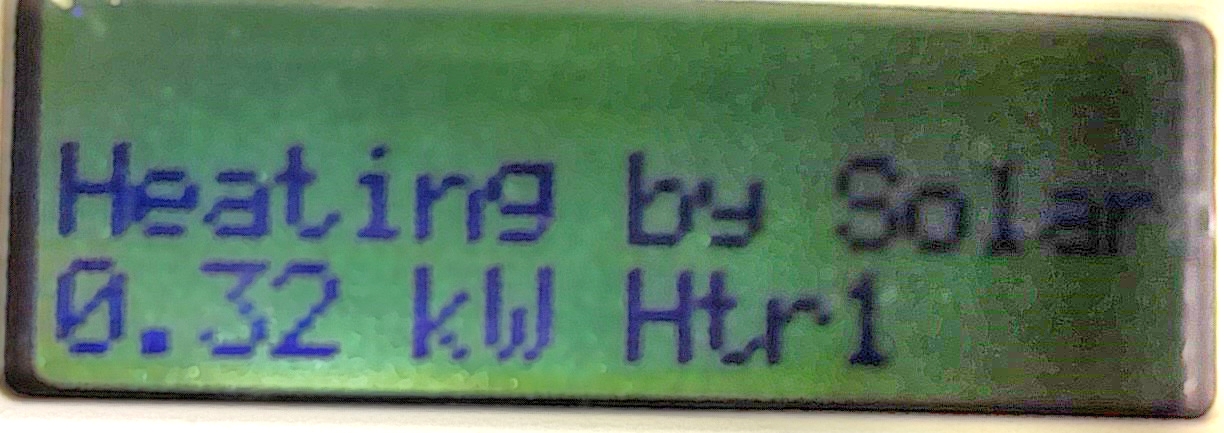

It can put far less that 3 kW into the water, Friday 15-09-2023 10-50 Morning can hear iboost photo of_tonemapped.jpgseen here with just 320 watts. The problem is my immersion heater is too short, so it only heats top bit of the tank, so looking at display all too often we get 1707223379025.png and still next day cold water until sun comes out, but heat with oil and it will stay hot 3 days. It can work with two immersion heaters, but we only have one.
