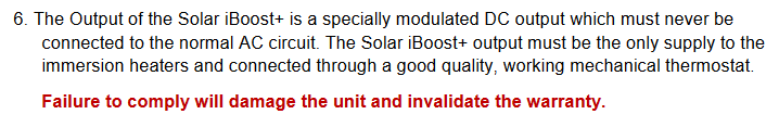

I expected it to work like a dimmer switch, I know it can reduce the current used so only uses excess power, it was only when reading the instruction I noted the reference to DC.
That's all I know, not a clue what 1B refers to, which is why I linked to the instructions from the start.
View attachment 332314 That's all I know, not a clue what 1B refers to, which is why I linked to the instructions from the start.
That would seem to move the goalposts quite a long way.
I don't know what "1B" is, either (and Mr Google doesn't seem to know, either), but if it's 'pulsed DC', with any sort or PWM, then a Type A RCD would presumably be adequate, the Type B only being needed to detect residual 'smooth DC' currents. Of course, all that still relies on the output being earth-reference - if not, no type of RCD would achieve anything.
Kind Regards, John

Is it? The instructions eric posted says:
"..... The Solar iBoost+ output must be the only supply to the immersion heaters ...."
... which I took to mean that the 'input' was only ever from the solar installation (probably DC), never from the grid. Did you interpret it differently?
I think that just means that you should not try and run a direct supply to the immersion heater bypassing the iboost.
The "general scheme layout" diagram in the installation instructions clearly shows that the "solar iboost" is supplied via the mains wiring. The wiring diagram also says the device should be supplied from a "16A MCB or 13A fused outlet". It's pretty clear this thing is intended to take it's power from the mains wiring, not directly from the solar panels.
A current clamp on the meter tail is used to determine when there is excess solar generation and that information is sent wirelessly to the iboost.

@plugwash ... OK, I've had a look at the installation manual (which is the best source I've so far found), and it seems to indicate that what you said is correct.
It's less sophisticated than I had thought. As you implied, it seems to simply use any 'spare' grid-synchronised output of the solar inverter to power the immersion - one consequence of which is, as eric has said,it will not work during a power cut.
That being the case, you're probably right that not only is the unit's output earth-referenced by virtue of its input but also that there is no input/output isolation of the non-earthed side. If that's the case then, as you said, a (Type A or 'above') RCD on the input side of the unit would see any faults downstream of the unit.
However, although it now seems that the above is true, if (as he has suggested) eric really feels the need to have RCD protection of the immersion then (assuming only that the output is earth-referenced), the surest way of achieving that is to have an RCD on the output of the unit -and, since it's pulsatile DC, a Type A RCD should be adequate for that.
Kind Regards, John
