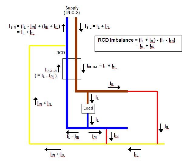

As for the TN-C-S situation I was thinking about throughout the early part of this discusion, I think the following diagram confirms that the fault currents again add (this time with current going the 'normal' direction through N sie of RCD):

I think that's correct John. Your diagram looks exactly like the one I had to draw on the back of an envelope!... which was when I realised that the direction (or phase) of the currents through the RCD was crucial.
But I think we're there now finally!

Yes, I think we probably really are 'there' now. Thanks. As for an exam question, I don't know about you, but it's clear that sparkticus and I (and probably others) would still have had our confused heads spinning when the 'finish' bell sounded!

Same here.It was only when I'd drawn both the TN-C-S and TN-S/TT diagrams, and 'noticed' that the directions of arrows at the RCD were different that I twigged.

Do you mean that you are not convinced by TN-S/TT diagram I posted to echoes last night? If so, what's the problem. As I wrote to echoes, I first thought that the diagram proved the opposite view, until I noticed that current was passing through the N side of the RCD the 'wrong' way. Hence, my 'imbalance current'of (IfL- IfN) should, if we are working with 'unsigned' numbers, really be written as (IfL- (- IfN)), aka (IfL+ IfN).

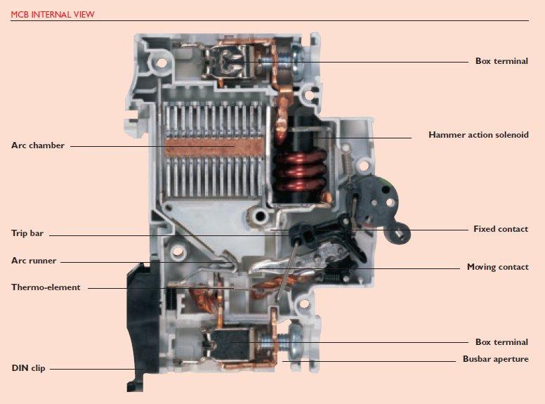

However, I'm still confused as to what all this electronics is about. As I said before, it looks as if there is a fairly standard electromagnetic 'RCD' mechanism in the top half of that casing, so why the need for electronics? I don't think that 'electromagnetic' bit can be anything to do with overcurrent functionality, since it's not present in a standard MCB (which looks very much like the bottom half of your RBCO):
